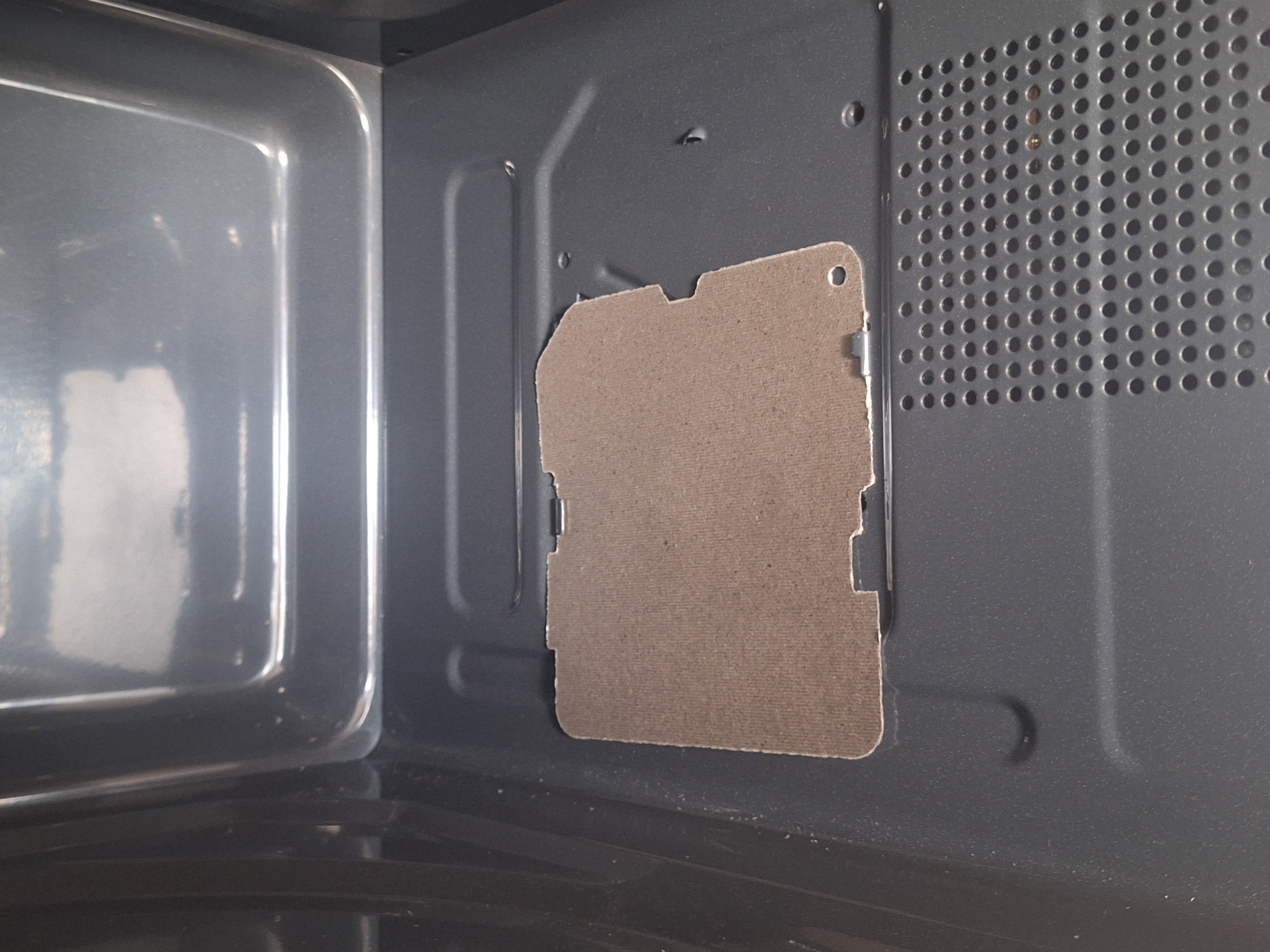

Mrs Y just bought a new microwave and it has this crappy metal plate inside. It's loose and a bit iffy.
The microwave upstairs also has a metal plate, but it looks like it was designed that way.
This new one looks like they found an old bit on the floor and just bunged it in.
Is it safe ?

It's a mica covered piece of card, meant to be there and perfectly safe, it's to stop moisture and food crap entering the magnetron wave guide.
Edit, it does look cheap n nasty, and maybe has slipped down a bit

There's a screw hole top right of the shield and a screw hole in the casing a bit further up. There's also what looks like a positioning lug too.
I'd say it should be slightly higher up and screwed in.

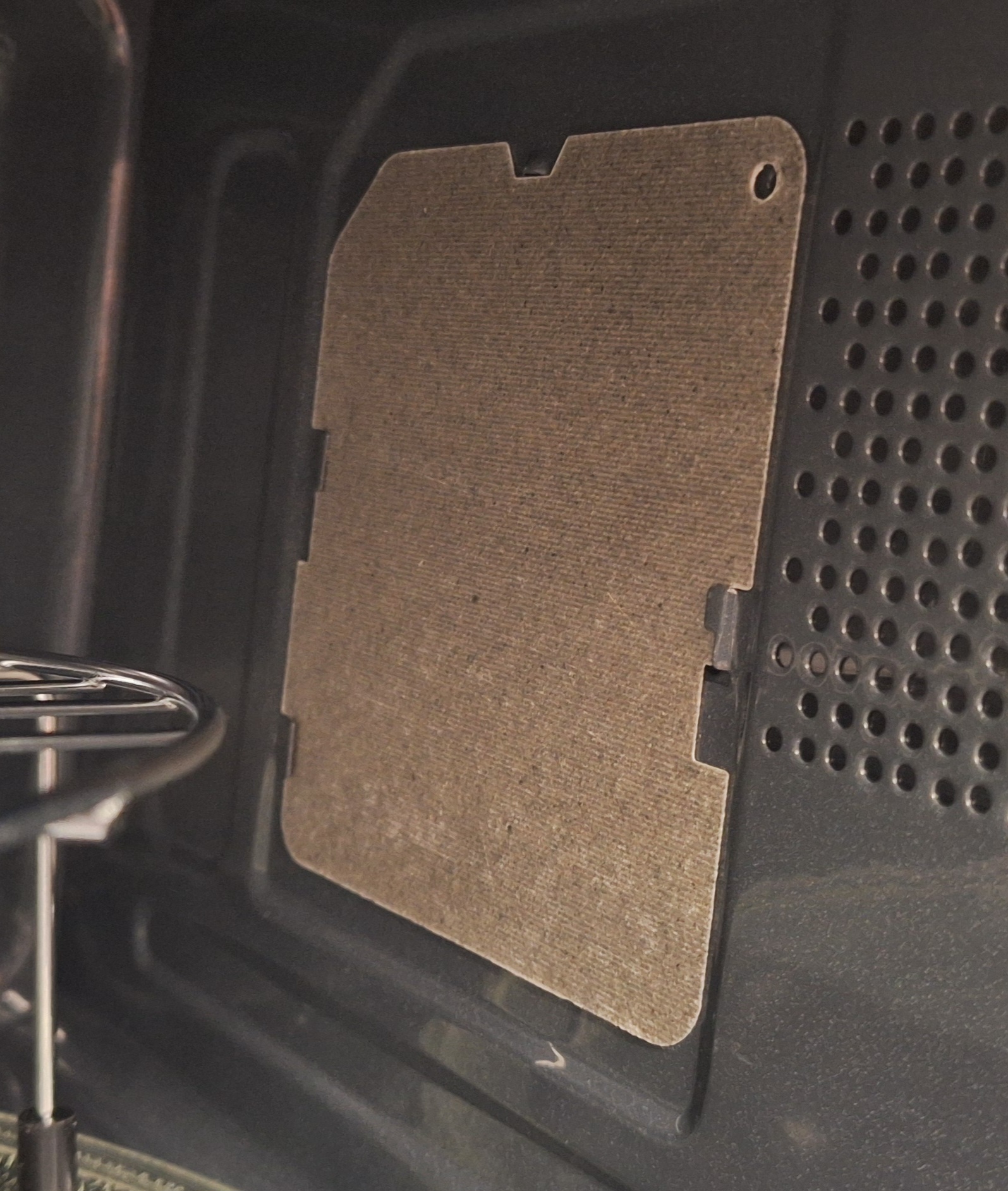

You can clearly see that it’s dropped from where it should be, and where the hole is for lining up for a screw plus locating tabs.

Had to nip into town so popped into the shop.
Seems it hasn't just slipped. It was fitted wrongly. Surely they must fit hundreds per day so know when it's wrong. Certainly looks wrong
