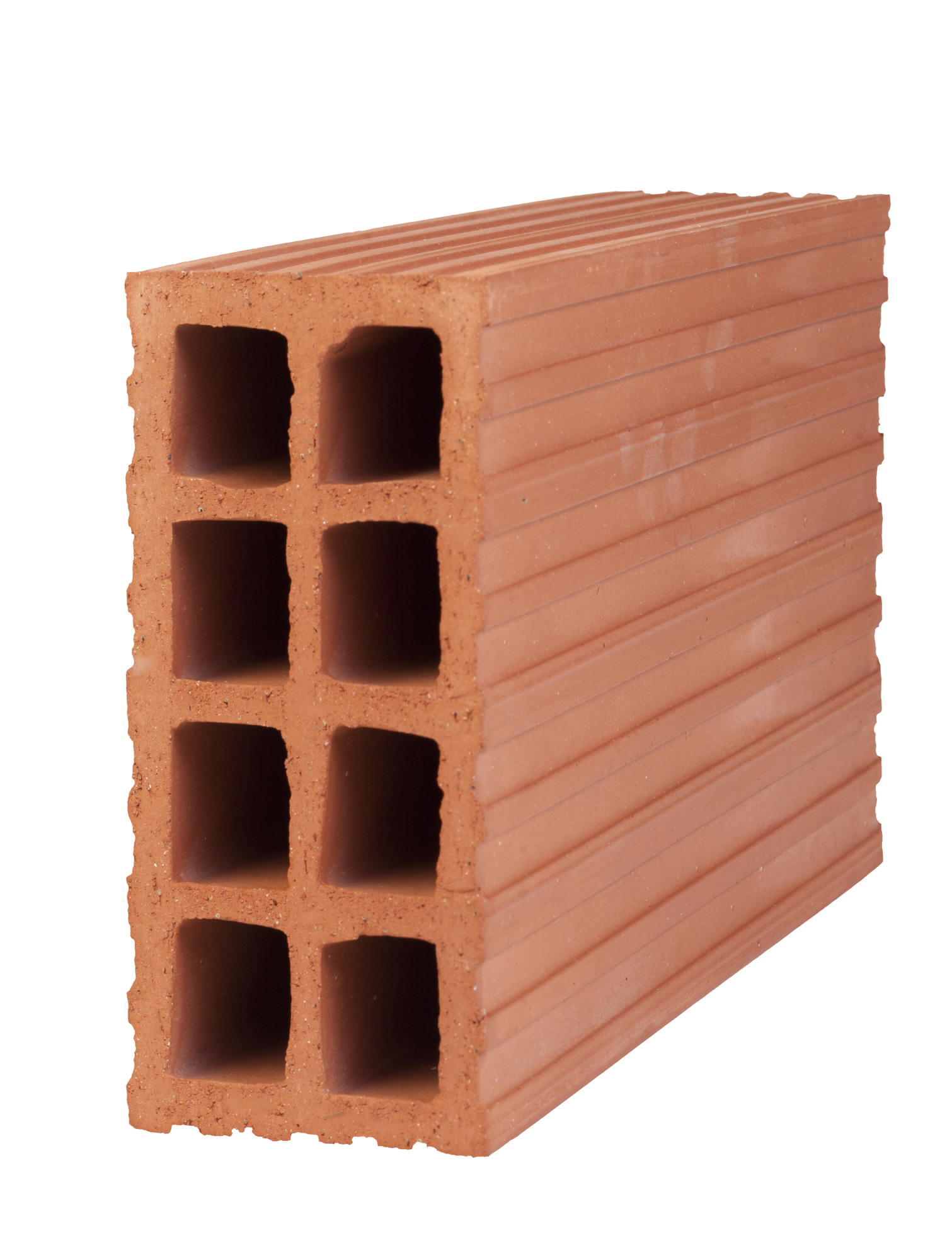

The wall is built from these, hence the difficulty in getting a fixing. The frame is still covered in foam which I'm gradually cleaning off.

I wouldn't try drilling into those blocks. If the foam worked before and you can get the same stuff I'd be foaming away like a foamy thing. (I'm a bit surprised it works though tbh - but some of the modern foams are really :thumbup: )

Those bricks are everywhere in Spain/France and I've drilled into them and fixed plugs into them no end of times. They may look like they disintegrate when faced with a drill bit, but they don't. You do need to use a wall plug that deforms into a knot in the cavity (same as plasterboard fixings). Fischer generally make the best - their 'UX' range are great. I'd fix two or three decent duty screws each side then foam away to your heart's content. I've not met any foam that's good enough for a permanent fixing.

For those is Europe, if you're drilling into those blocks the secret is to use a ceramic tile drill and don't use a hammer drill.
Those blocks are end on for me so I think r1's suggestion of filling them with cement and fixing to that is a good one. They don't appear to sell pointing guns here, no surprise as everything is built as rough as fuck the covered in monocot to make it look nice. There is little too no brickwork. I'll do a trawl of the hardware shops next week.
