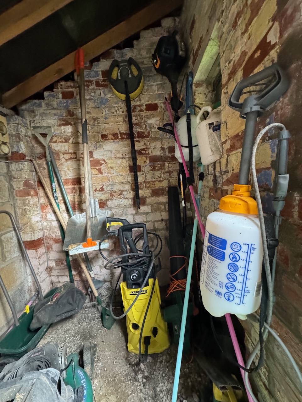

Current photos:

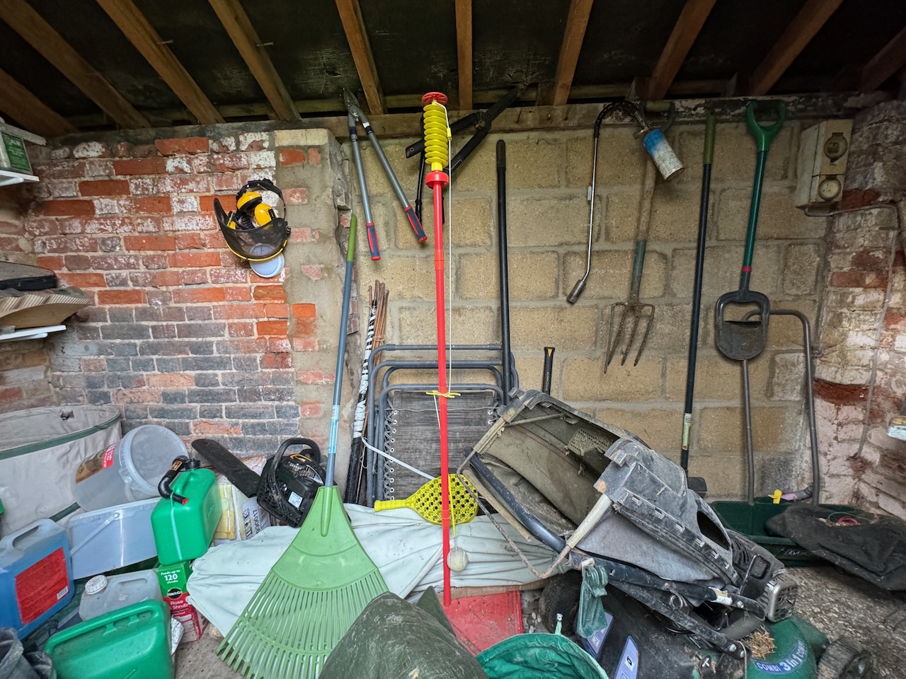

Current:

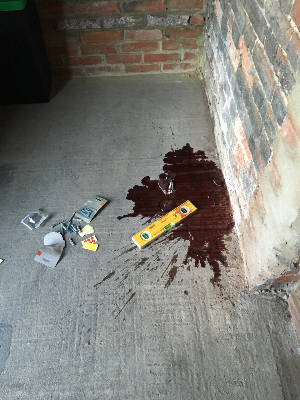

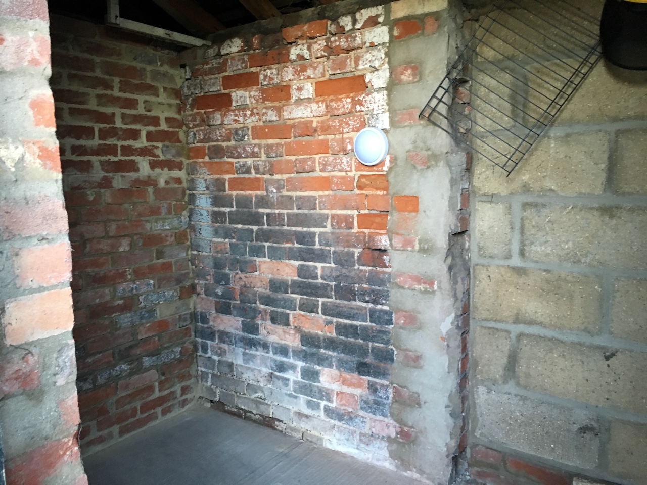

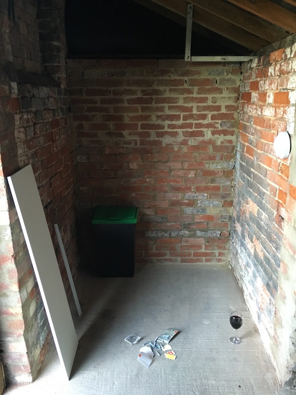

What I managed to do 8 years ago:

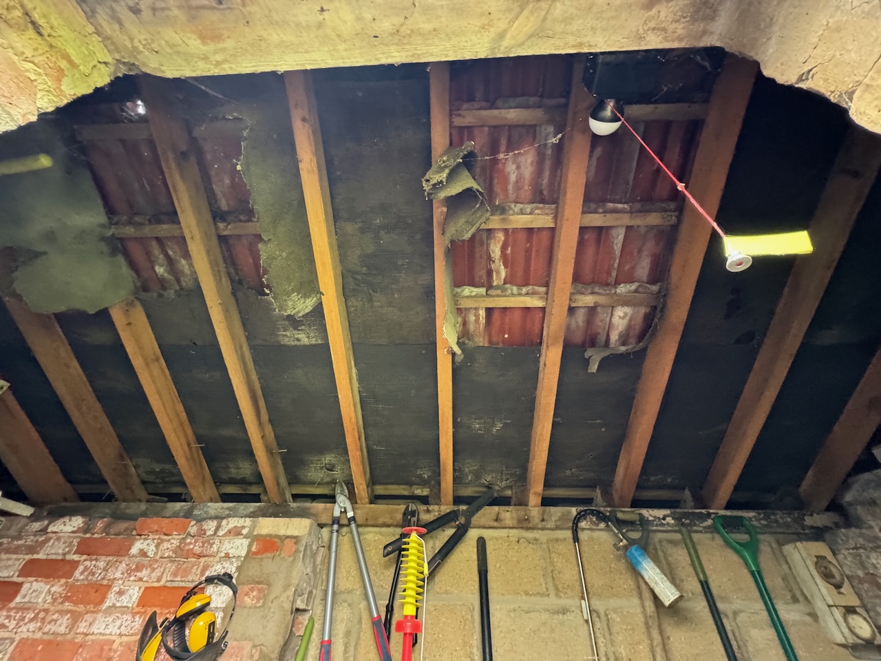

My main concern would be why would the roofing felt be falling off? (I always start at the top :D because the first thing is to make sure it stays dry).
As others have suggested, run an extension cable from the existing socket, put another outdoor socket pair on it if you feel inclined. I'd probably just put a 4-way screwed to the wall myself. Stick an LED 'fluorescent' baton light up and put an in-line switch on it.
Lick of sealant/paint, get those shelves sorted and you'll soon have it looking like a little palace. :thumbup:

Count Steer wrote: Fri Apr 26, 2024 3:18 pm My main concern would be why would the roofing felt be falling off?
I guess just age. No idea how old the shed thing is, but the rest of the house is 150, so it's bound to be old enough to start perishing.

On closer inspection it doesn't look like roofing felt - it appears to be fixed to the underside of the battens? So some Tyvek type membrane stapled to the woodwork will breathe and keep dust etc out. (Once again, Screwfix can provide - they have Cromar brand triple layer - but most builders merchants should have something). However there are different sorts and I'd go for the more medium weight than the heavier duty stiffer stuff if poss as it'll be easier to handle. A powered stapler would be :thumbup: too.

ChrisW wrote: Fri Apr 26, 2024 5:59 pm I like the celebratory glass of red!
It was a working glass :)
Though a terrible accident befell it...

Err...is that a wriggly tin roof I spy? That'd explain why the felt isn't under the tiles...there aren't any tiles. :lol:

Slenver wrote: Fri Apr 26, 2024 6:30 pm
Nooooo!!!!
It looks like the end of Red Dragon...
Yup. It's level. :(
