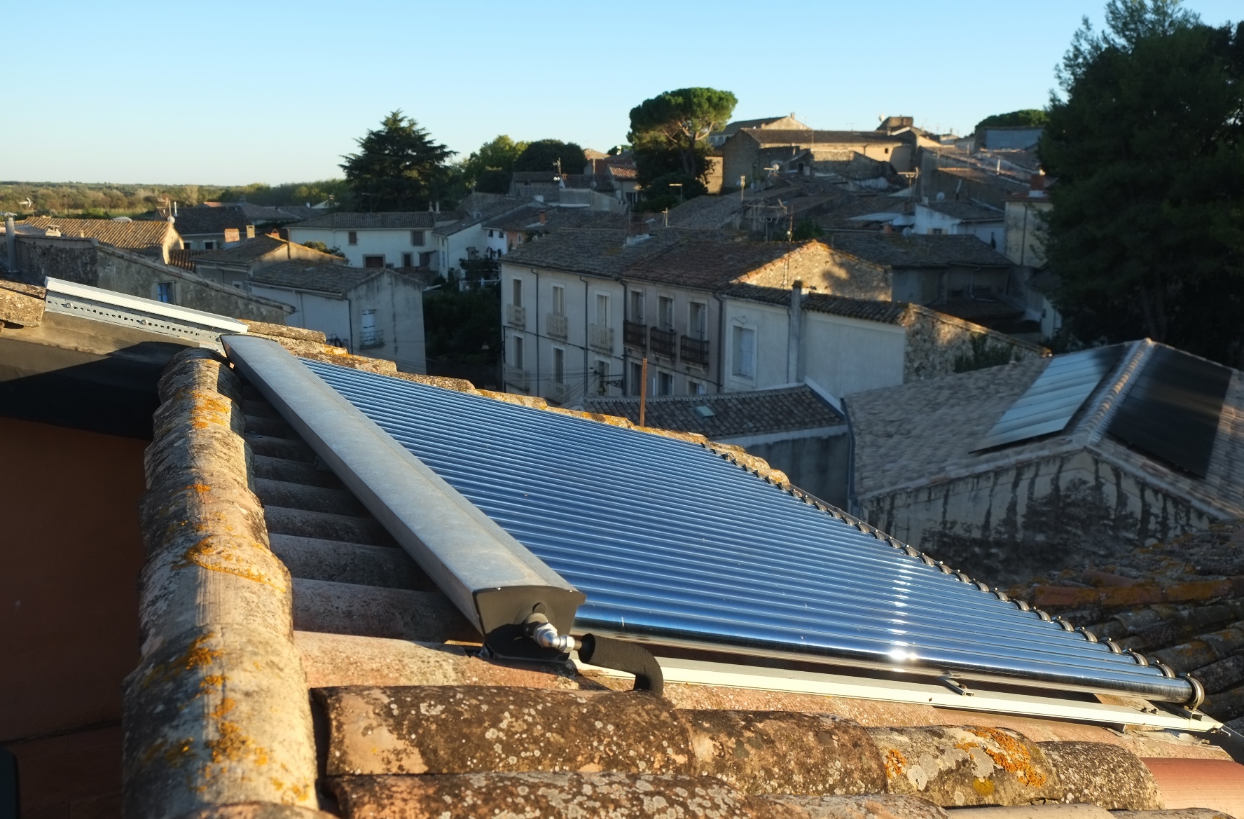

These are the bits on the rooftop (solar panel is small unit to the left).

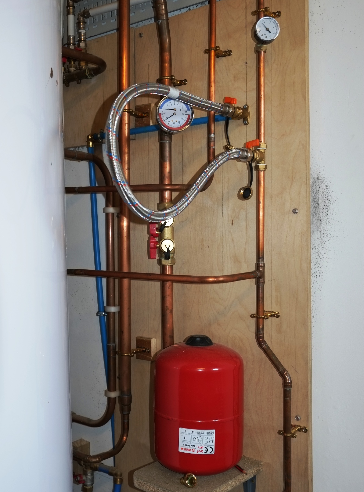

And this is the bit where the spaghetti unravels. Pressure gauge for the solar thermal is not the big blue and red one, but the one at the top.
