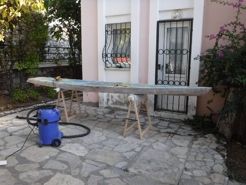

I started work on the first paddle board (the one I think needs the most work) on Monday.
These boards have had a fairly hard life and have been in use every summer for 6 seasons now and have been used considerably more than your average board. They reside down at Oba Restaurant where Sunshine (his real name, he changed it from Mustafa a few years ago) rents them out to tourists and makes a bit of pocket money. The one I'm working on is his and mine I suppose. When I was makining the boards he wanted to buy this one off me but I refused to sell it to him as it has a slight twist in it. But it's his as I rarely use it.
The other two boards belong to Steve, a friend and I made them in his basement. He wanted them for his two kids but one of them is now in Oz and the other in a stable relationship so doesn't come out here so much. He's happy they're being used and like me, won't take any money off Sunshine. We maybe get a beer now and again. :D

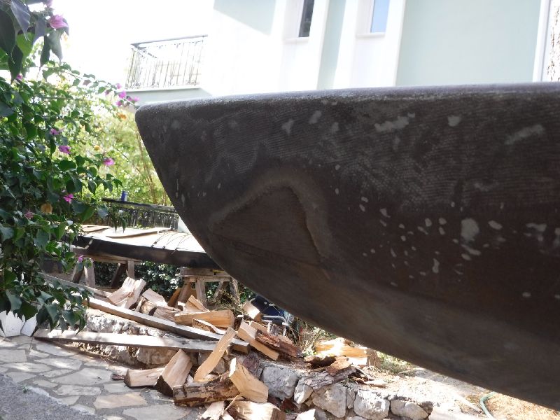

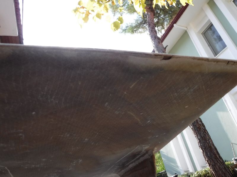

The boards have held up very well which has got to be testament to a good design and lots of epoxy. There's some seam splitting on the deck/hull joint and the bow section needs quite a bit of work (on all 3 boards) as despite telling every fecker that uses them to come in parallel to the beach and step off and not drive them straight onto the stony beach they still do just that. Anyway, here's the first board:

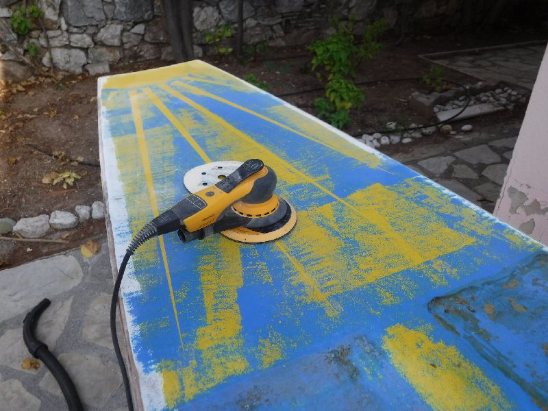

The hull and sides have been sanded and it's time to tackle the top.
You can see there's a bit to do on the bow, cut away more fibreglass and rebuild it a bit but it's not difficult and I did the same with my kayak a couple of years ago. It'll be good for a few more years.
