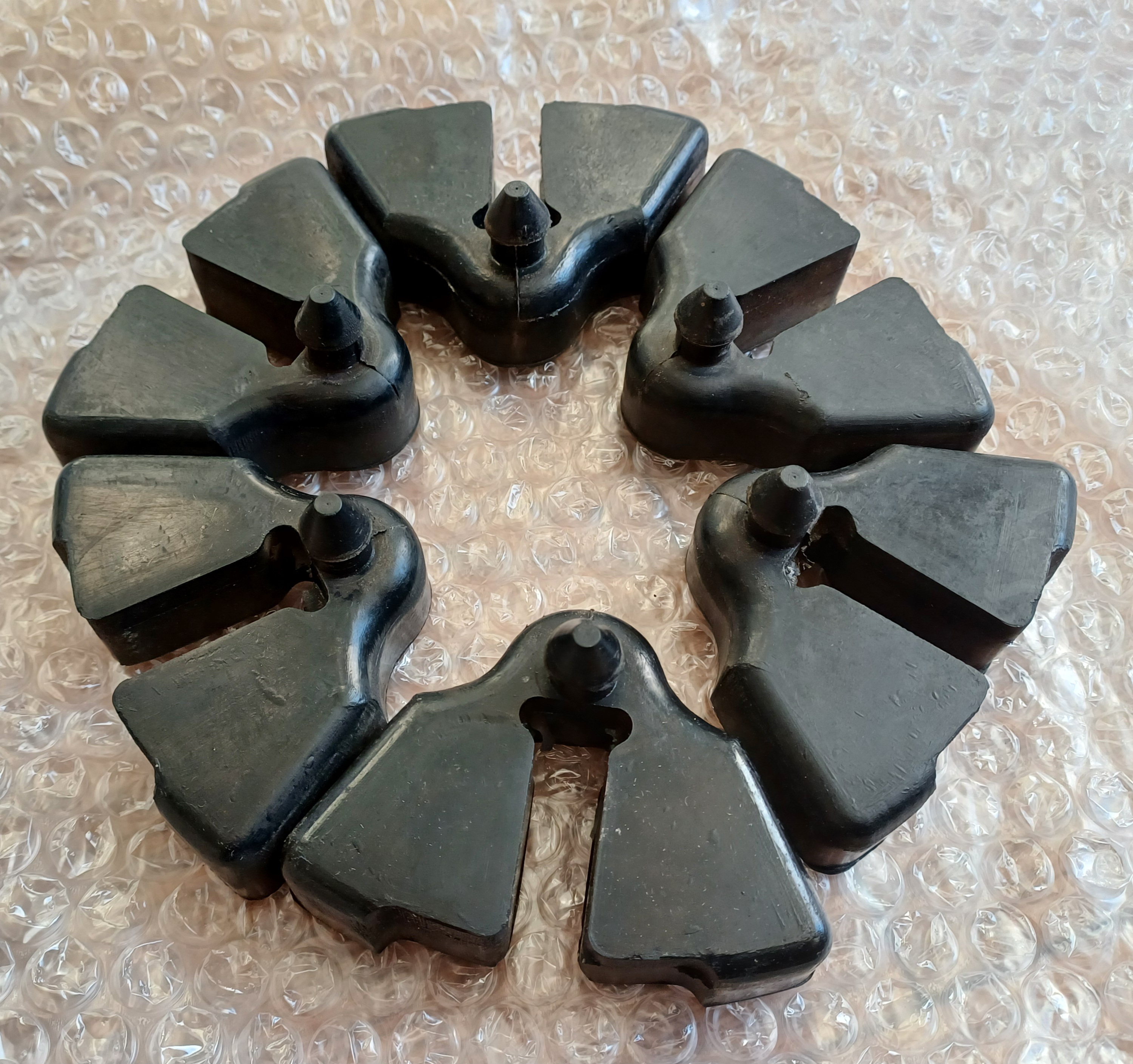

One of the joys of one make clubs is,there are folk with mountains of accumulated spares. Lots of stuff unobainium even repro. I got these new old stock genuine cush drive rubbers today. The shimmed ones will do for now and these will do for back up.
H1a part 2 - Imgur (6).jpg (1.77 MiB) Viewed 351 times
Small wins rock. 8-)

Keeping a bike long enough to need a Cush rubber change?? :crazy: :eh: :think:
Re: Kawasaki H1 1971
Taipan wrote: Wed Jan 17, 2024 8:16 pm Keeping a bike long enough to need a Cush rubber change?? :crazy: :eh: :think:
Right on past a full tank of juice,eh? Unheard of in Tinpan world. :lol:
Incidentally,a mate had a BMW S1000RR Wull type demo bike on loan with 600 miles and the cush rubbers were shot. Probably from the running in process. :silent:
