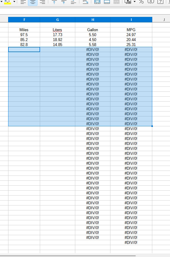

Made a basic MPG calculator for my piss poor van, as i am noting what changed i made, parts bought until it improved. When i drag the formula down the cells i get this text. How to a get rid of it as the bottom of last row i have an average formula what will not show with them being there.

=IFERROR(B1/A1,"")
Replace B1/A1 with your original formula. Anything you put in the speech marks will appear as text, in the instance above it will be a blank cell.
You could, for example, put "No Value" and it will return No Value instead of #div/0

Most excellent. Worked a treat, thank you very much :thumbup:

This is really just a temp thing. My van has issues as you can see its giving around 25MPG. I just want to keep tabs on how the mpg is while i start a process of illuminations by changing parts. Crazy thing was i got 34mpg the first 100 miles after my remap but now its back down so 25. About to go and change the air and fuel filter before spending money on injectors.

How are you doing the maths? So for example in Row 1 you've got 5.5 Gallons and 17.73 litres, but those numbers don't "fit". In UK gallons 17.73 litres is ~3.9 gallons.
You've also got 97.5 miles and 5.5 gallons adding up to be 24.97mpg, whereas (assuming those two numbers are the ones you want) it's actually 17.27mpg.
I can't see the rest of the sheet though, so I don't know how the maths are working. I think you might actually have the correct mpg calc (97.5 miles and 17.73 litres would actually be ~25mpg as stated). Dunno, just curious how the maths work really :D

Miles divided by litres gives gallons multiply by 4.54 gives mpg no?????

Err...yeah I think so :D It's just a slightly odd order of calculation! Works out the same in the end though, hence why your last column is the number I'd expect.
The column you've labelled "gallon" is actually miles per litre, then you've multiplied by liters/gallon (i.e. there are 4.54 litres in a gallon) to get mpg.
All comes out in the wash though, tis the same maths in the end and only a nerd would worry about it. Hence my interest :D

So it is :lol: this is the formula =SUM(D5/E5) This is what i have for the MPG =SUM(F5*4.54)

Common way of avoiding empty cells is to test for a blank ( or other value ) and make the result blank in that case
e.g.
=IF(A1="","",(A1+B1) )
A1+B1 is the result if A1 in NOT blank otherwise the result is blank. When you propagate this by dragging down the entire column the cell references increment as you would expect. The first argument [ A1="" ]could be any logical test or expression.

There's a specific command in Excel for checking blankness, or lack thereof. The highly originally named ISBLANK(). Returns TRUE and FALSE.
So you could do =IF(ISBLANK(A1),"put some numbers in here you numpty",A1+B1).
