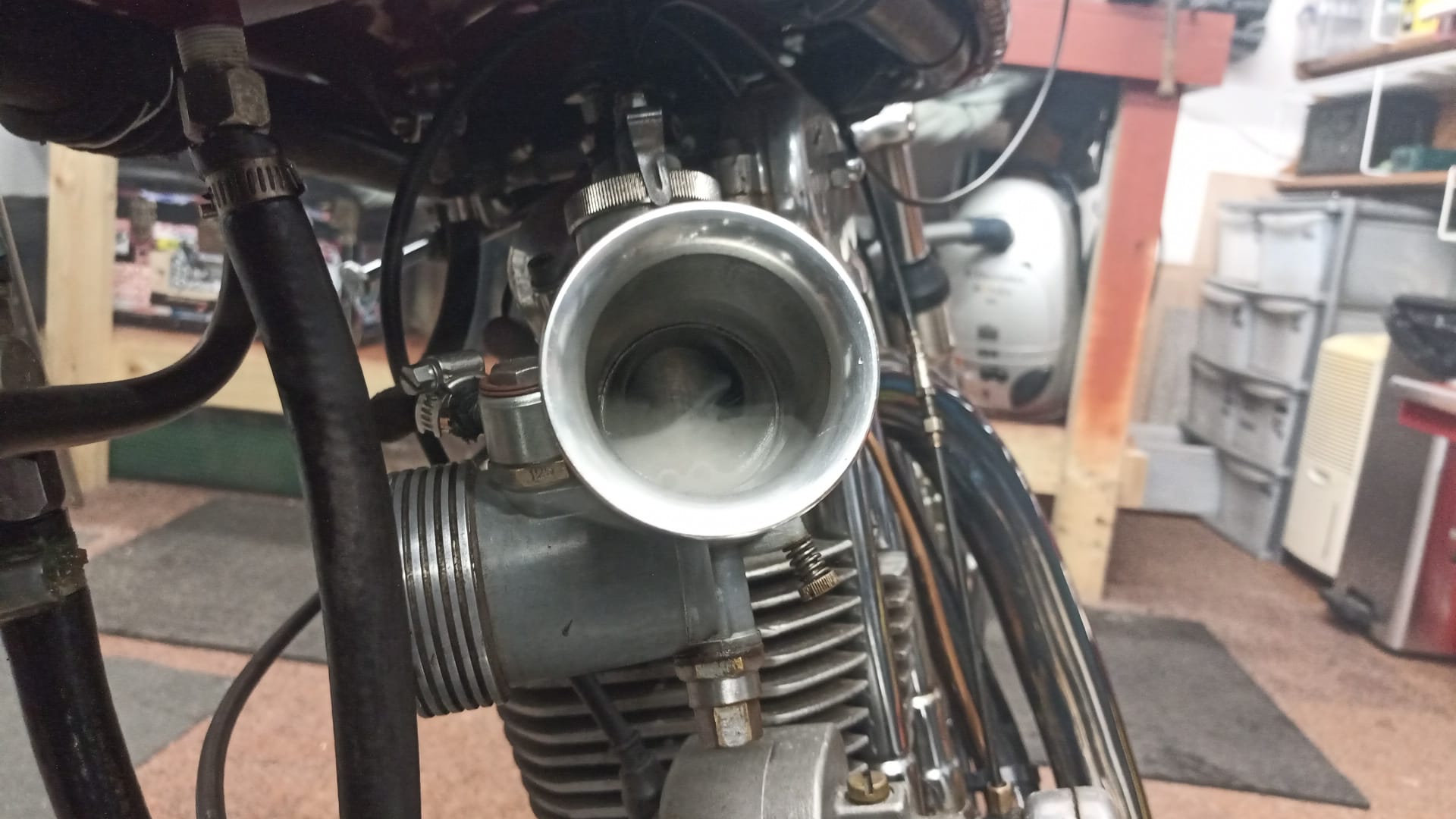

I figured the carb probably needed a clean... And i wasn't wrong.
It wasn't terrible, but it needed a clean....
Hopefully this will make a difference when i try running it again!

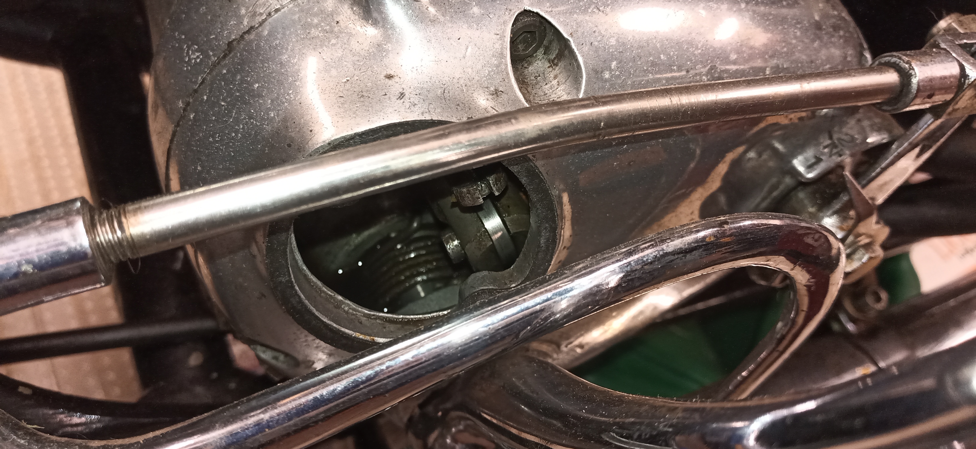

Gearbox could use some oil.....
Fecking thread in the lower cap hole de-threaded itself too. Gah!

Got a 2BA helicoil kit from RGMNorton and fixed the gear-box inspection plate thread. Stuffed a bit of foam in there to catch all the swarf and it did a good job. :)
I've a nasty feeling the helicoil may have turned itself a bit too far, but I'll keep an eye on it and pull it out if needed and replace the coil (the kit comes with 10 of the little blighters).
