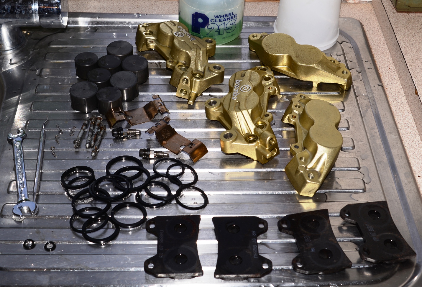

While the cat's away the mice will play...
Made a start on the Brembo Goldlines I removed from the Falco way back when. These had been sitting unloved down in the cellar for at least a decade, so I was very pleased with the way they scrubbed up. Lots of elbow grease, green Scotchbrite, P21S cleaner and a stainless farkling tool got these parts the way you see them.
I reckon they're © Weeksyclean... :thumbup:
After a lifetime of finding my fly encrusted visor wrapped in kitchen roll,or various bike parts on the drainer,Mrs.Skub had a sink fitted in the garage.
