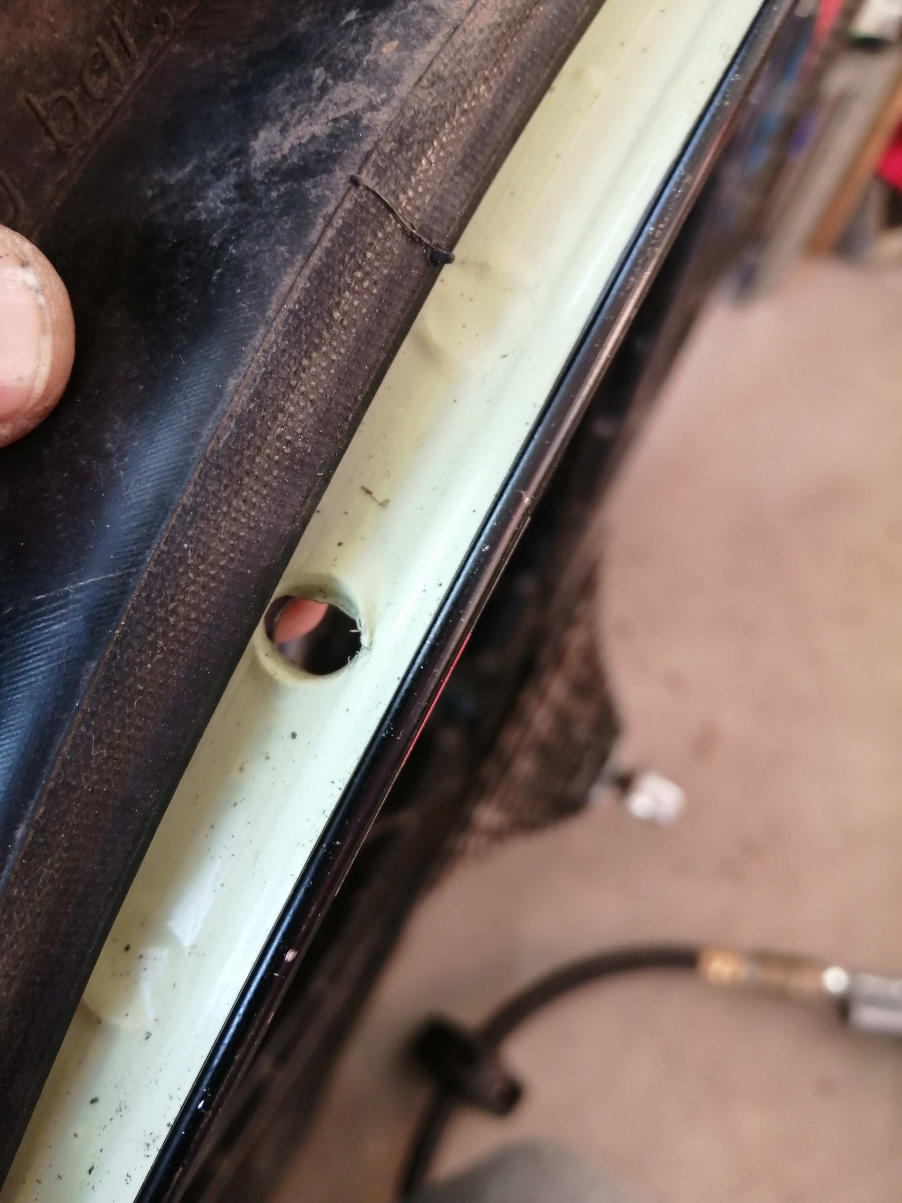

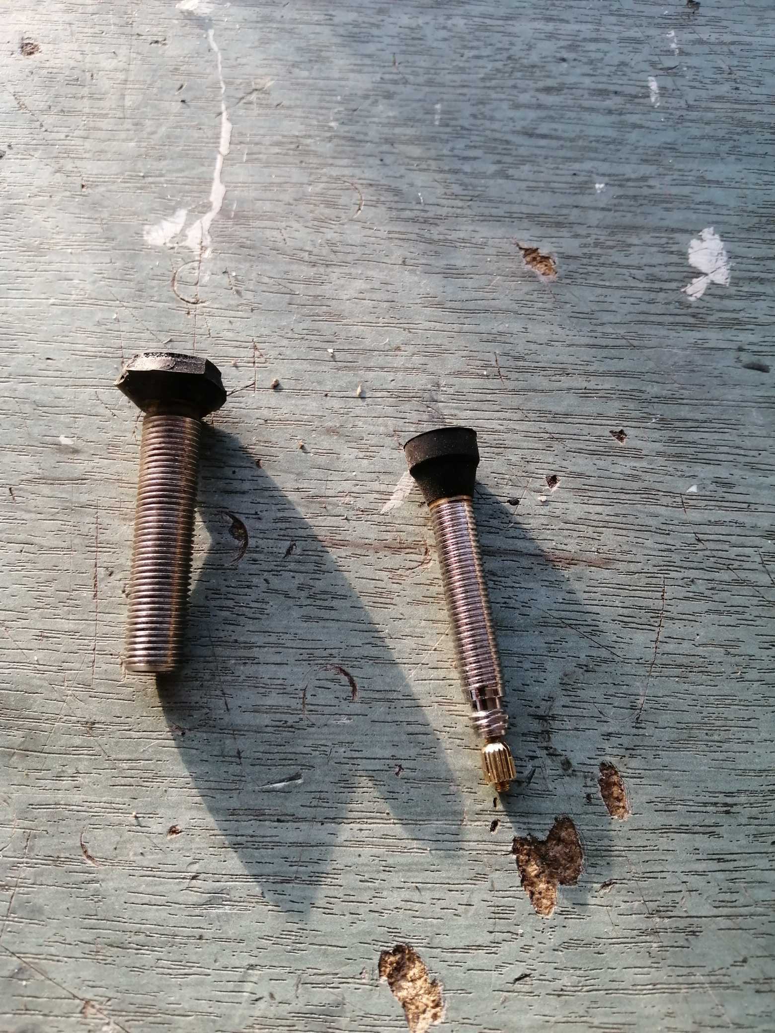

Not sure what I'm doing wrong.
I bought a tubeless kit for the MTB from Halfords and used the Stans tape to seal the rims. The tyres are tubeless Maxxis.
Just can't get the presta valves to seal on the rim, air rushes past them.
Tried hand tight on the locking screw and progressively tightening but no joy.
Also tried making my own valve using an old inner tube (youtube tip...).
Any ideas? Ta
Any ideas? Ta

Re: Tubeless tyres for MTB
Pic
- IMG_20200920_174227_compress3.jpg (406.1 KiB) Viewed 1361 times
Pic
- IMG_20200920_174203_compress47.jpg (422.22 KiB) Viewed 1361 times
That schraeder Valve fits through the hole?
Presta valves are a lot narrower.
The presta isn't a tight fit?
The wheel originally had schraeder tubes so the holes are wide enough for them.
The MTB kit I bought only came with presta
There's your answer. Holes too big. Ain't gonna workTarmacsurfer wrote: Mon Sep 21, 2020 9:11 pm The wheel originally had schraeder tubes so the holes are wide enough for them.
The MTB kit I bought only came with presta![]()
Not all wheels can go tubeless
