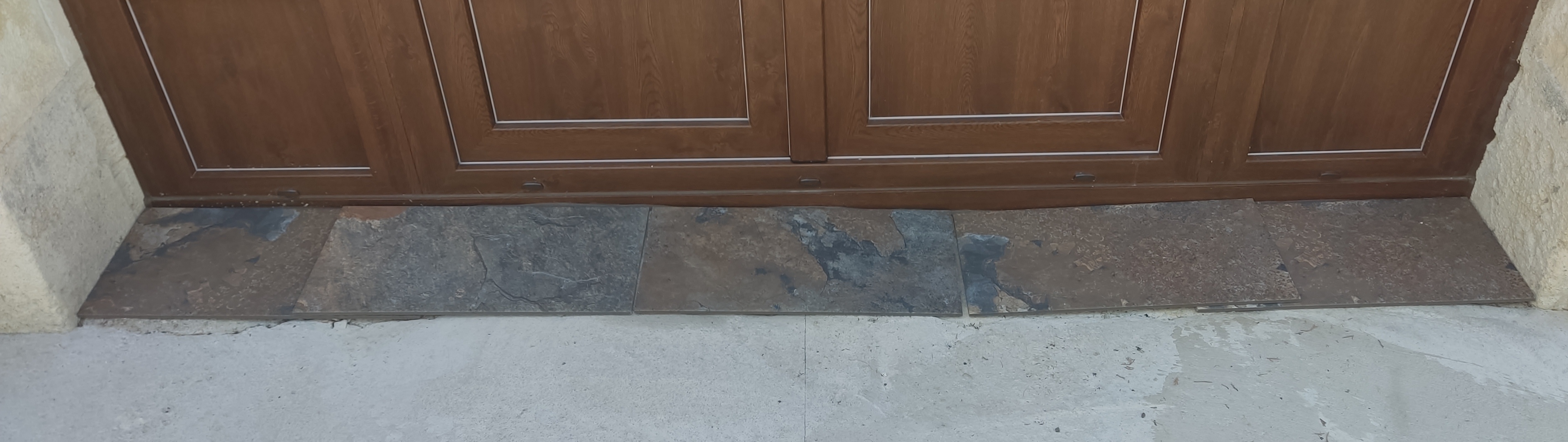

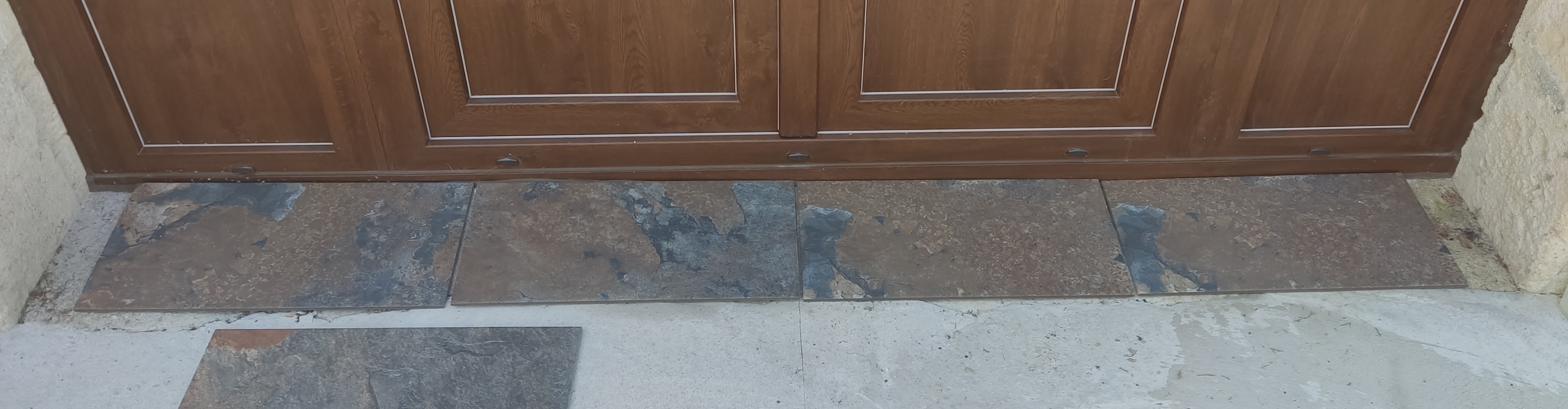

Got a large (9.5m²) bit of floor tiling to do.
Which way do you think would be the better way to start?
Astride the door centres or either side?
Yeah, I know it's not level too!

Personally I think door centres, but absolutely you will be the only one who notices or cares.

I'd go for the top one, the first tile centred on the centre line.
Are you laying them with straight or staggered joints?

cheb wrote: Mon Jul 08, 2024 3:11 pm I'd go for the top one, the first tile centred on the centre line.
Staggered

personally prefer bottom solution, as it's only 1 tile to be cut, and we only open 1 door to enter/exit, so would have a complete tile to step on, rather than a grouted joint.

If you're staggering the joints then I'd agree, a solid tile to step on to.

I’d go with the bottom option, that way you aren’t left with skinny infill tiles at the edges.
You should design your layout around the centre of the room to ensure decent sized cuts around the entire perimeter and ideally a whole tile in the centre of the doorway, but you should always start laying at the highest point of a floor.

Top definitely. Skinny strips at the edges look gash and may give bother working loose eventually.

Silly Car wrote: Mon Jul 08, 2024 9:11 pm You should design your layout around the centre of the room to ensure decent sized cuts around the entire perimeter and ideally a whole tile in the centre of the doorway, but you should always start laying at the highest point of a floor.
It's not a room, it's between the lane and the front door

How about a pic showing the entire area to be tiled?
