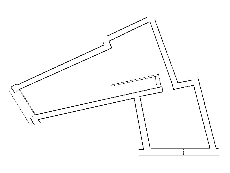

Just to completely confuse you, I'll show you the floor plan. You will immediately notice that there are no right-angles anywhere in the house(s). The house is actually two old dwellings joined at the hip. What you cant see is the elevation change - from right to left the street climbs very steeply and goes round a bend. So ground floor level on the 'cheese wedge' house is approximately level with the first floor on the 'not square at all' house. How someone figured that out I have no idea. There is a floor level mismatch of about 18 inches between the two houses.
A picture is worth a thousand words...

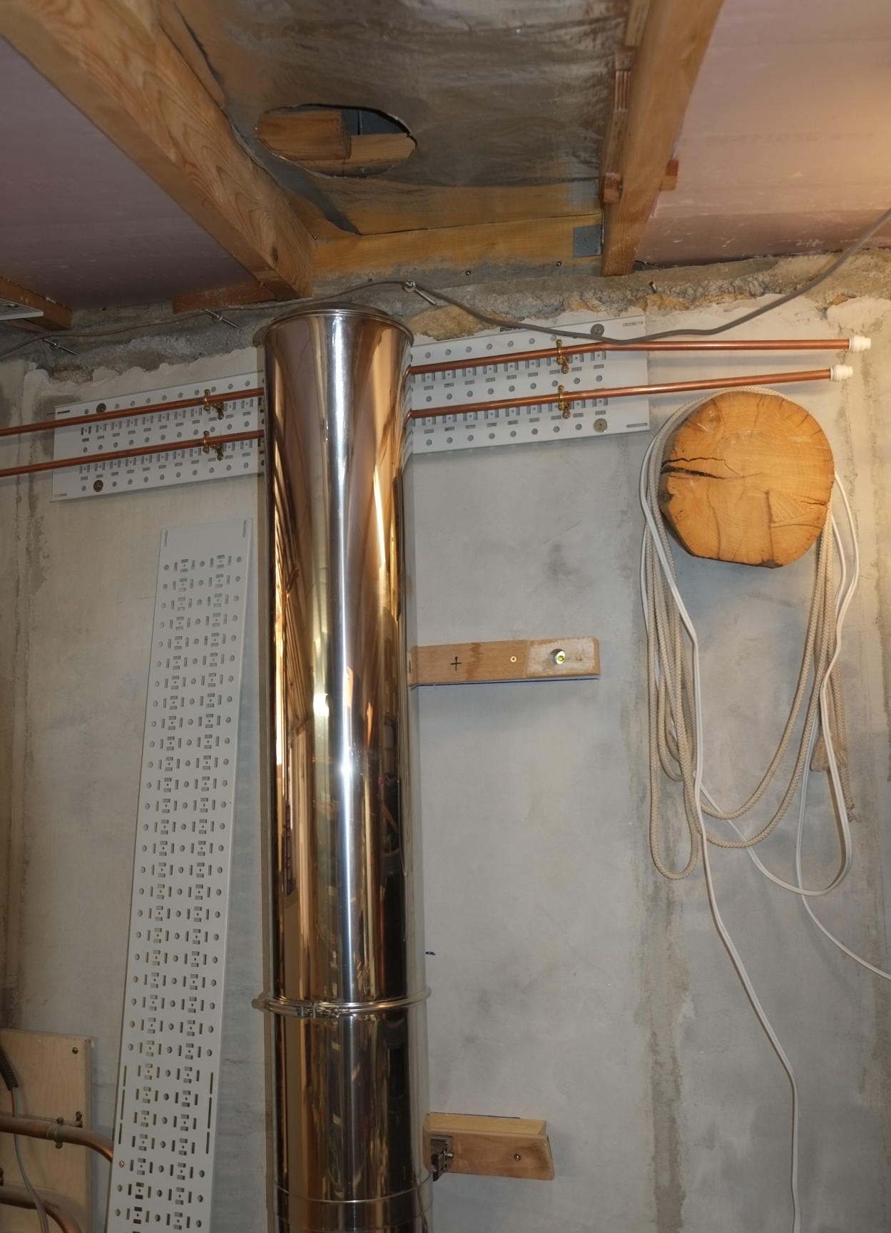

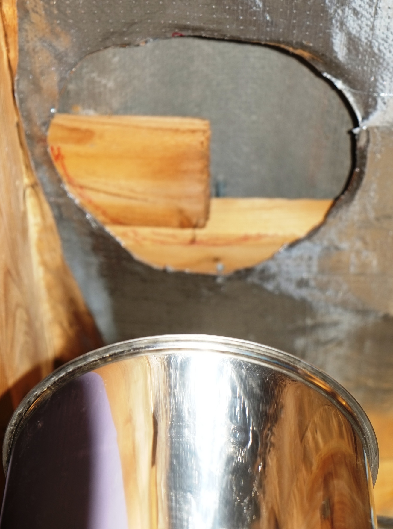

Anyway, today has been working in the attic, which is level 3 in the cheese wedge side. Level 1 is the garage and level 2 is the living room/kitchen. The living room has a wood burning stove fitted, and I'm currently trying to finish off the flue. As you can see from the pic below, it currently terminates below the roof, which is not ideal.
At some point I need to cut a hole in the roof panels but before I can do that there is the small question of some of the roof panel support beams which are in the way. As far as I can see I won't be affecting the integrity of the roof beams, but it's going to be a PITA of a job, involving a multitool (the tool that sounds like a thousand angry wasps) and a fair amount of sawdust in eyes, And balancing on a ladder. This is a close up of the offending beams it's a bit out of focus, but I've scrawled on the beams in red pen where they will need to be cut back.

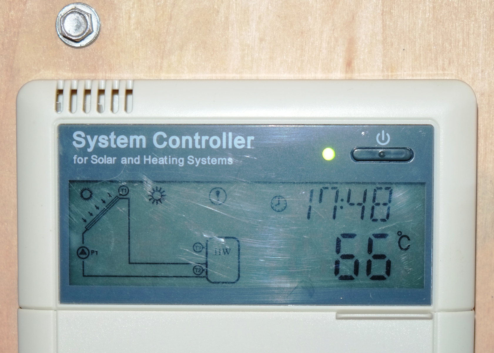

And lastly, as the day has been scorchio the solar-fed hot water cylinder has registered a new high - 66 degrees no less.

I assume that's twinwall stovepipe? Is it allowed that close to timber?

mangocrazy wrote: Sat Apr 13, 2024 3:35 pm Just to completely confuse you, I'll show you the floor plan.
My place is similar, half our house and garden is behind the neighbours place. Every single room is on a different level, no room is square, most walls are sort of vertical. Installing a kitchen entailed building a vertical wall first, it was easier that way.

DefTrap wrote: Sat Apr 13, 2024 5:45 pm I assume that's twinwall stovepipe? Is it allowed that close to timber?
Yes, twin wall insulated. As long as there's no direct contact I believe it's OK. Trying to keep everything away from timber has been a PITA. It may not look like it, but there is at least 50mm between the twinwall pipe and the joists. I'll also be cutting the support beams back to give similar clearance.

by mangocrazy
DefTrap wrote: Sat Apr 13, 2024 5:50 pm
Putting a kitchen in was fun. I had to do almost a freehand cut on the worktop to get it to line up. We do have the benefit of a beam and block floor for the 1st floor living room. That helped a lot.

mangocrazy wrote: Sat Apr 13, 2024 6:59 pm
Yes it's worth keeping an eye on, taking advice and safety first. A neighbour had a stove fitted (by an approved fitter) close to a roof beam. Said it would be fine - burnt his kitchen out!

DefTrap wrote: Sat Apr 13, 2024 7:18 pm
Shit - really don't need or want that. Was that with single or twin wall flue? I can see large amounts of Rockwool insulation being stuffed into every aperture...

mangocrazy wrote: Sat Apr 13, 2024 7:23 pm
It's too long ago now for me to remember the details (and I only saw the aftermath) but it was a bit concerning that the approved stove fitter did it. :(
All my installations have been in stone so far. And I've moved to pellet stoves now anyway and those flues are both smaller and seem to run a lot cooler.

by mangocrazy
I;ve got a number of sheets of foil-backed Rockwool that I'll be placing between the flue and any woodwork, so that should keep temperatures within acceptable levels. But I'll certainly be asking a few questions of the flue suppliers.
