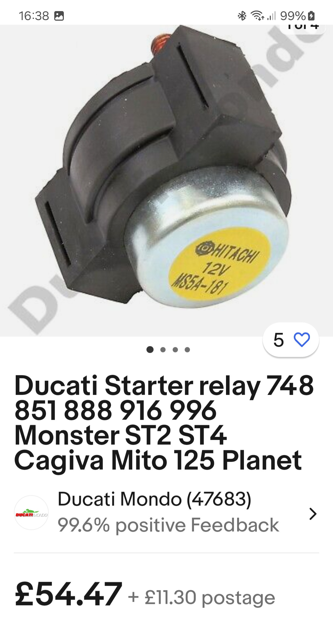

- Posts: 951
- Has thanked: 85 times
- Been thanked: 687 times
Re: Ducati ST4 Starting Problem
Iirc, wasnt the TDM900 relay the cure for many aprilia starting woes. I know we did that on my mates mille and he stopped eating batteries after that.mangocrazy wrote: ↑Fri Apr 12, 2024 4:03 pm This is the guy I was thinking of - he does high capacity starter cable kits for just about all the more popular Italian models:
https://www.ducati.tech/shop/Exact-Star ... c155257294
I'm pretty sure he supplied a kit for my Falco which dramatically improved the starting, and the bike was only a couple of years old when I fitted them. Your mate might need to email/PM him to see which kit is suitable for the ST4.
