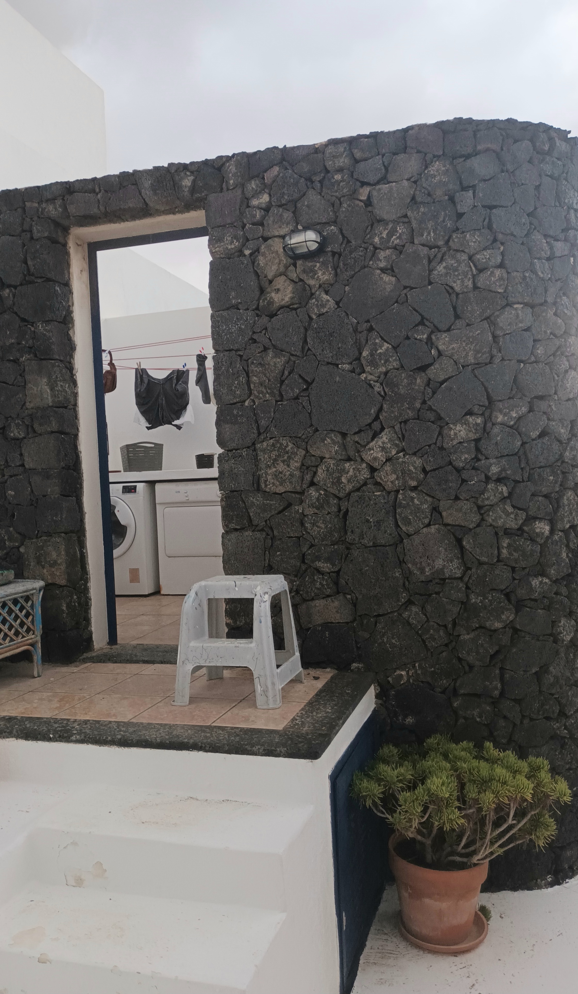

Often I need to drill into volcanic rock like this wall light I just tried to install.
The 18v Makita barely made a scratch..

If I was drilling into that stuff I'd start with a really small masonry bit - about 4mm. That wil go through hard material quickly and then you follow up with the actual size drill/hole you want. A small drill bit means the drilling force is concentrated into a small area rather than being dissipated over a wider area. Then when you follow up with the larger bit it has a pilot hole to follow. You get a more accurately sized hole with less chance of the drill bit wandering.
Re: Recommend Me A Drill
Posted: Fri Feb 10, 2023 7:20 pm
mangocrazy wrote: Fri Feb 10, 2023 7:17 pm If I was drilling into that stuff I'd start with a really small masonry bit - about 4mm. That wil go through hard material quickly and then you follow up with the actual size drill/hole you want. A small drill bit means the drilling force is concentrated into a small area rather than being dissipated over a wider area. Then when you follow up with the larger bit it has a pilot hole to follow. You get a more accurately sized hole with less chance of the drill bit wandering.
I had 4mm drill bit. Volcanic rock is tough :D

Yeah, I absolutely get that. In our place in France some of the rocks that make up the (half a metre thick) walls are granite or a very close relative.
Buy lots of good quality 4mm drills! :D

Those kecks in the door way need gone.....
Posted: Fri Feb 10, 2023 7:59 pm
David wrote: Fri Feb 10, 2023 7:55 pm Those kecks in the door way need gone.....
My spare pair of work shorts :D
