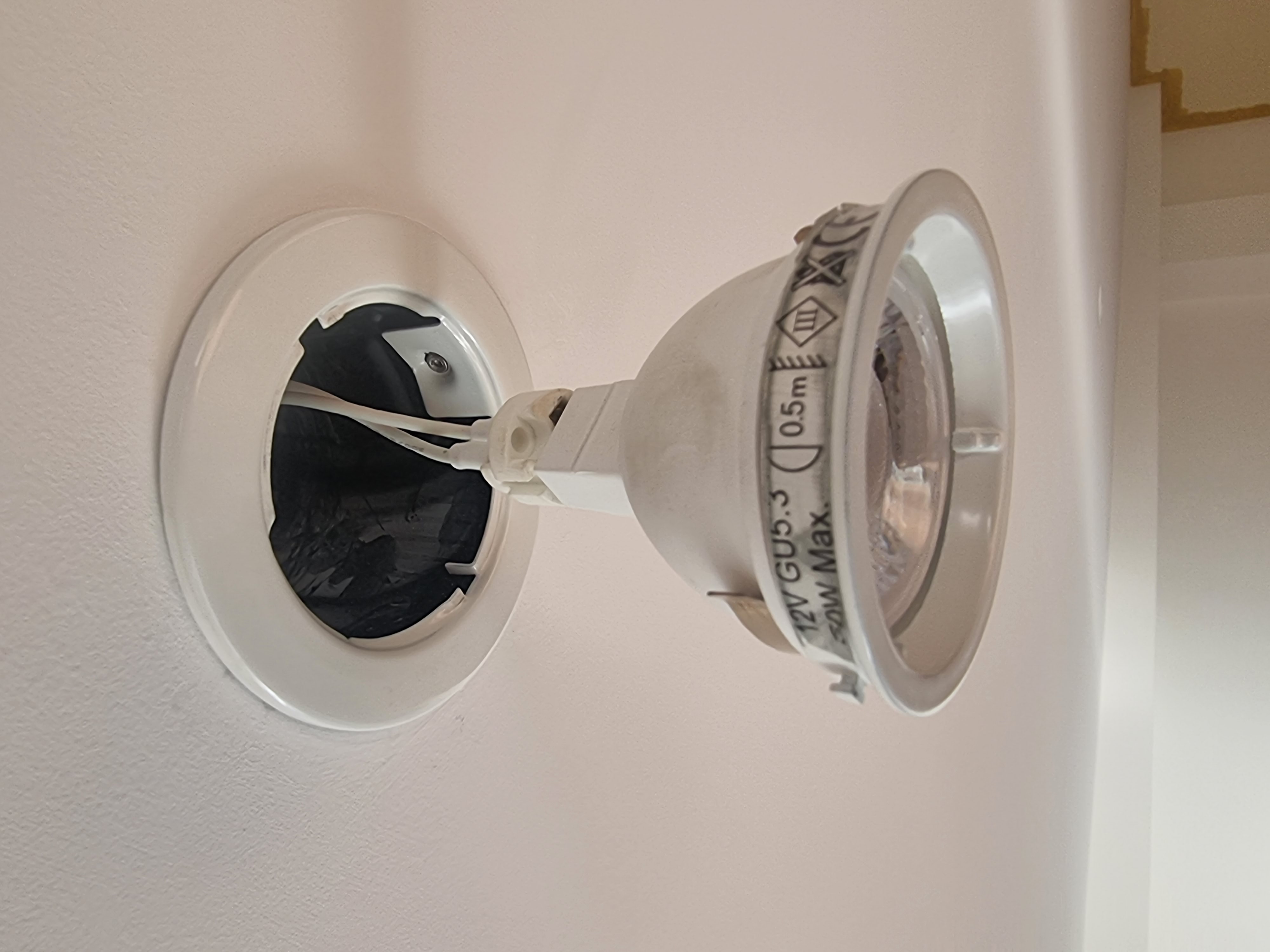

I will take a picture of the offending light - and load in a minute

That is obviously a very different desigh, but I would start by trying to unsrew that bezel. I would expect it to come loose, and behind it something held in place by 2 spring-loaded wings.

Well they look exactly the same as ours - lamp is housed in that unit but driver unit is separate and stuffed in the ceiling void, I had to replace one myself last week. Driver unit was about 6 quid from memory....

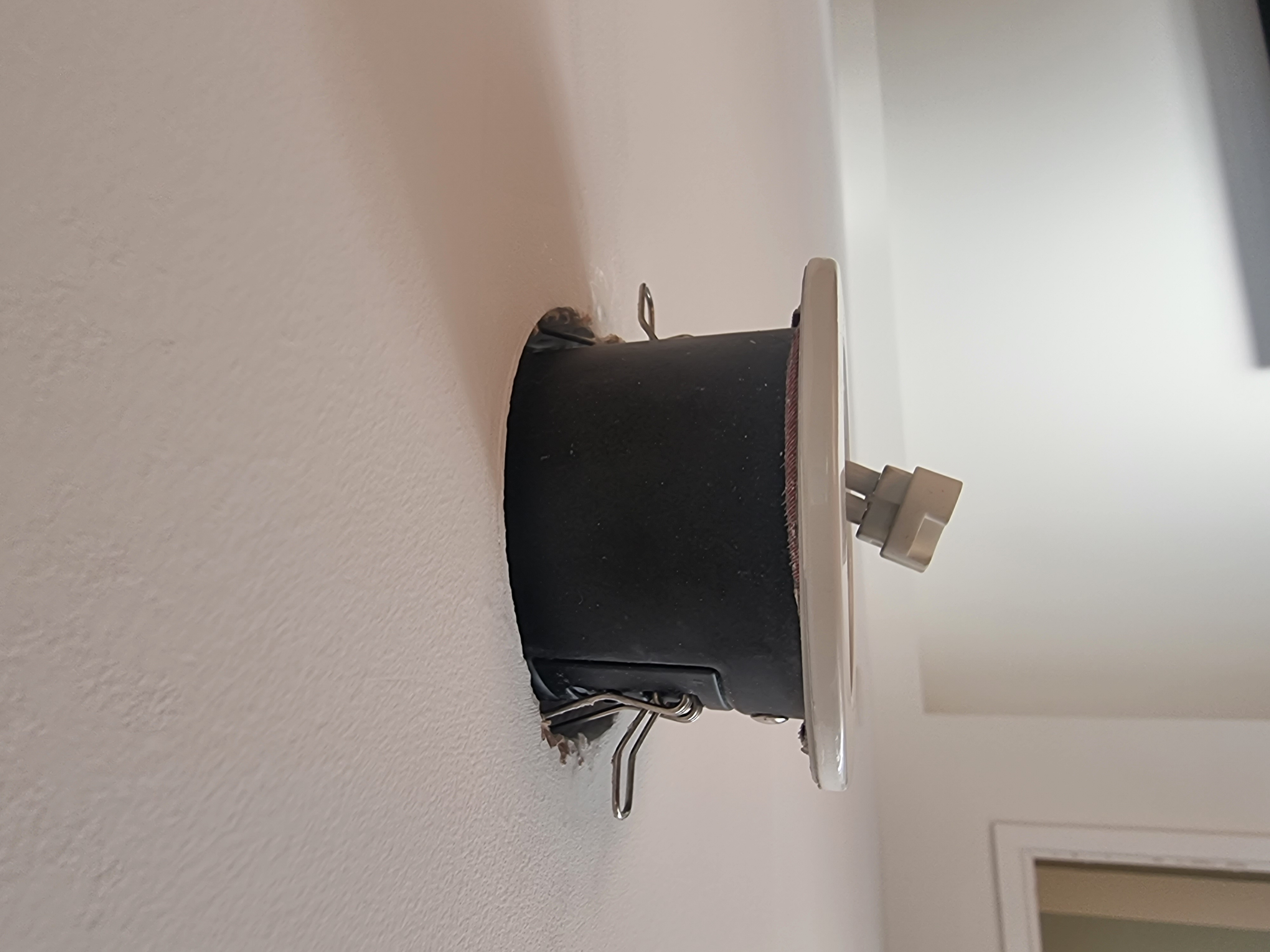

Twist out the lamp holder (some are f-tight and may need a tap to loosen
Stick thumbs up in to the hole and pull down, may require a wiggle
Once is shifted down a little squeeze the locking tangs to ease out of the ceiling
Excuse all the shit, still decorating the room! I had to drop 18 of the poxy things!
