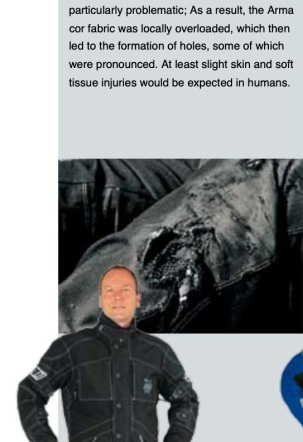

I agree with @The Spin Doctor that Rukka suit construction appears unchanged in years, and it’s still using the same materials.
The only Rukka stuff to get an AA rating is the Kingsley, which has a double layer of Keprotec and Armacor in the shoulders and arms. However, the new Nivala 2, which costs over £2,100 for a suit, has just a single Armacor layer. Rukka’s extracting the urine to charge so much for an A-rated suit!
It would be interesting to see the photos. Meanwhile, I have attached an image from an old ADAC test result. It shows the inadequacy of a single Armacor layer, and ADAC comments on the likely resultant injuries.The Spin Doctor wrote: Tue Feb 15, 2022 6:37 pm It was a 40 / 50 mph bend when I rode it, he reckoned it was about 25 mph when he fell off - the jacket shredded. I'm sure I have some photos somewhere.
- 3DABD053-5F6A-4874-AAAC-9B7CD4C0CCE7.png (125.32 KiB) Viewed 749 times
