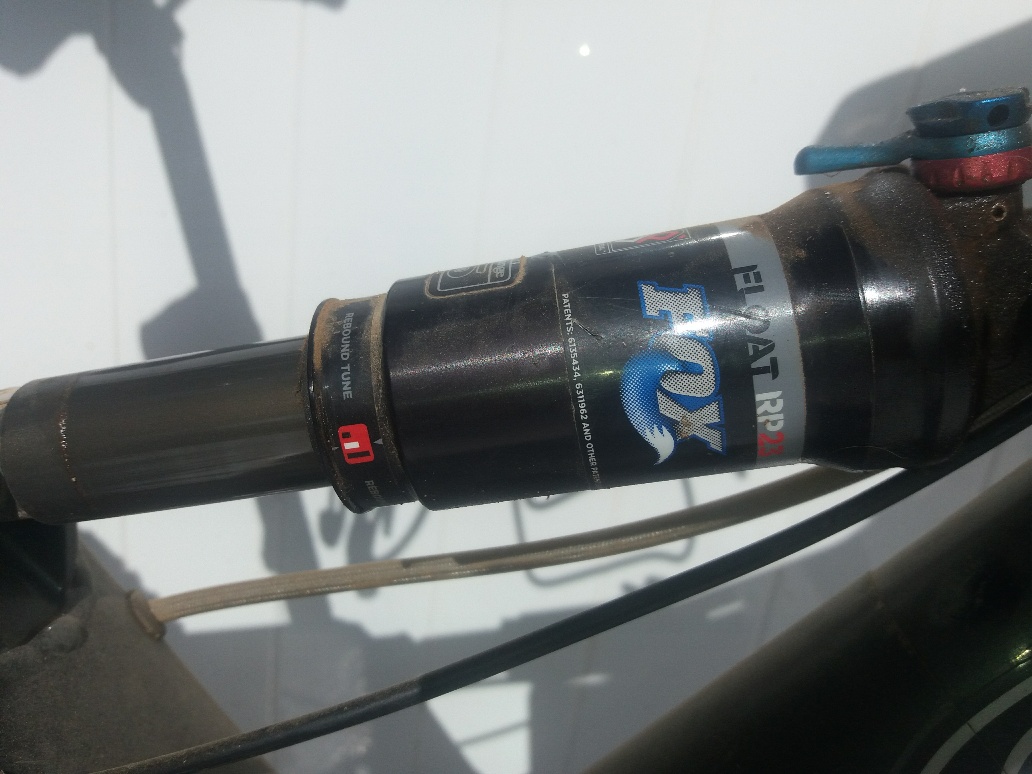

Me brother gave me a bike about 3 years ago, which I brought over in the LMH. First time out, I bust the front forks. Third time I bust the rear shock. I weigh about 4 stone more than him. I only ride it now to the pub to watch footy.
Buy want to start off road again, so need to sort out the sussers. But know fuck all about cycles
Can this rear shock be fixed ?

Yeah, an RP23 was a decent shock in the 2000s, can easily be rebuilt/repaired at a cost of about £100. Local bike shops are unlikely to be able to do it, they'll need to send it out.
In some ways it would arguably be cheaper to buy a used shock on something like Pinkbike/Ebay but you'll need to research your dimensions a bit. LEngth and stroke and get the same. If you stick with a Fox then the mountings should be swappable between the 2.
https://www.ebay.co.uk/itm/Fox-Float-RP ... SworxesHgn
200x51 is going to be pretty close at a guess too.
https://www.ebay.co.uk/itm/Fox-RP23-Rea ... SwdYpeqWAt
This is 190*51 and fits an orange 5 which i'm guessing is the bike in your picture.
You'll ideally want a shock pump, small high pressure pump and pump it roughly to 2psi/kg of bodyweight. So around 180psi for you for example.
