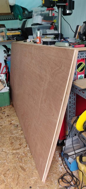

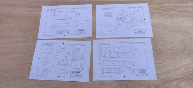

I've spunked £36 on the plans and gone shopping. It's constructed using the "stitch and glue" method out of three sheets of 6mm ply and one of 12mm ply, I reckon it'll cost me £200 in materials, painted.
So, I need to convert this into something looking like the above ...

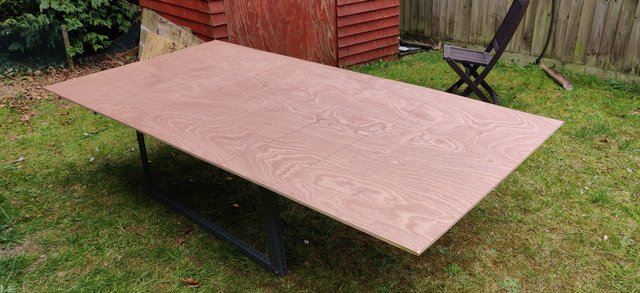

I started this afternoon.
Needed a platform to work off, so made up something to act as saw horses out of some spare dexion and started marking up the first panel

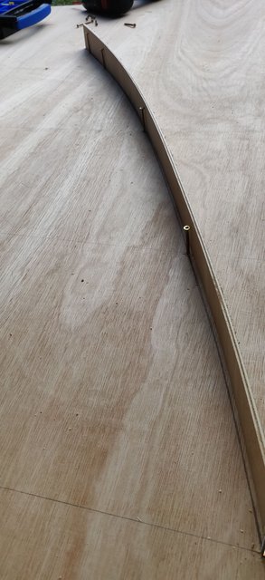

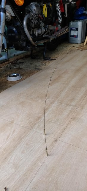

I started with the bottom, made from two bits of 6mm ply. Marked them out from the plans, and then needed a cheap way of drawing a curve. Came up with an idea of slicing a strip of ply off the end of a sheet, screwing some long screw into the board at the datum points 300mm apart, and using the ply as a flexible ruler. Worked out OK I think.

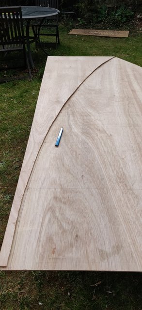

Then I cut the curve with my trusty jigsaw, which I treated to a new blade.

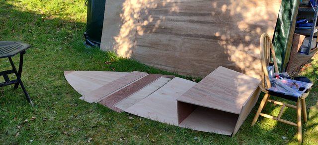

Re: Boat build project
Used the bit I'd cut off to mark out the other side
Back to the jigsaw,

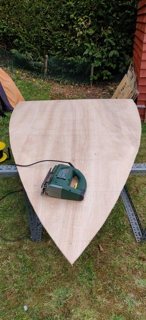

and repeat for the back section as it's too long to fit on one sheet,
Finished off with this
Back to the jigsaw,

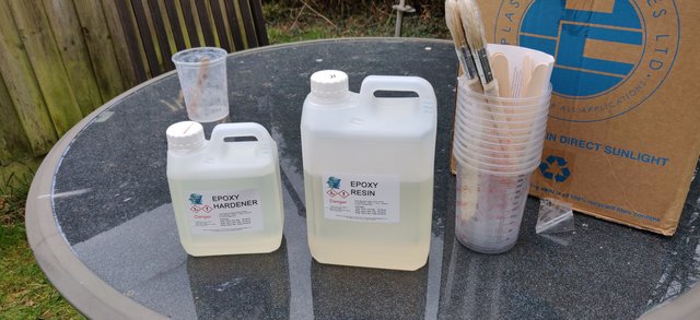

For epoxy thickening I'm planning to use fumed silica, that's what my epoxy supplier has recommended.

Thanks Yambo, all advice is useful to a newbie! I especially like the cake icer idea! When filleting a near vertical joint (the two side panels where they meet at the bow) is it advisable to turn the structure on it's end so the joint is horizontal, or will the epoxy, suitably thickened, stay in place? All ply joints will be covered in 75mm fibreglass tape and epoxied over the fillet internally, and then covered in the same tape saturated with epoxy on the outer seams as well. I decided not to sheath it in fibreglass to keep it light, but will saturate the ply inside and out with epoxy once built and before painting.
I didn't know what fumed silica is, so I looked it up:
Fumed silica (CAS number 112945-52-5), also known as pyrogenic silica because it is produced in a flame, consists of microscopic droplets of amorphous silica fused into branched, chainlike, three-dimensional secondary particles which then agglomerate into tertiary particles. The resulting powder has an extremely low bulk density and high surface area. Its three-dimensional structure results in viscosity-increasing, thixotropic behavior when used as a thickener or reinforcing filler.[1]

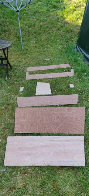

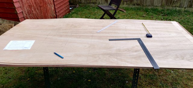

This afternoon I cut up the 12mm sheet into transom, stringers, frames and seats, breasthook and rowlock doublers, and completed sticking the two side panel sheets together to make one 12 foot long 6mm ply sheet to cut the sides from.
Next job is to mark out and cut the side panels and cut out the apertures in the seat frames and stringers, then I can start fitting the components together ready for glueing. It's going well so far I think ...
