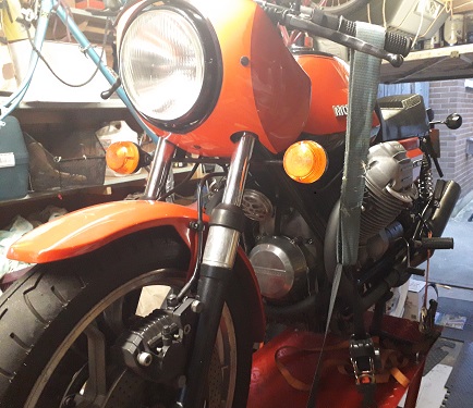

Brake fluid arrived yesterday from Amazon and £2 cheaper than Halfords down the road, which I can't go to.
Going to give the brakes a clean as well. My front right disk warped last year, the first disk on any bike I had had warp in 40+ years. And on the last couple of rides I've had a couple of squeals when using the brake at low speed. I'm wondering if i have a caliper piston sticking as well.
Got the bike up on the bench last night and I'll spend the next few weeks of isolation servicing the brakes.
