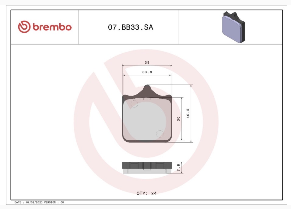

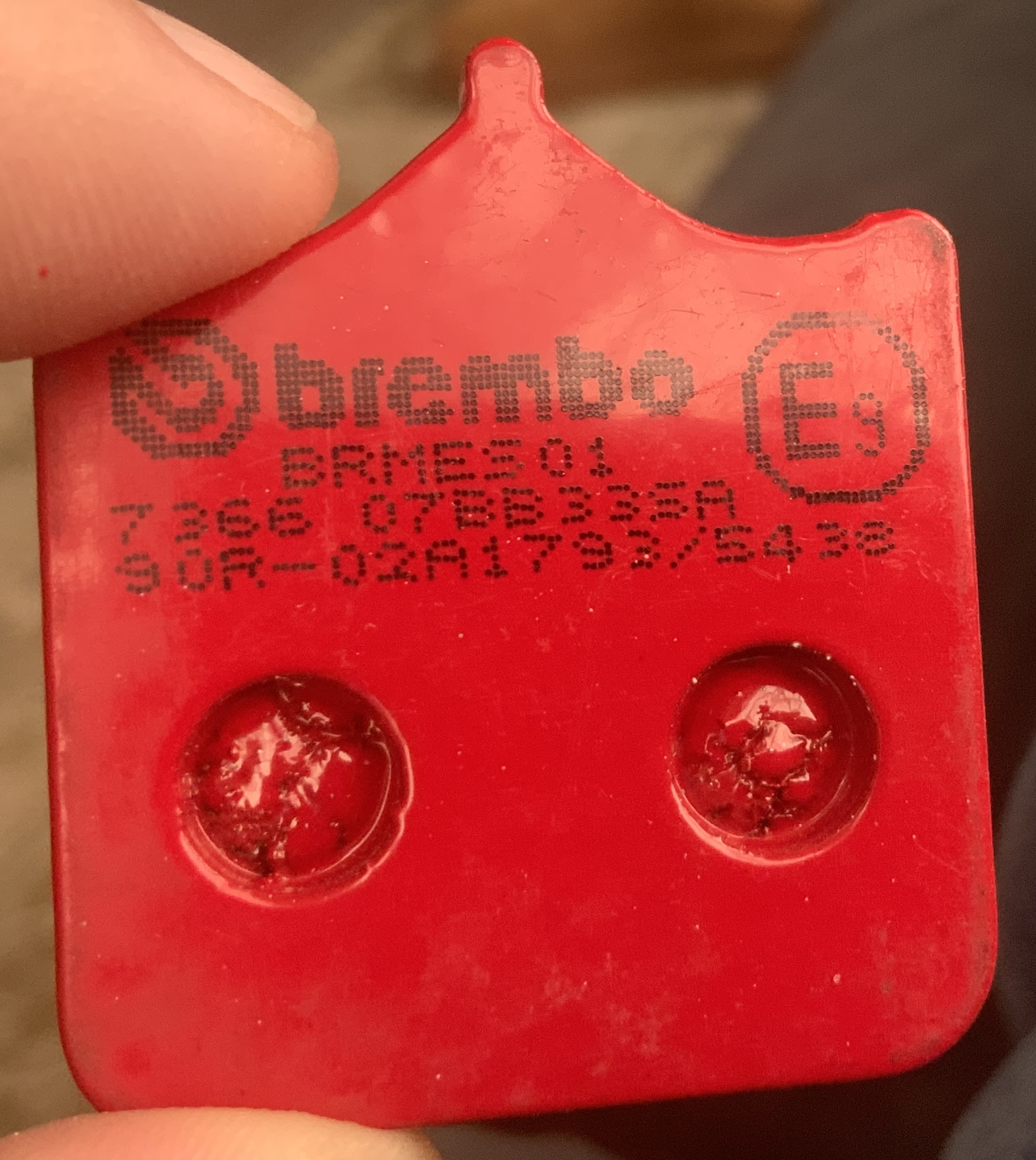

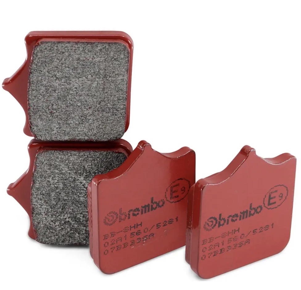

Spurred on by this post I thought it was time to give the pads on the Triumph a once over.
After 8,000 ish miles they are down to about 1mm so not exactly in dire need for a swap but I thought I’d give them a new set.
New ones arrived the other day and I was immediately suspicious.
Nothing 100% jumping out at me but a combination of things.
The packaging looks genuine and matches the Brembo site but was a bit battered and dog eared.
The paint on the pads was a bit scrappy, but since checking on the Brembo site the genuine ones don’t look any different.
So I was more or less settled that these were OK and I was just being paranoid, the paint was similar and the packaging was probably sitting around for a while.
Then checking today the rear of the pads looks good, printing was a good quality.
However there are a couple of anomalies that are bugging me.
Adding to me initial suspicions is the fact that these ones have holes in the backing plate that I cannot see on any image search for these pads.
Here’s the image from the Brembo site.

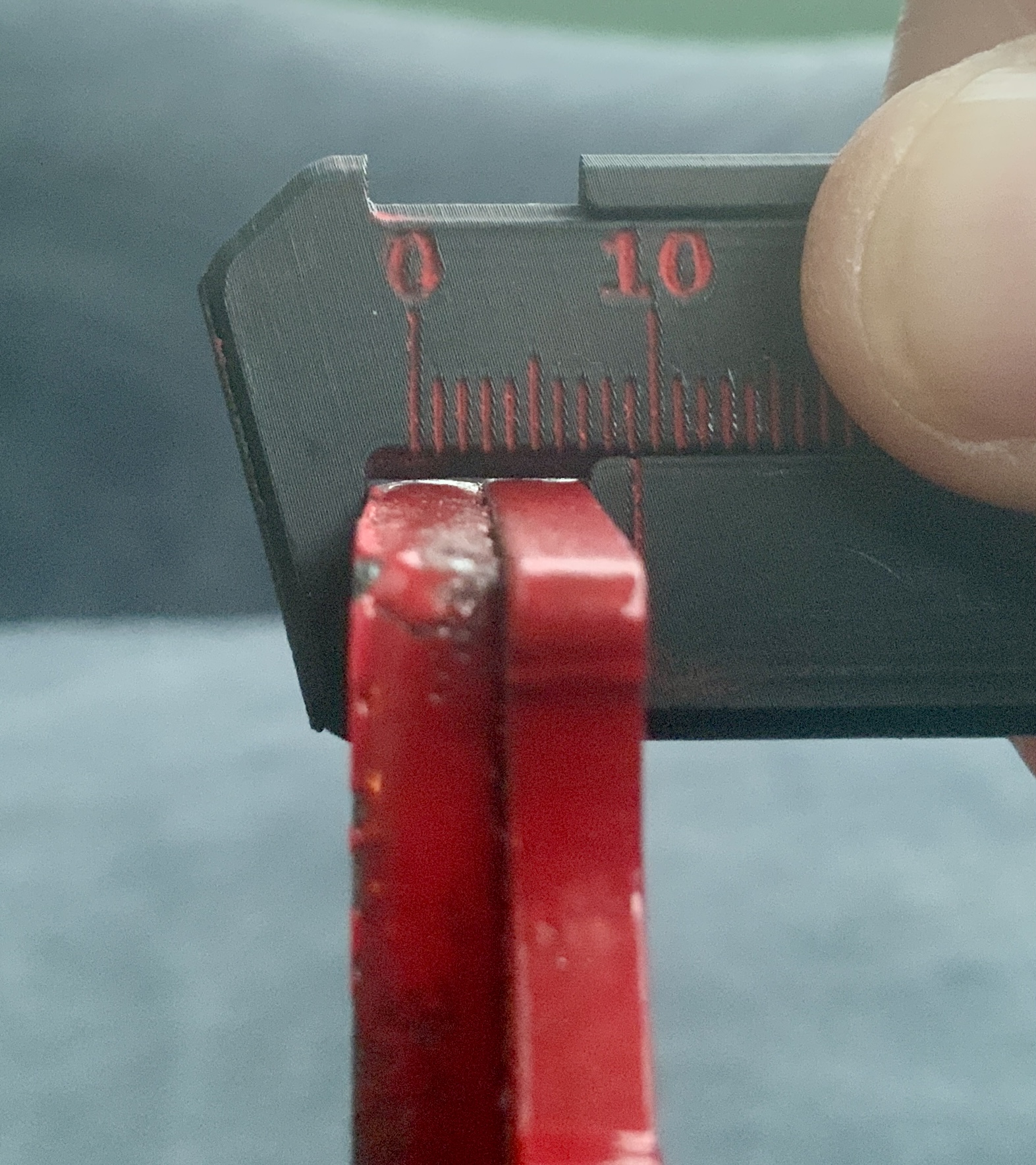

Then when checking the thickness these have a much thicker friction material part Brembo, I measure 9mm where below it shows a thickness of 7.8.
Both have a 4.5mm back plate (I found that dimension elsewhere).
What do you folks think? Am I being paranoid or are my suspicions that these could be fake correct.
Brakes are not something I want to be anything less than 100% certain about, especially as my bike only has the 1 front disc!
Re: Brake Pads
They look a bit fake to me, they're a different colour red.

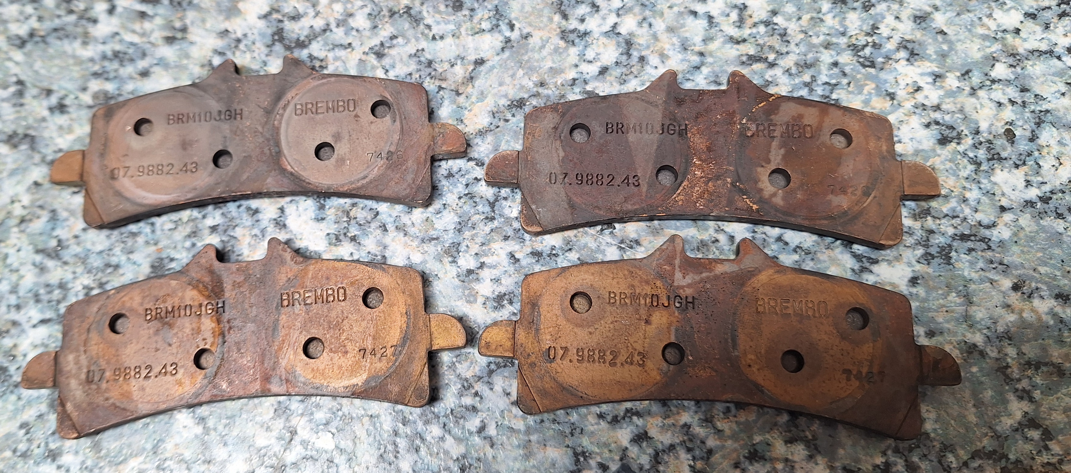

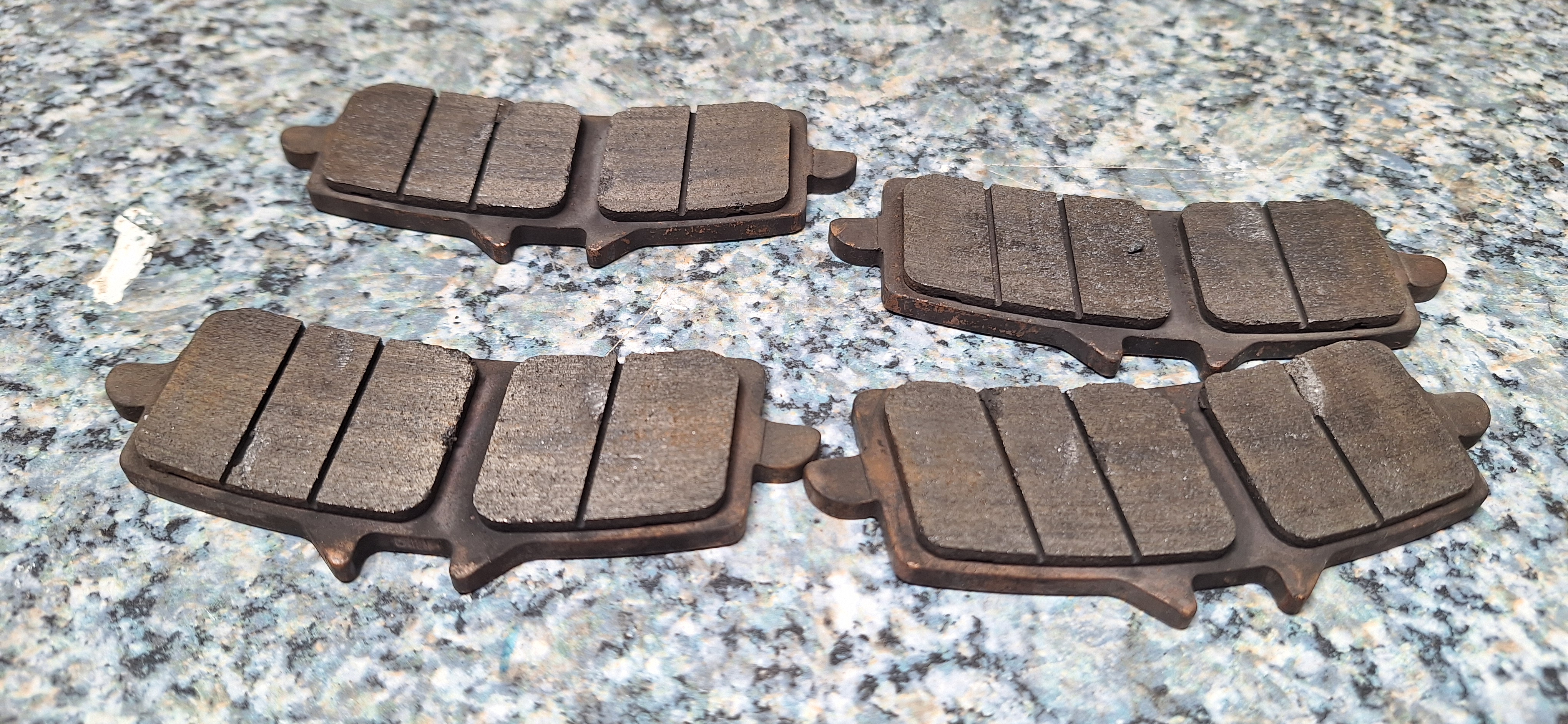

These are the Brembos I took out of the GSXR a few weeks ago.
They were absolutely shit BTW

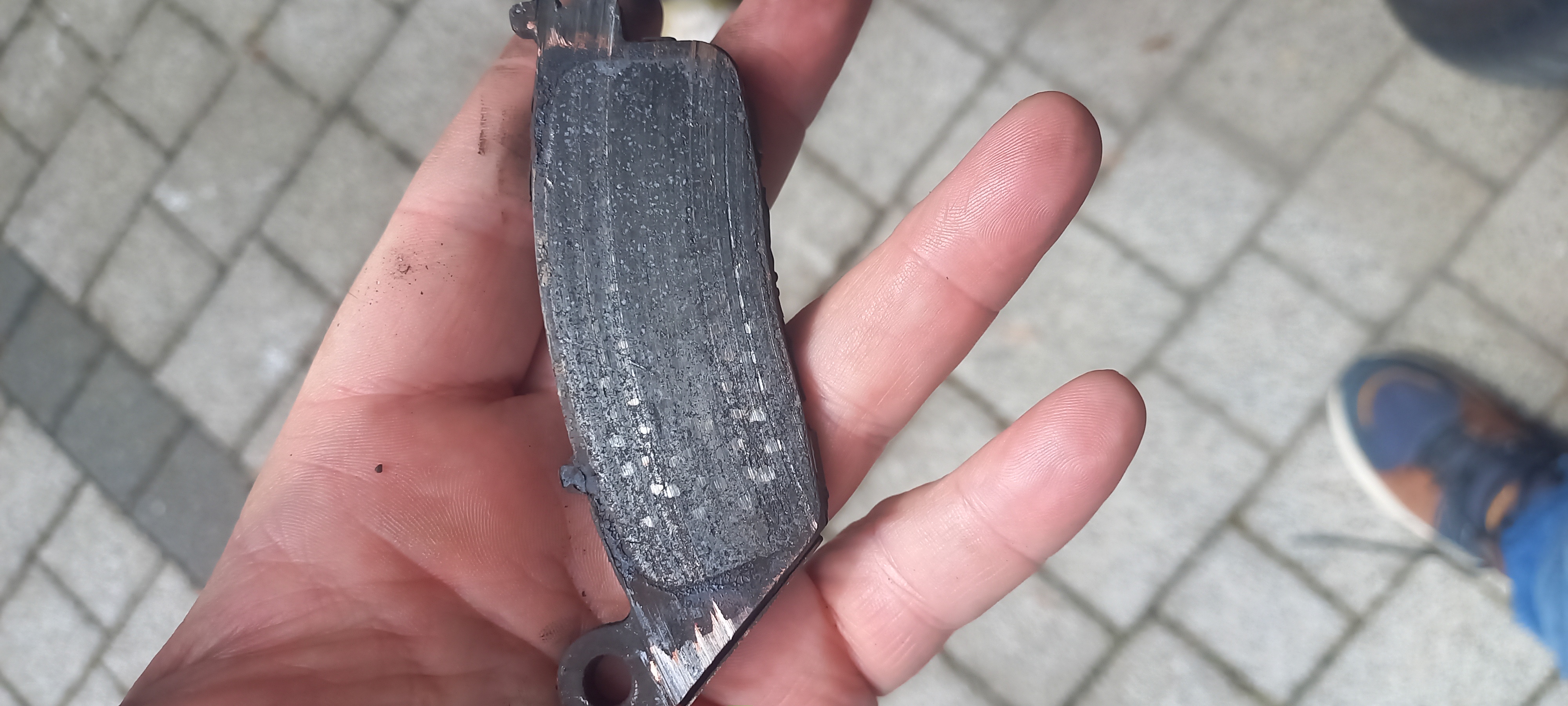

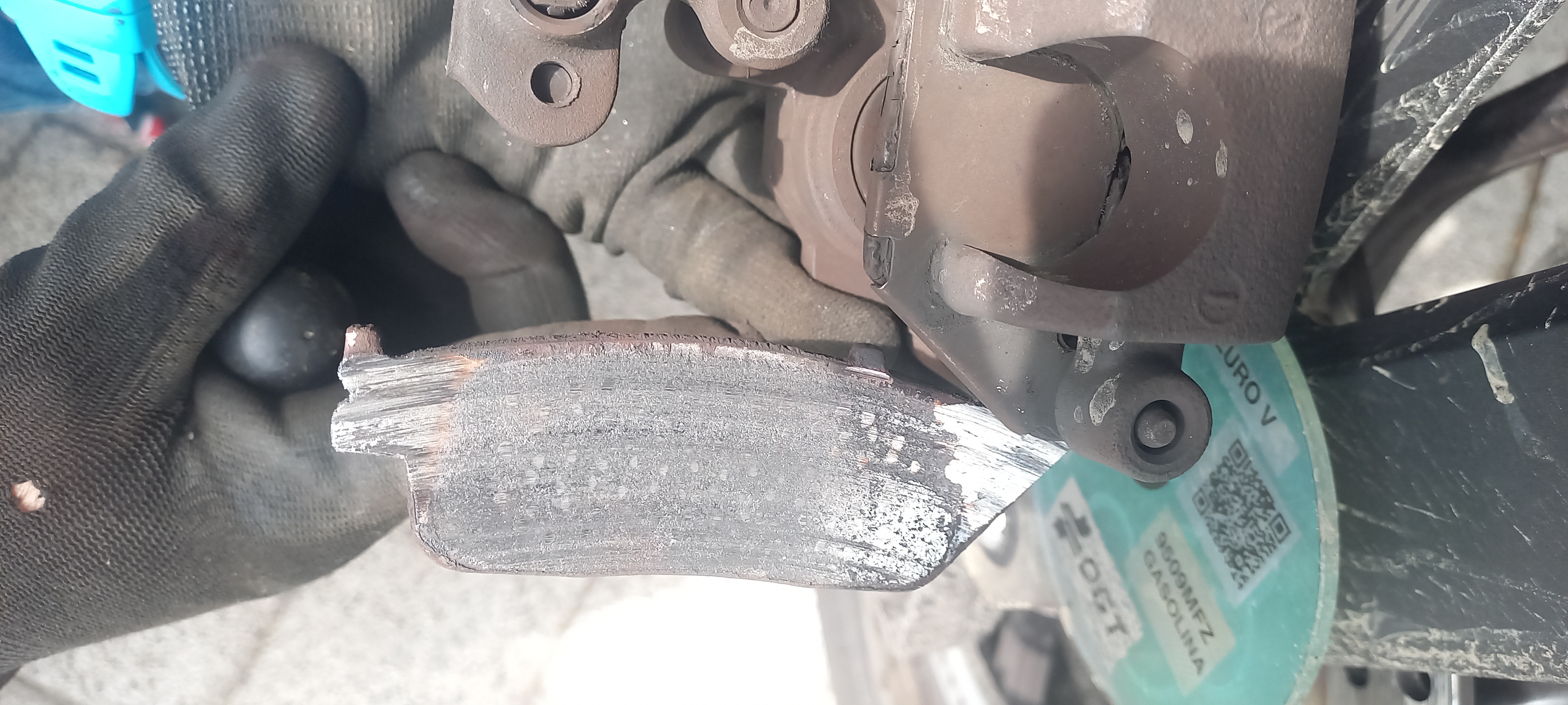

My NC750 wears the pads out really quickly-on my 3rd set (of ge uine Honda pads) now at 38000 kms.
The last pair were down to the metal after 8000 kms, a lot of which was covered on motorways. And found this whilst at my mates in Wrocław in Poland.
Could not get any pads for it locally, only place he could find a pair was at thr Honda dealer in Poznan, 180km north. I had no choice but to ride there as it was.
Bit paranoid about pads in that bike now. They have done 10,000 kms and still have a fair bit of pad material on them
