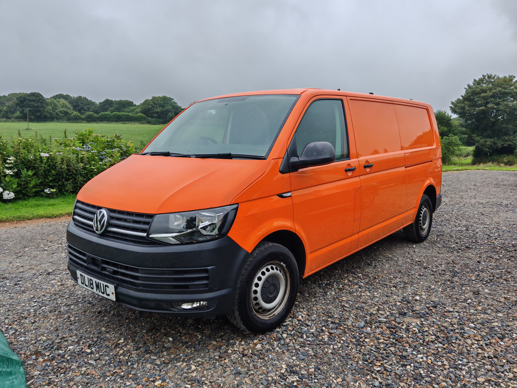

Thought I'd stick a few phtots up as I go along sorting out my new van.
As some of you will have seen,
We started here.....
128k ex RAC van bought from Ivybridge Commercials.
We struck a deal at £14,300.
2.0 Tdi 140 bhp
Dsg auto gear box,
Tailgate and tow hitch.
I was lucky enough to be able to ride my bike over last weekend to pick it up.
And I've been busy ordering parts ever since

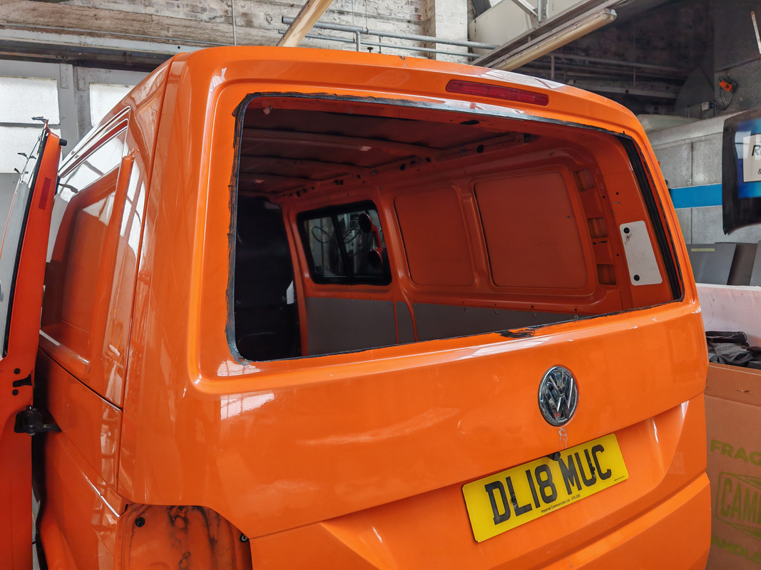

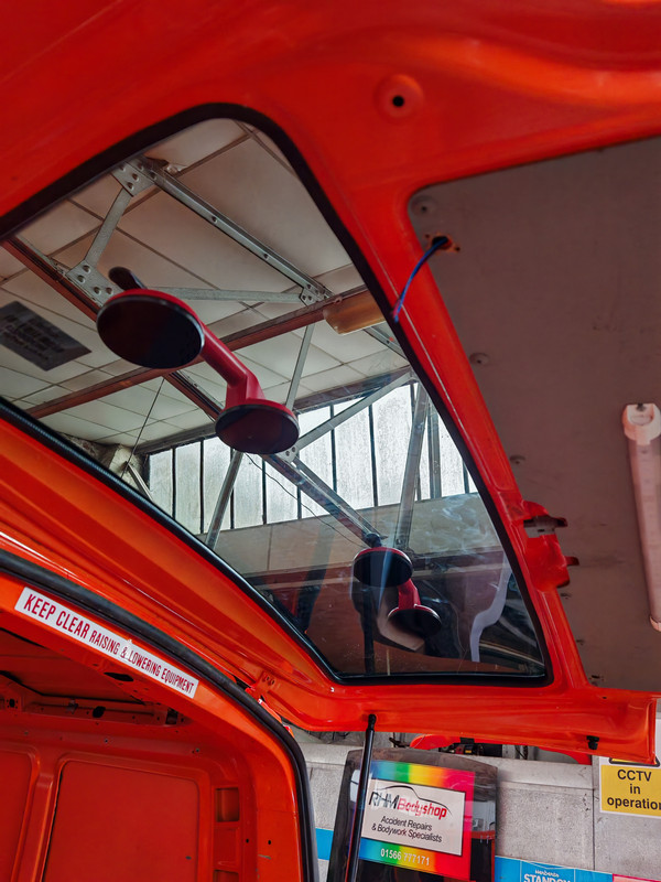

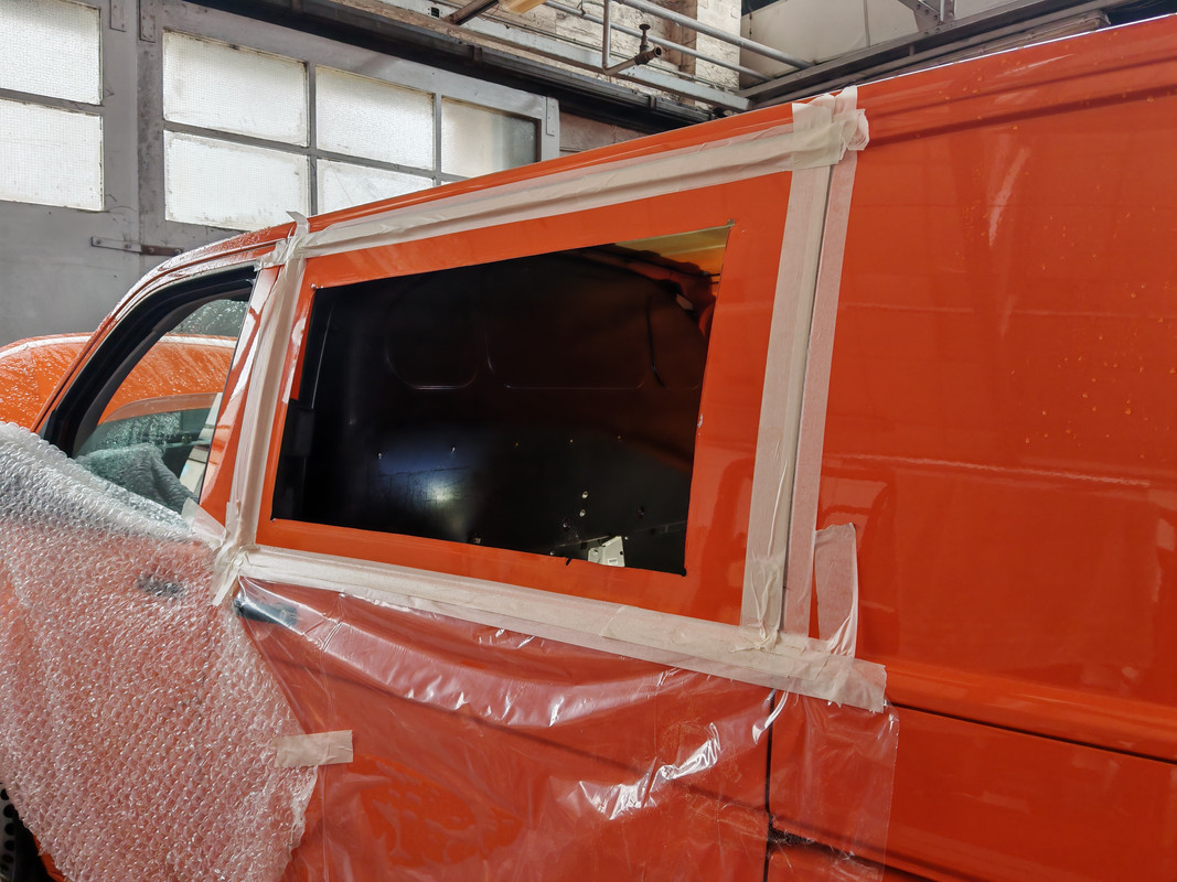

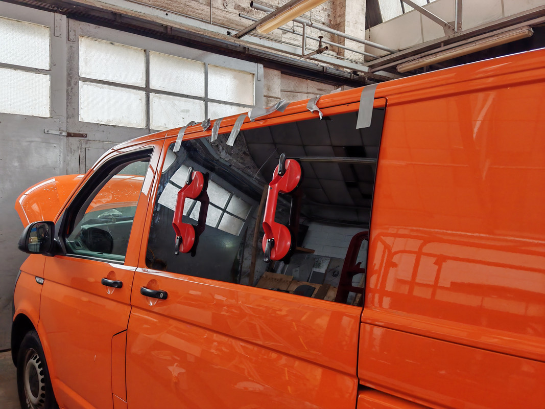

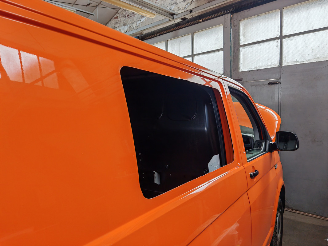

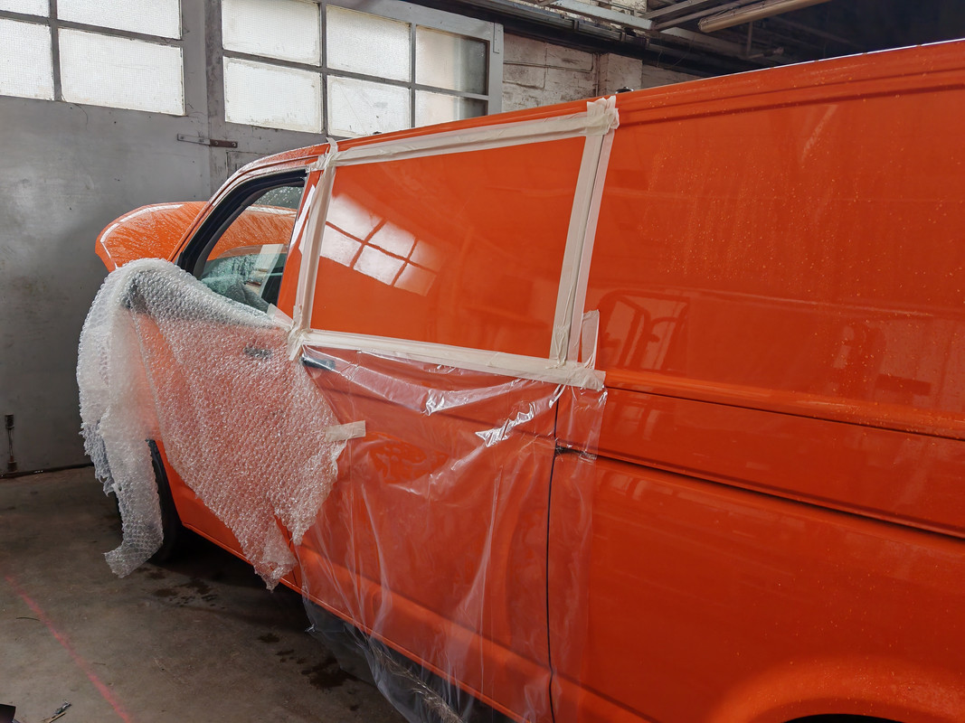

Last weekend all I managed was to pull out the ply lining and give it a good pressure wash and scrub inside!
Rather a concern was when the low coolant light came on. Upon inspection the tank was well under the minimum whci is not a good sign considering the "service" that was carried out just recently!
I've been flat out at work all week and didn't even get around to taxing it until Thursday!
I spoke with the dealer about the low coolant and they asked that I top it up and monitor it. I put in 500ml of water. (it's less than an hour's drive home from the dealer).
Friday, after meeting a mate for breakfast, I eventually rolled around to my brothers unit around lunchtime. I got the back bumper off and after a faff, removed the tow bar as its rusty and needs to be powder coated. I'm powder coating a swingarm I got for my Smc at the same time.
Today was the real challenge....

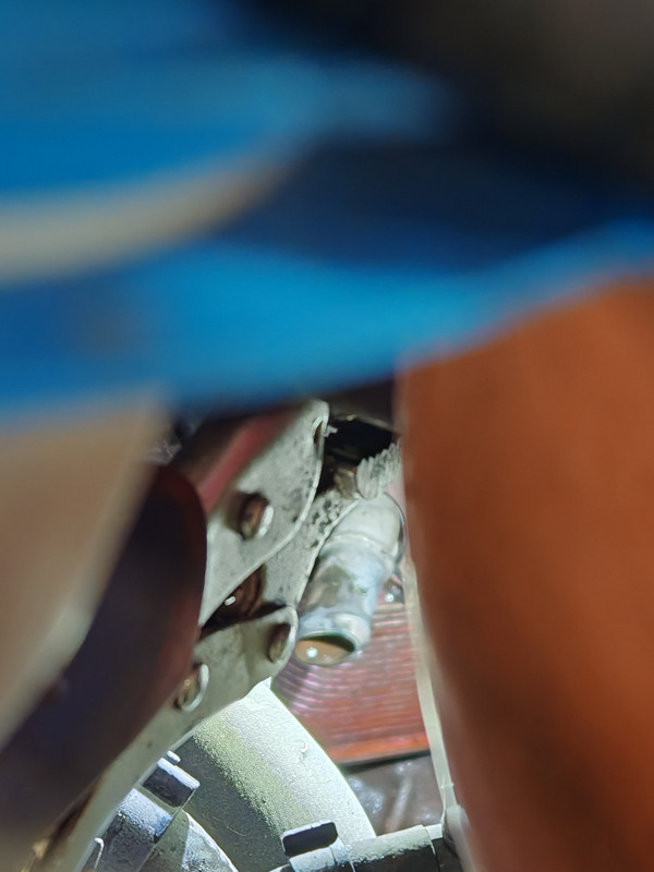

Well....
Yesterday, we finally got the van in the garage.
Very quickly, this was spotted as the fault
Thats the gearbox oil cooler!
Our guess is that this was done during the flywheel replacement that was carried out recently.
The dealer I bought the van from, has, in fairness, been very good throughout. Answering emails promptly and politely. Isent them the Pic above and they asked for an estimate. I sent one (£456) and was very swiftly told to go ahead and get it done.
Tyremarks (the garage) managed to squeeze it in today, replaced the oil cooler and threw a new map on it while they wet there.
So now I have a van that doesn't leak coolant, does have 180hp (up from 147) and an extra 100 torques. It definitely does still have an egr valve too.

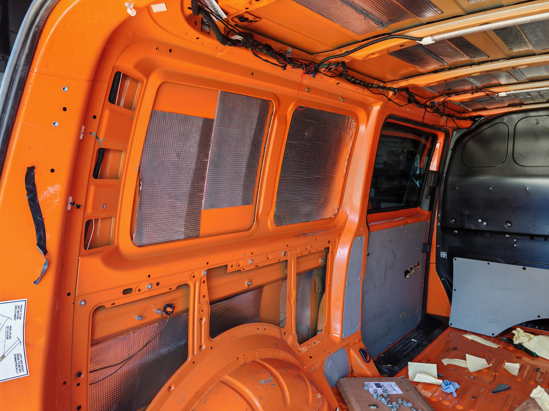

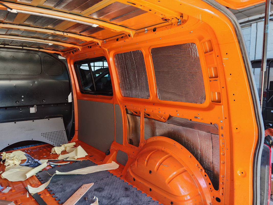

I've got some sound deadening in,
And some insulation (Dodo mat)
Another layer of insulation to come, then some paneling.
I fitted an Auto vox v5 pro rear view camera set up. It's pretty good, I'm actually quite impressed. I just wish I could flip the image so I can mount the camera tidier, and I'd like to set it to NOT play a wee little tune every time I turn the ignition off!
