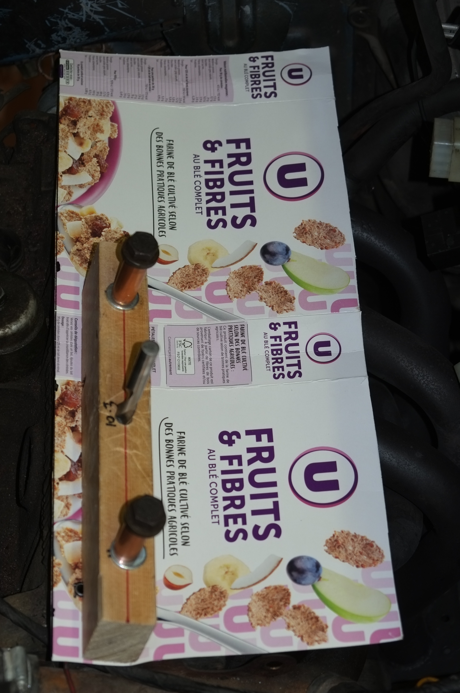

To maximise my chnces of success, I needed to make up a jig to improve my drilling accuracy, and for that I'd need someone with a pillar drill. So I rang up Andy (an ex-pat who has been living in France for around 20 years) to ask if anyone he knows has a pillar drill. He replied to my delight that he had a small pedestal drill but wasn't sure it would be man enough for the job. I assured him that it would be, as I was only drilling into timber and simply wanted to make a rudimentary jig that would give me a more accurate 90 degree/perpendicularity than I could manage by hand.
So long story short, I now have a jig that I can bolt to the block and which will give me as close to 90 degrees as possible, and more importantly will allow the drill to self centre. Initially I was going to run multiple strips of masking tape over the block face to stop any swarf going where I didn't want it to, but eventually decided to use a sheet of cardboard with holes cut in for the two locating studs, the thread I was drilling and tapping, and the dowel that sits very close to one of the locating studs. I wasn't keen on leaving any residue on the block face, and masking tape isn't the strongest of stuff. Hopefully the picture below explains better than I can.

No-one ever said it would go without incident and it certainly didn't, but I think I have enough thread of sufficient holding power in the block to at least get the car back to the UK (after some reliability testing in France). The jig worked really well and I cannot begin to imagine how I could have done the job witthout it (or something similar). The drilling out process was nervy - no matter what combination of drill speed and pressure I used the drill bit would find ways to grab, but in the end the hole got drilled and it looked and felt perpendicular to the block. I also used the jig to guide the tap in (having drilled out the jig hole to accommodate the tap) and this made the all-important first few threads easy to cut. I was having to use a fair amount of force to cut the thread, but not so much that it threatened to snap the tap. Cast iron feels 'grainy' when tapping, not like mild steel.

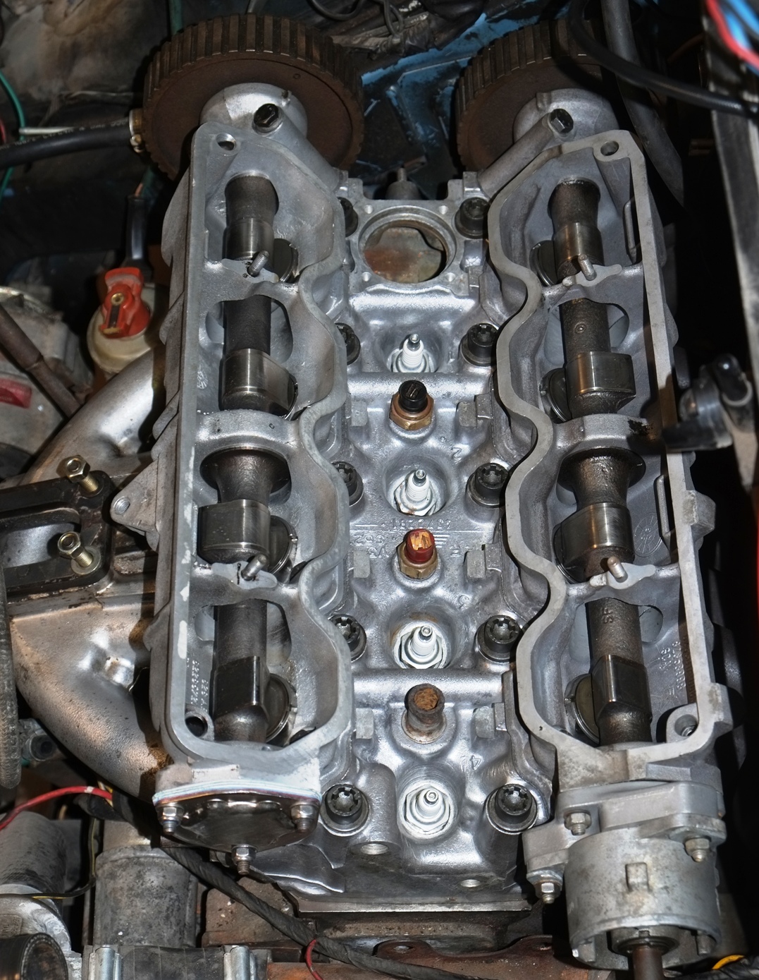

Progress on the Beta up till now has been completely lacking, as Andy has been hors de combat since his fall, but today Jackie arrived at Beziers airport. Within a few hours of her arrival I'd press-ganged her into action. We removed the bonnet, transported it to a safe place and (glory be) fitted the head and inlet manifold to the block (it's an awkward, heavy fucker and definitely needs 2 people to fit). We even managed to wangle the exhaust manifold onto the head studs (with the gasket in place) and secure the manifold to the head with a couple of nuts, ready for later full tightening.
I was tempted to call that a day and leave the main event (tightening down the head bolts) to another time. But as that would only be postponing the day of reckoning I decided on the Macbeth approach - 'if it were done, then t'were well it were done quickly'...
So out with the torque wrench and find GC's instructions for torquing the head down. The first pass at 20 lbs/ft was uneventful - even the suspect No. 4 bolt felt the same as all the others. Next was 40 lbs/ft and trepidation definitely creeping in, but No. 4 bolt passed without incident. Then for the big one - 60 lbs/ft... I have to confess I was absolutely bricking it on pretty much all of the bolts (especially No. 4), but they all torqued up fine and nobody died. So while it was belated, it was definitely a moment of success. Here's the head, suitably clamped in place:
