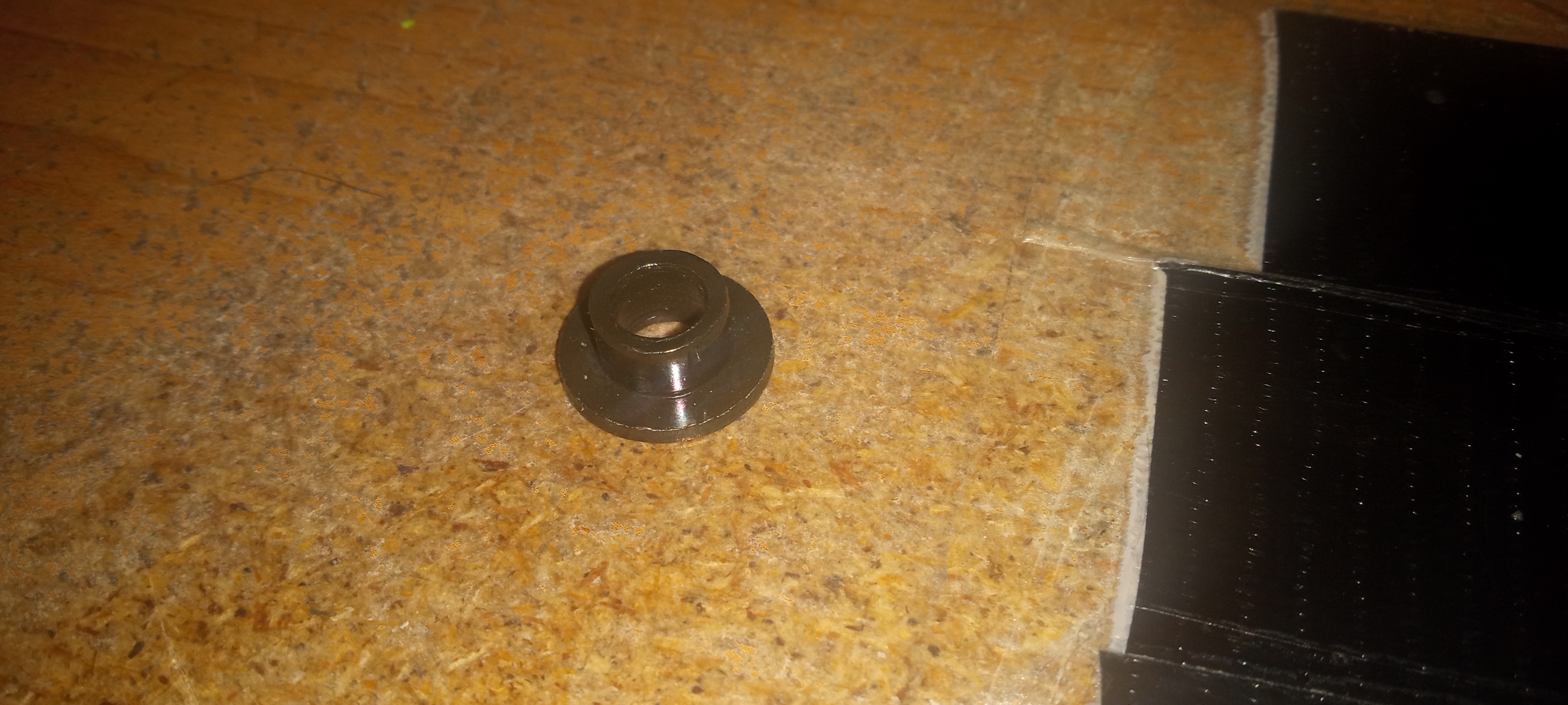

Re: '95 ZX11-D3 stuff
Posted: Tue Jan 13, 2026 7:10 pm
by ZRX61
Yup, mama kaw call it a collar though.
