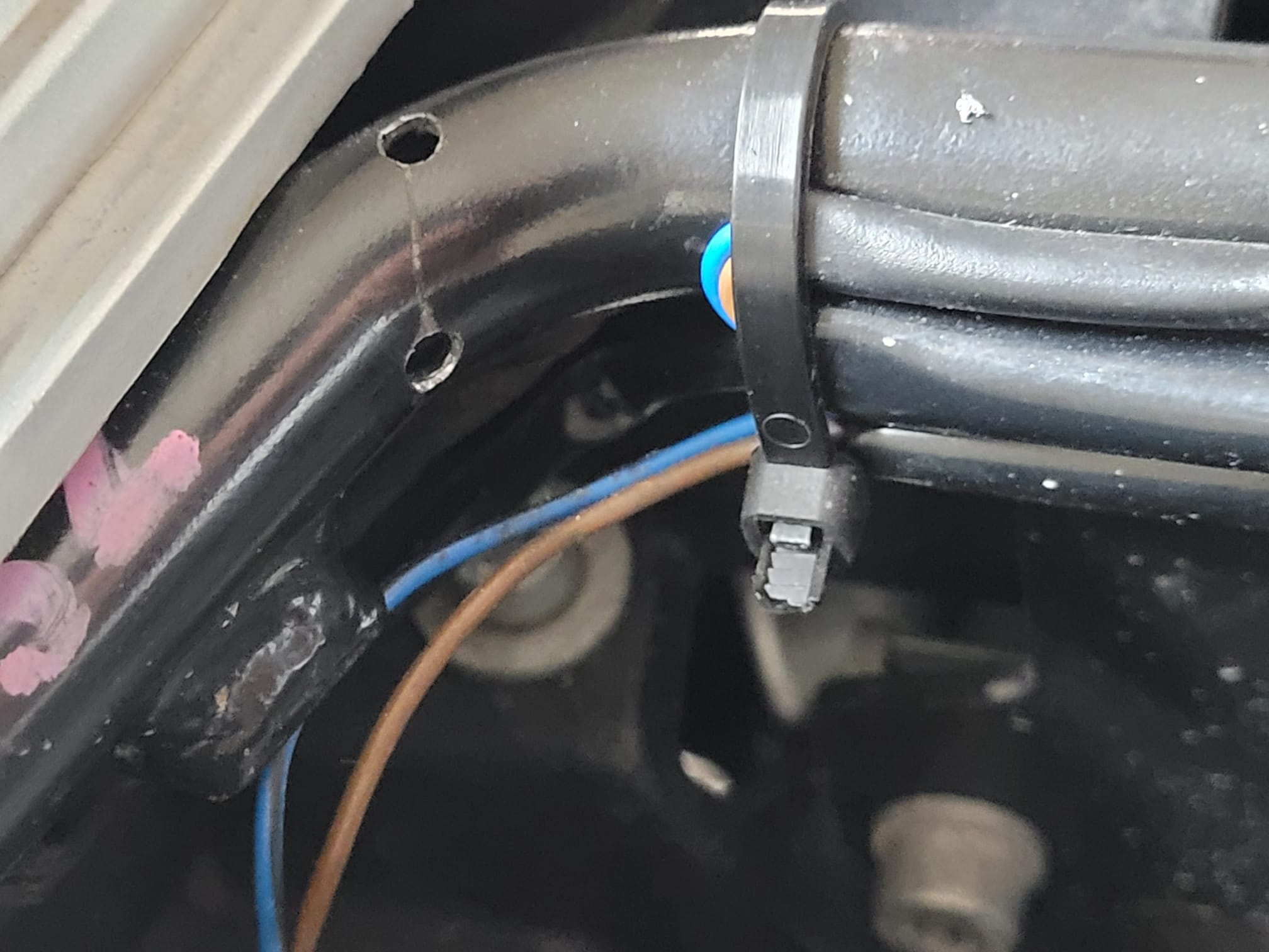

Finally remembered to do that.Rockburner wrote: Mon Mar 27, 2023 8:23 am Drill a hole at the end of the crack, it'll stop it propogating any further

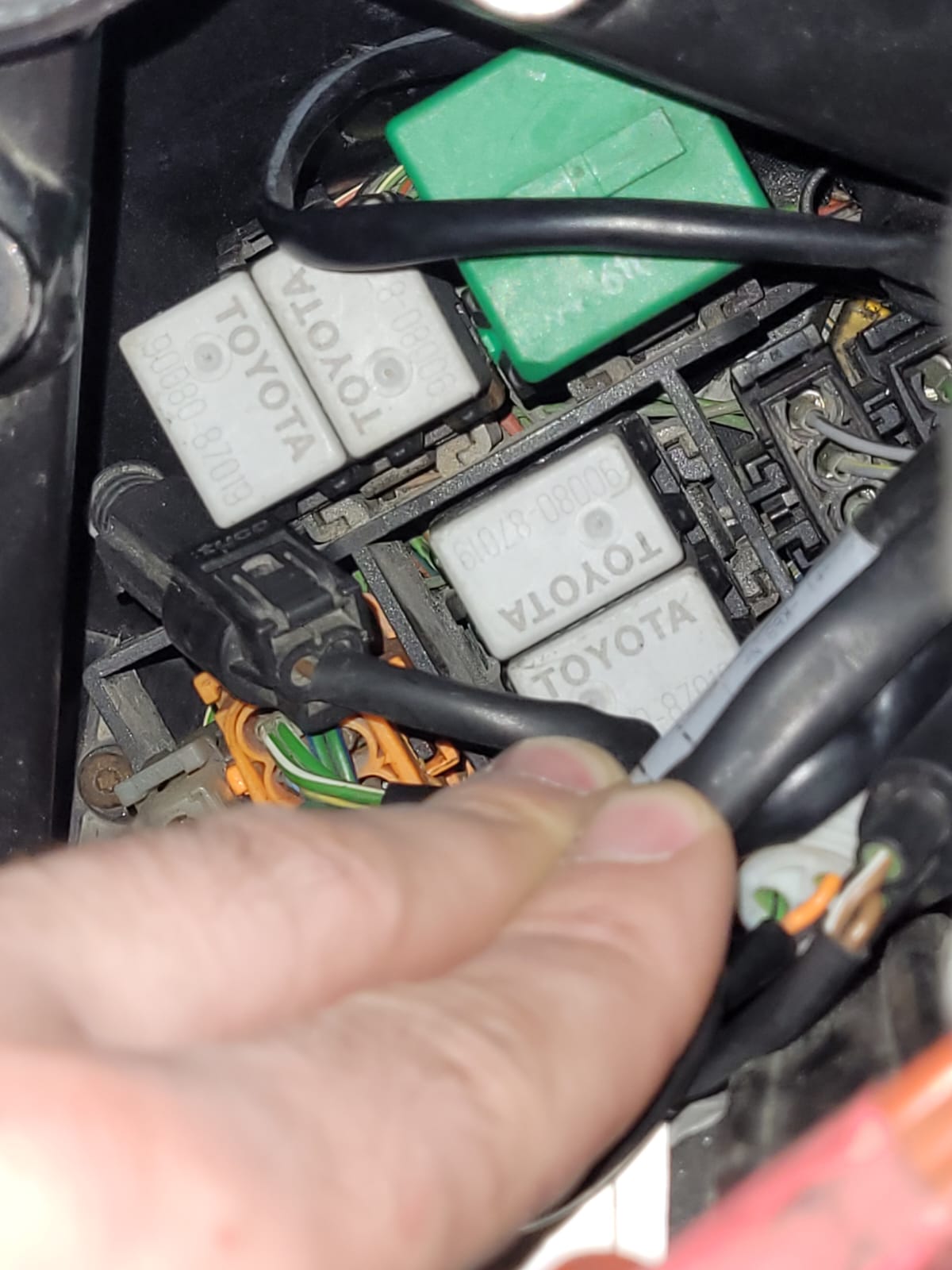

I've made a hybrid. Or something? The relays fit perfectly and have identical function. The resistance across the trigger side is 78ohm where the original relays have 103ohm, but I don't think that will be a problem.A_morti wrote: Fri Mar 31, 2023 9:40 am I've ordered some used Bosch relays out of a Toyota. They won't click into the BMW's fusebox, but still, I'm about done with the crappy Tyco relays BMW specced for this bike.
With any luck the bike will now be reliable (yeh right)
