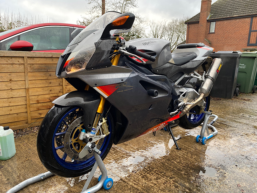

I couldn’t be arsed to change one thing at a time as it takes too long to make the bike misbehave. So I bypassed the side stand, replaced the main fuel filter and the hoses in the tank and cleaned the tea bag filter. I also put some brand new fuel in it and some injector cleaner. Took it out for a run and learned nothing as it’s far too slippery (it turns out) to slam the throttle wide open in any gear trying to make it hesitate and then leap forward. It did run really nicely though and accelerated well but I’ve no idea of I’ve fixed it. It’s off to AP in a couple of weeks for a tune and a good going over.
Made a right mess of it so had to clean it again but at least it’s not embarrassingly shitty for when I take it to Tamworth.
