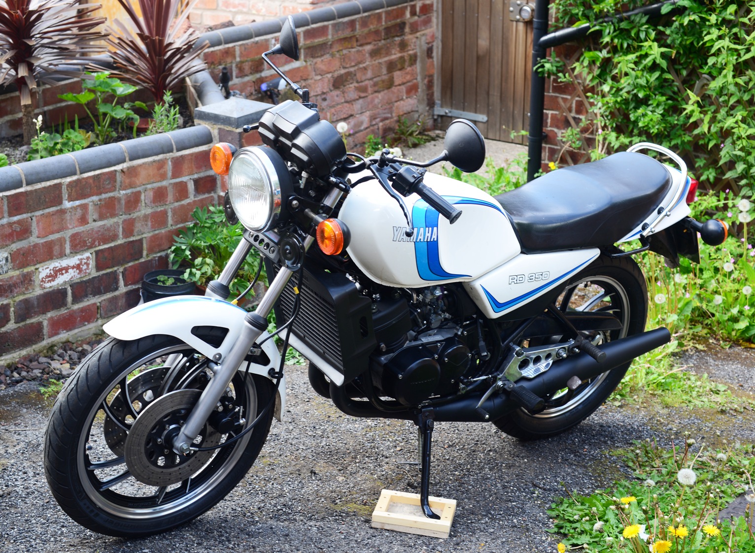

The LC got its first 50 miles of running in under its belt yesterday. Initially it was threatening to foul its plugs whenever the revs dropped below about 2000, doubtless due to a) the amount of lube used in reassembly b) a 'strong' pre-mix ration and c) bleeding the oil delivery pipes by pulling the oil pump cable so the pump was at max delivery. Once I'd fully bled the delivery pipes, the ratio of premix was diluted by bunging in a gallon or two of straight unleaded, and then diluted some more by filling the tank up at my local Esso dispensary.
To try and avoid any further unpleasant oil pipe/exhaust flange adjacency I enclosed the one large and 2 small oil pipes in some spiral wrap to ensure everything stayed where it should. I'd also greatly reduced the amount of slack in the smaller oil delivery pipes for the same reason.
I'm also going to try and stay on top of keeping the newly refurbished wheels shiny and spangly, as the bare ali can turn furry with very little provocation. Half an hour with some 'Mothers' ali polish brought them and the fork legs up a treat. The real chore will be cleaning the 'spokes'. Perhaps tomorrow...
At first sight the bike doesn't look that much different to the one I posted at the start of this thread, but a fair bit has been done. All paintwork is original as is the frame and swingarm. Grab rail has been re-chromed, the bars and top yoke have been powder coated satin black and the spannies have been ceramic coated, but that's about it.
