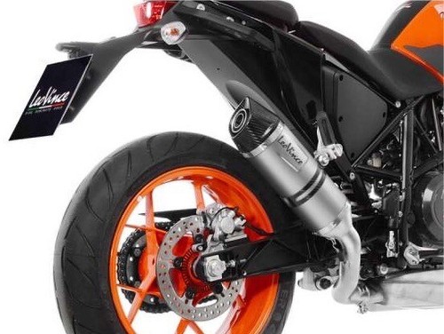

So i bought the Cat converter from Leo VInce.
The Cat is almost 6kg so it's a massive saving of weight, along with being a LOT tidier and also giving the ability to change the oil without getting it all over the Cat.
The one irk i have when people do this conversion is that they leave the bracket that holds the Cat in place.
delko and Leo Vince by Steve Weeks, on Flickr
If you look by the front of the engine you can see it there.... It's an easy removal job but needs a spacer installing.

SO it arrived and is fitted. It even comes with the spacer for removing the bracket.
2020-04-08_10-50-54 by Steve Weeks, on Flickr
It also mounts with a rubber mount which allows a bit of flex, the cheaper straight trough versions don't.
2020-04-08_10-48-03 by Steve Weeks, on Flickr
Looking down it, it has baffling built into it, so the pre-silencer is actually defined rather than just a 'shape' built into the can, it has a proper baffle function to it.
2020-04-08_10-47-18 by Steve Weeks, on Flickr
The trickiest part is getting the gaskets in for the junction points, they're REALLY tight fit and it's a proper faff, but far from impossible.
Note, the error for ABS+MTC wasn't there again
Noise wise, tough to say, i've done 50m in the close to the end, then back again 50m. You can notice the noise more on the throttle-off, but i think once you hit 5000rpm you also get more noise compared to stock too. But unlike the full straight through, it's not making your ears bleed when riding.
However, until this lockdown ends, i won't really know more.
All in all, very happy.
