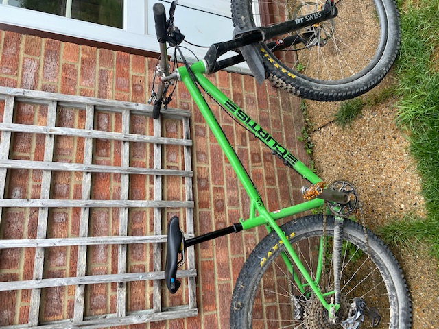

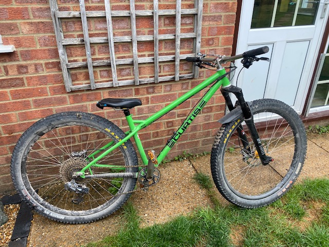

Not mine, but a bike of the laddos mate.
I had this here last week before Afan and BPW trip but i was pretty tipsy when he was here and he crashed it a few times last week.
First issue... Gears not really working... Turned out to be a loose mech hanger bolt rather than a bent hanger, which was nice.
Second.... clunky.... happily that was a shock mount bolt rather than a shock bushing
The gears were then indexed...
The rear brake had a stripped caliper pin retention bolt thread, so used a split pin on there to resolve that one.
Pulled the brakes... well, the front worked... the rear needed 2-3 bleeds to get nice
Last week it was treated to my spare pedals as they were bolloxed along with a re-tension of the DUB adjuster which was meaning the cranks were wobbling all over the place.
It'd be a lovely bike... if.... if if... someone looked after it :(
