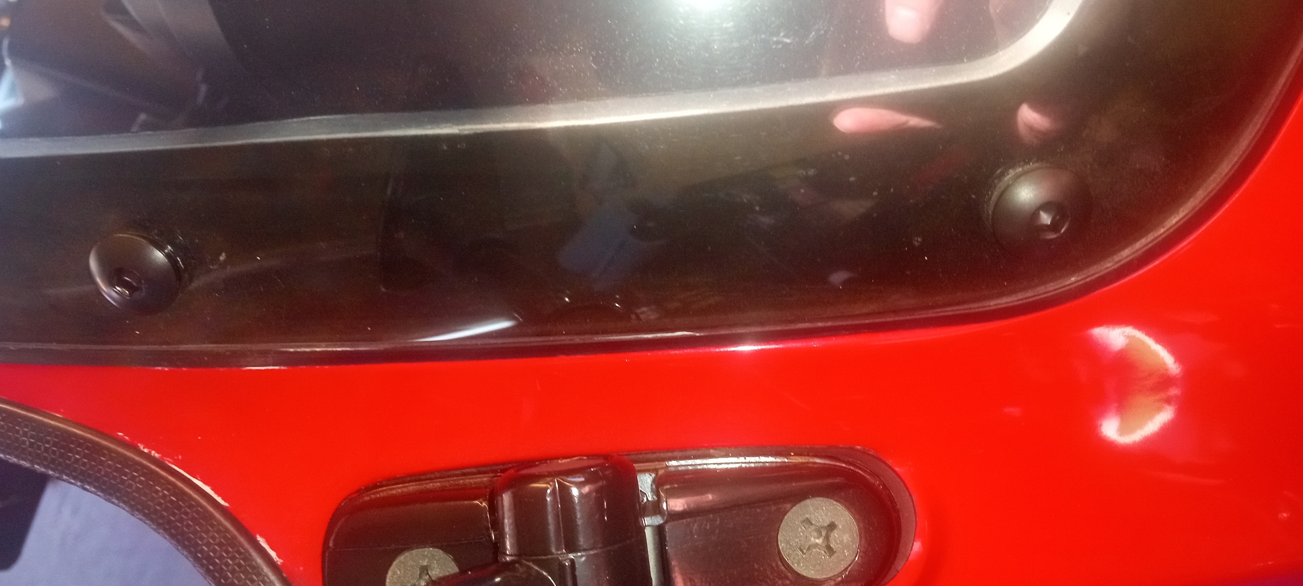

Swapped out 6 of the 7 screws on the screen for Allens. (7th weird nut will be here this week to finish that project) Ditto the two screws on each side cover.

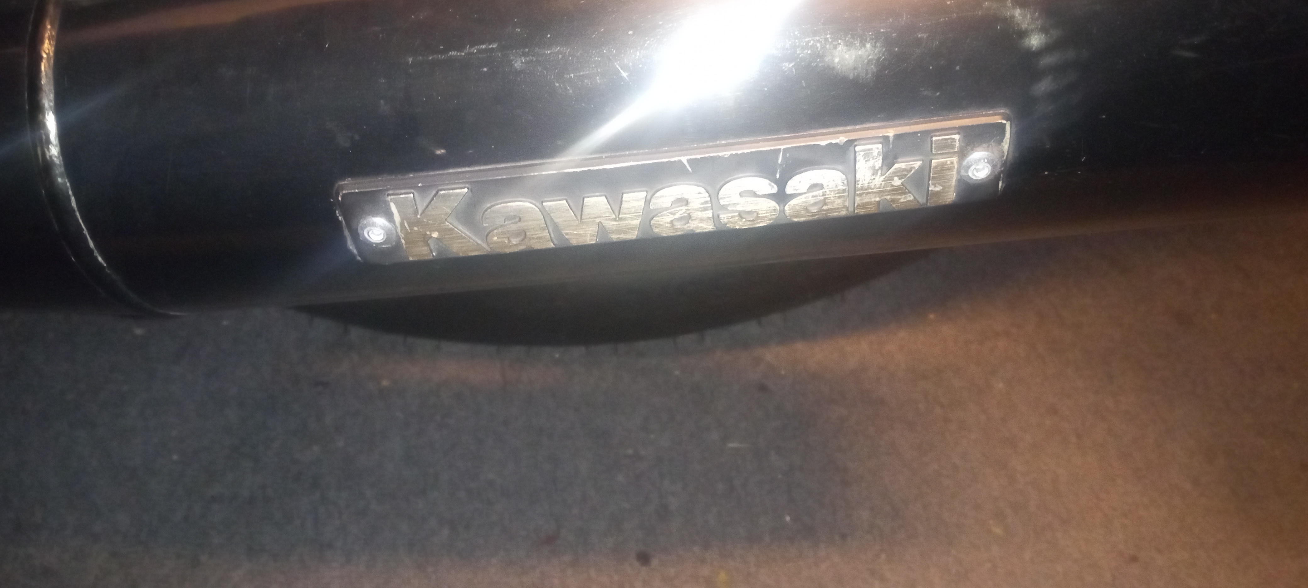

Left badge riveted back on...May add a dab of black paint (edit: naaa, fuck it.)

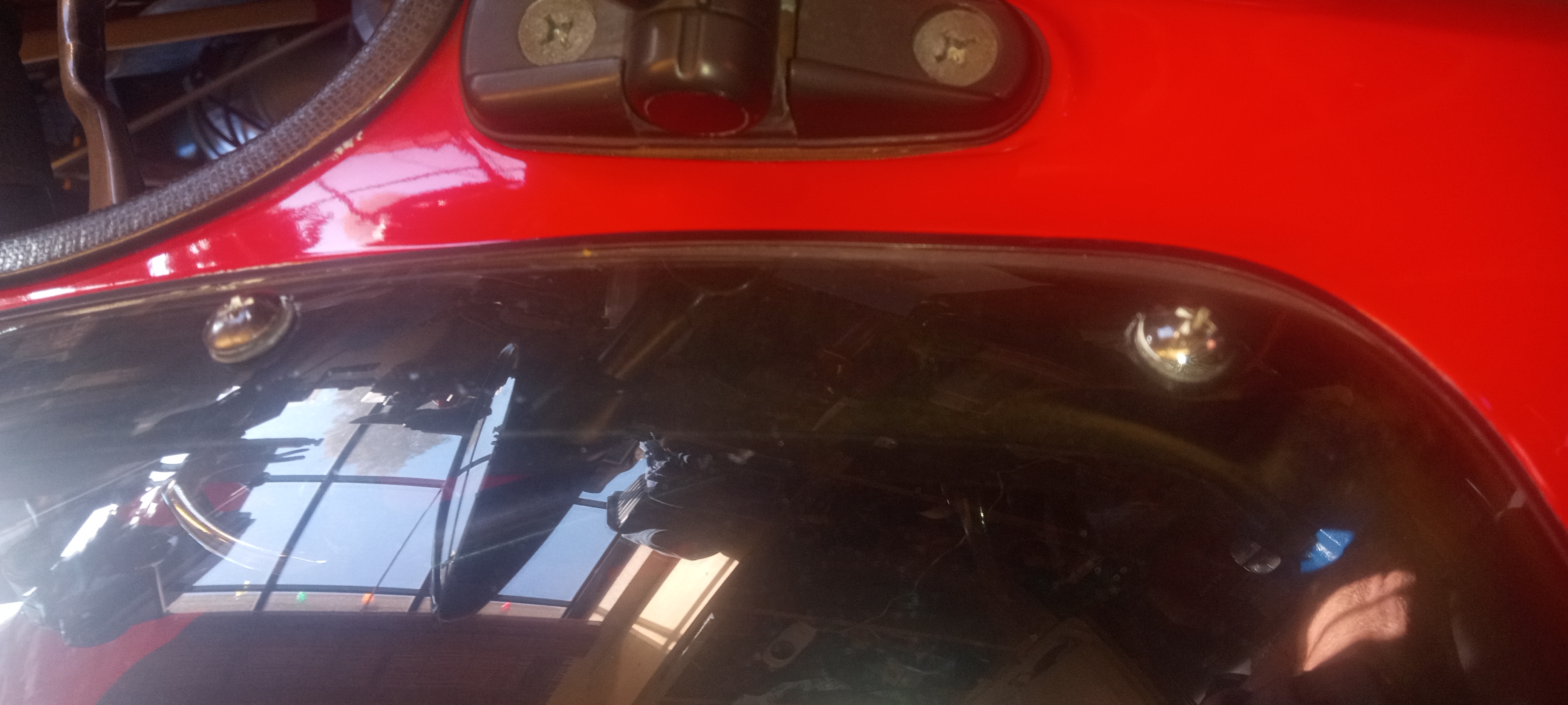

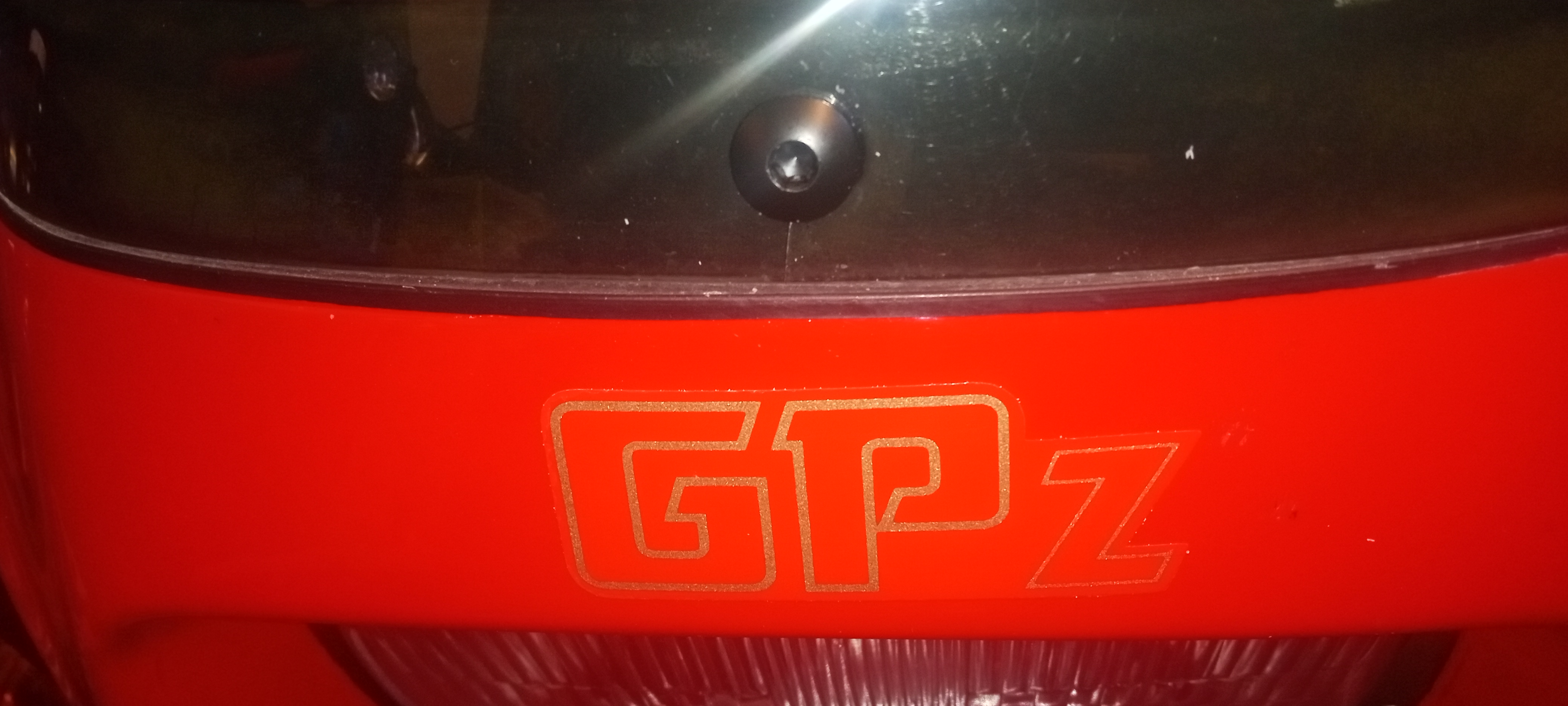

WooT! Special nut doodad arrived for the screen, so now I won't have to scrap the entire bike. Thought the original had merely fell off. Turns out the hole in the (aftermarket) screen & the hole the fairing didn't align so it hadn't been installed. I gave it some attention with a drill & now it's all copacetic.

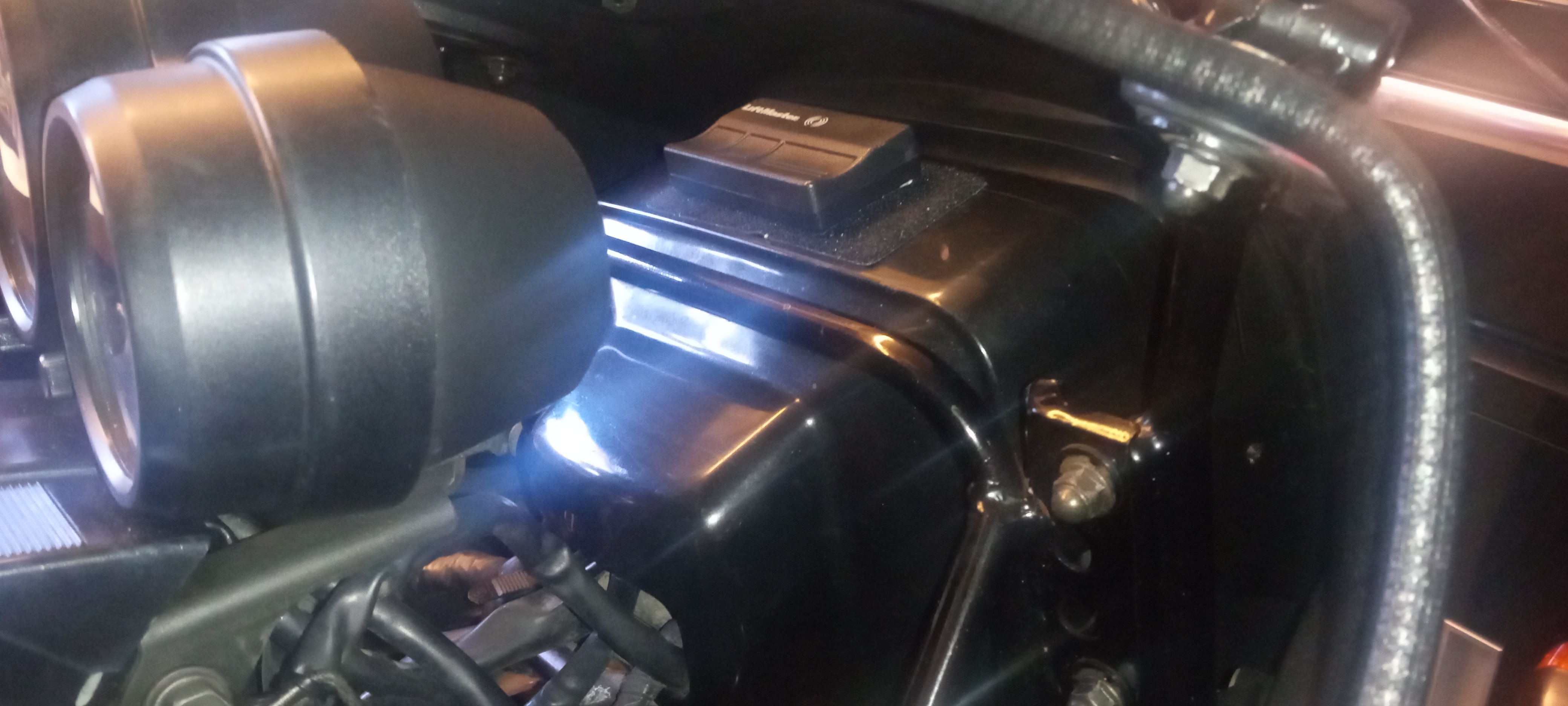

So, todays tally:
1) Turn signals
2) Muffler badge
3) Garage door remote doodad
4) Screen hardware
5) Upgraded valve stem caps from cheap plastic to blingie black aluminum.
