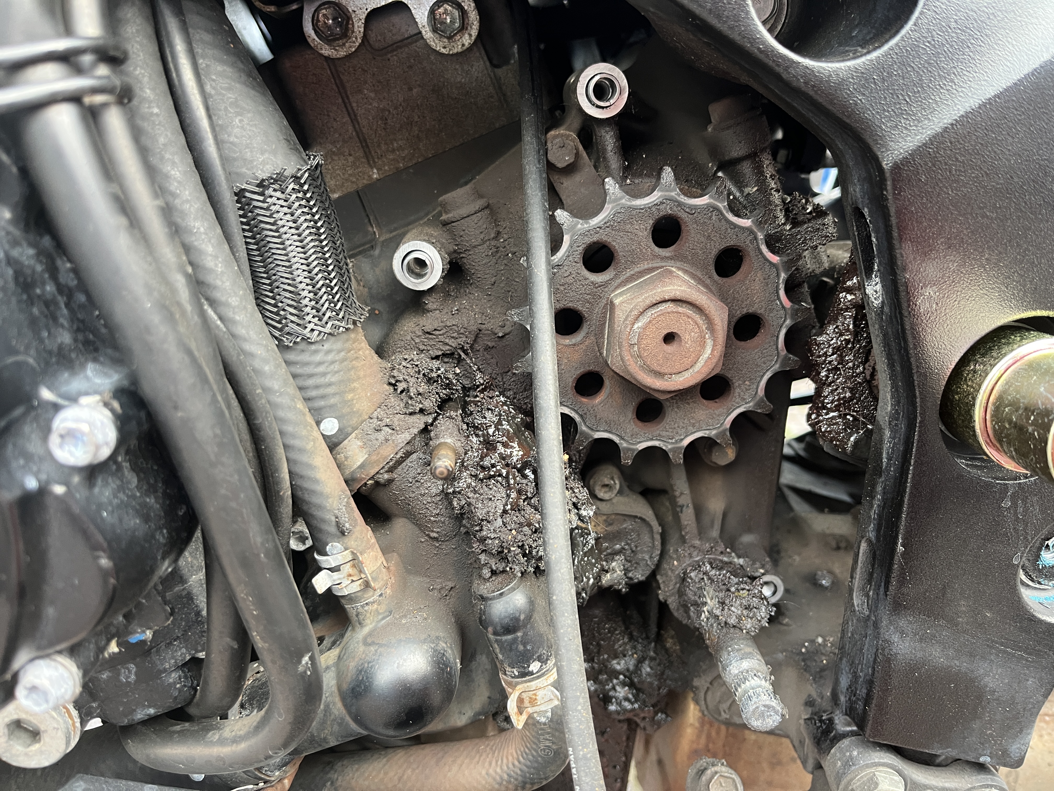

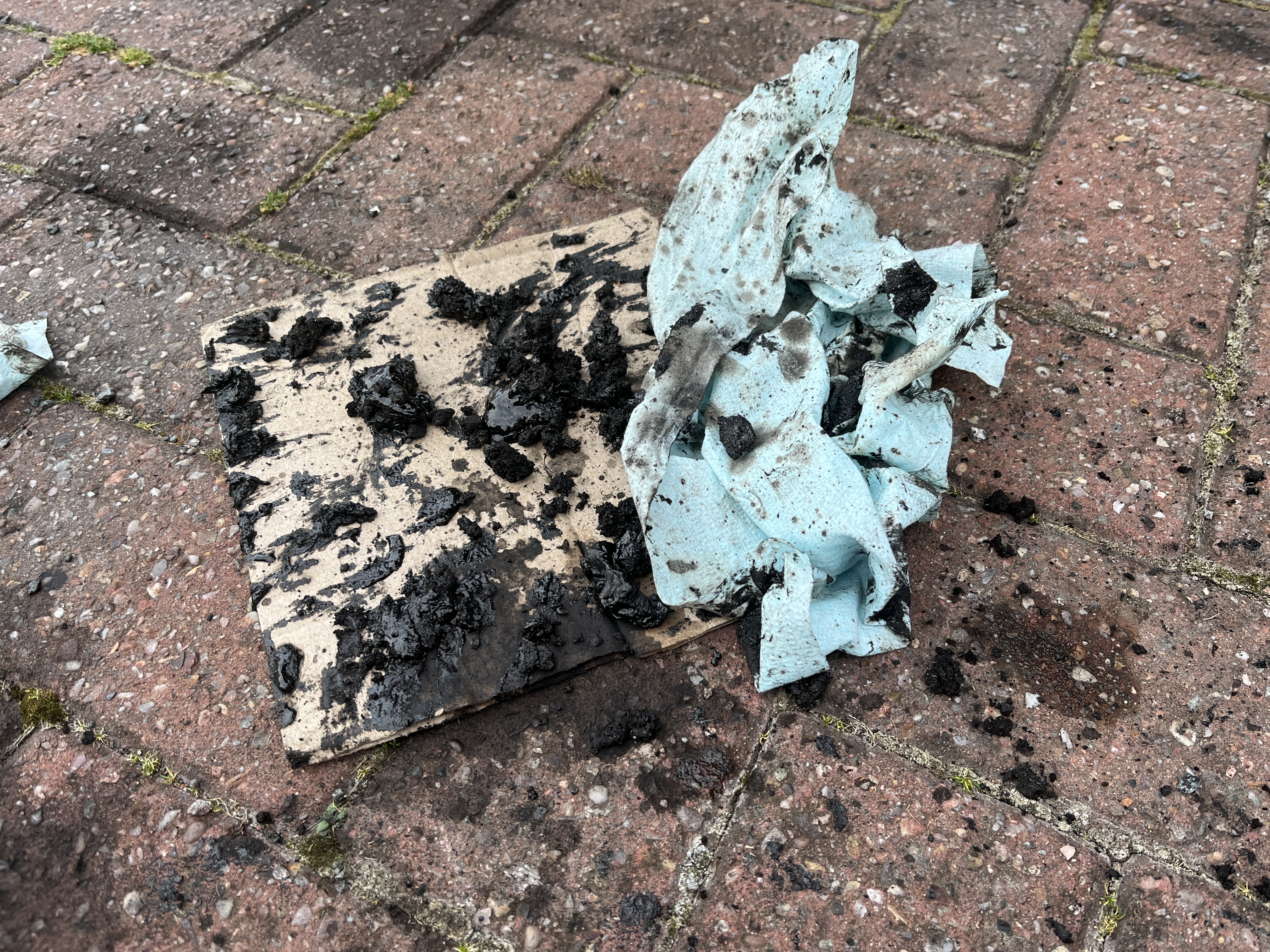

It is an absolute bastard of a job on that bike!!!Supermofo wrote: Fri Feb 20, 2026 5:35 pm Still not removed the sprocket cover to clean in there, it must be minging as hell. On previous bikes it was just a simple cover, on the Suzuki the clutch assembly is attached to it as well as the shift rod. Not sure I wanna trust myself to mess up how those are set currently, so out of sight![]()
Well, it is when the previous owner has used used engine oil as his chain lube of choice for 14k miles anyway...
Took me forever to get all the muck out of there! Was worth it in the end though...
Oh, and when it all comes apart, take care with the clutch plunger pin... Clean it thoroughly too, but get some decent grease on it before reinserting it as if it gets at all sticky it'll really impact clutch feel/use...
