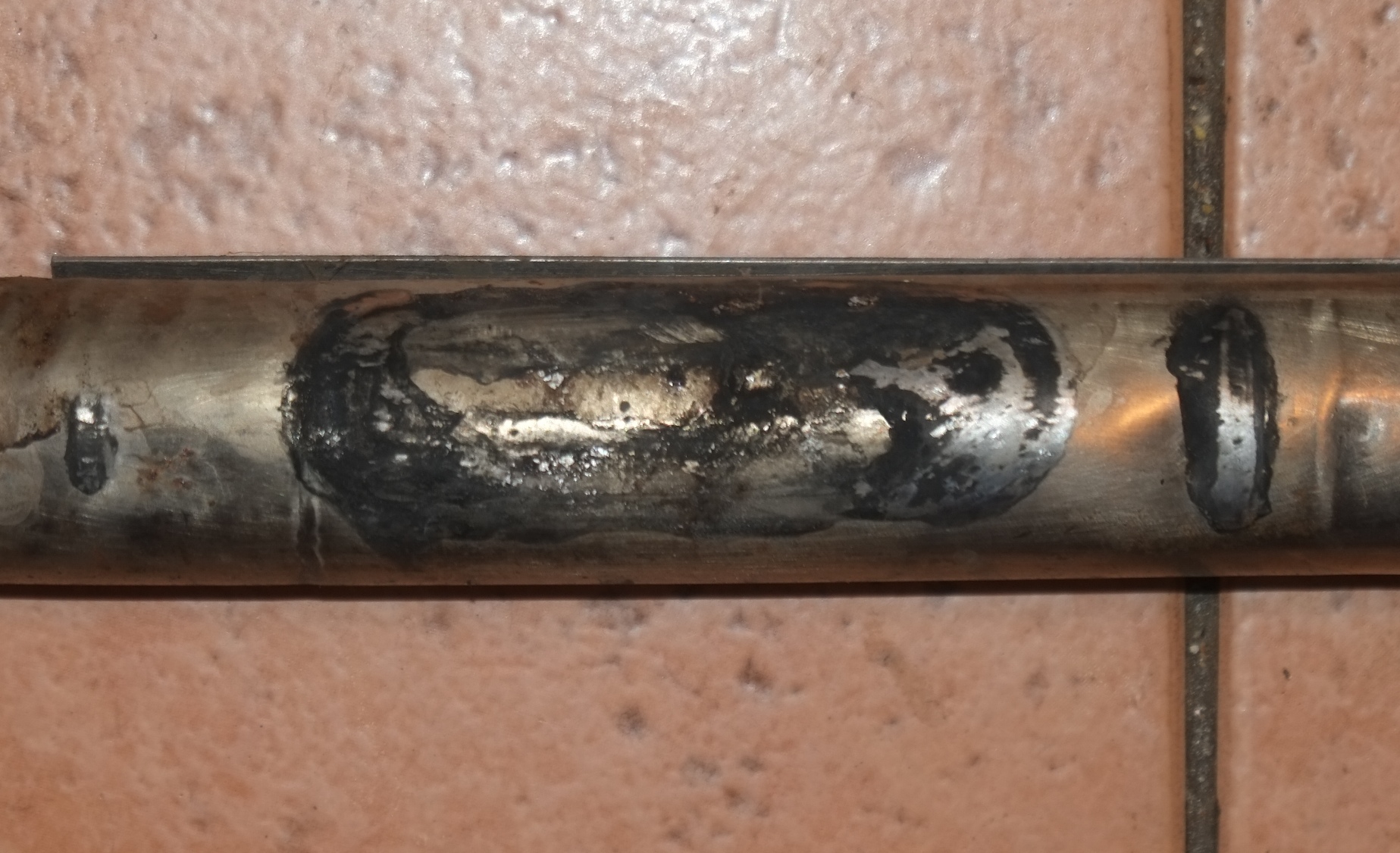

Today's my last day in France (fly back Friday morning) and so it's case of cleaning up and finishing up. I'd initially decided that I would remove the clutch slave cylinder from the bike and bring it back with me for some interrogation at HQ. So off came the slave cylinder and a substantial amount of fluid dribbled to the floor as I was doing it (clutch hose still firmly connected). This was expected, given the amount of fluid I'd been feeding it.
On a whim I pulled out the clutch pushrod and had a good look at it and about 15-20mm from the slave cylinder end there was a clear groove worn into the pushrod where it passed through the slave cylinder oil seal. Bugger - new push rod time. I did a quick check on the usual parts web sites and not only could I not find a part number, they weren't even listed on the fiches.
My initial thought was to bring the slave cylinder and push rod back with me and get my local engineering shop to make a copy of the push rod while I overhauled the slave cylinder.
Then I thought about how a couple of strange metal objects in my hand luggage would look on the airport scanners... Did you pack your bag yourself, sir? Would sir care to explain what these objects are doing in your luggage? Would sir like to step this way? Would sir like to drop his pants and bend over?
So I decided not to take them back with me. Cowardly, I know, but...
Instead I decided to simply turn the pushrod round and insert the crusty ringed end into the back of the clutch and fit the pristine, unmarked end into the slave cylinder. Hopefully the oil seal will actually seal on the unmarked shaft and harmony and peace will be restored. I'm aware I'll only be able to do this trick once...
Anyway, the clutch is all bled up and has a rubber band over the clutch lever holding it in, and I'll see whether or not I have a pool of fluid under the LH side of the bike when I return in approximately 6 weeks time.
I'm not holding my breath...

Does the clutch pushrod really seal into the slave?
In my limited experience of hydraulic clutches (Ducati and Suzuki) the slave had a piston, very much like a brake caliper, that pushed the pushrod into the clutch. The pushrods had seals to stop the engine oil getting out.l, but didn't have any slave side seal as it didn't come into contact with any fluid.
Seems an odd system on the Honda.

I think it's just Honda - they do things their way. This is an exploded diagram of the slave cylinder. There is definitely an oil seal in the back of the slave cylinder piston. Oil seal is 19, piston is 11 and piston fluid seal is 13. Whether the oil seal is to keep engine oil in or clutch fluid in, I don't know. If I have a puddle of fluid under the bike when I check next, it's probably to keep engine oil in.KungFooBob wrote: ↑Thu Aug 01, 2024 4:22 pm Does the clutch pushrod really seal into the slave?
I have a spare motor back in Sheffield, so will be getting the slave cylinder off that and having a good look inside.
