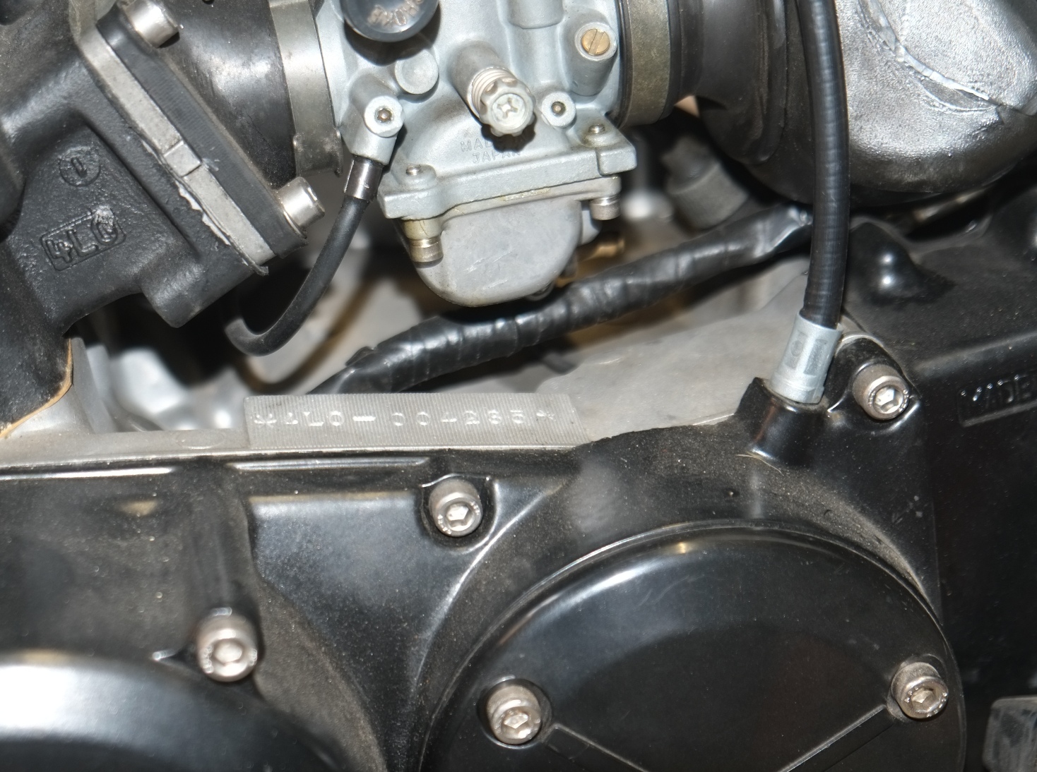

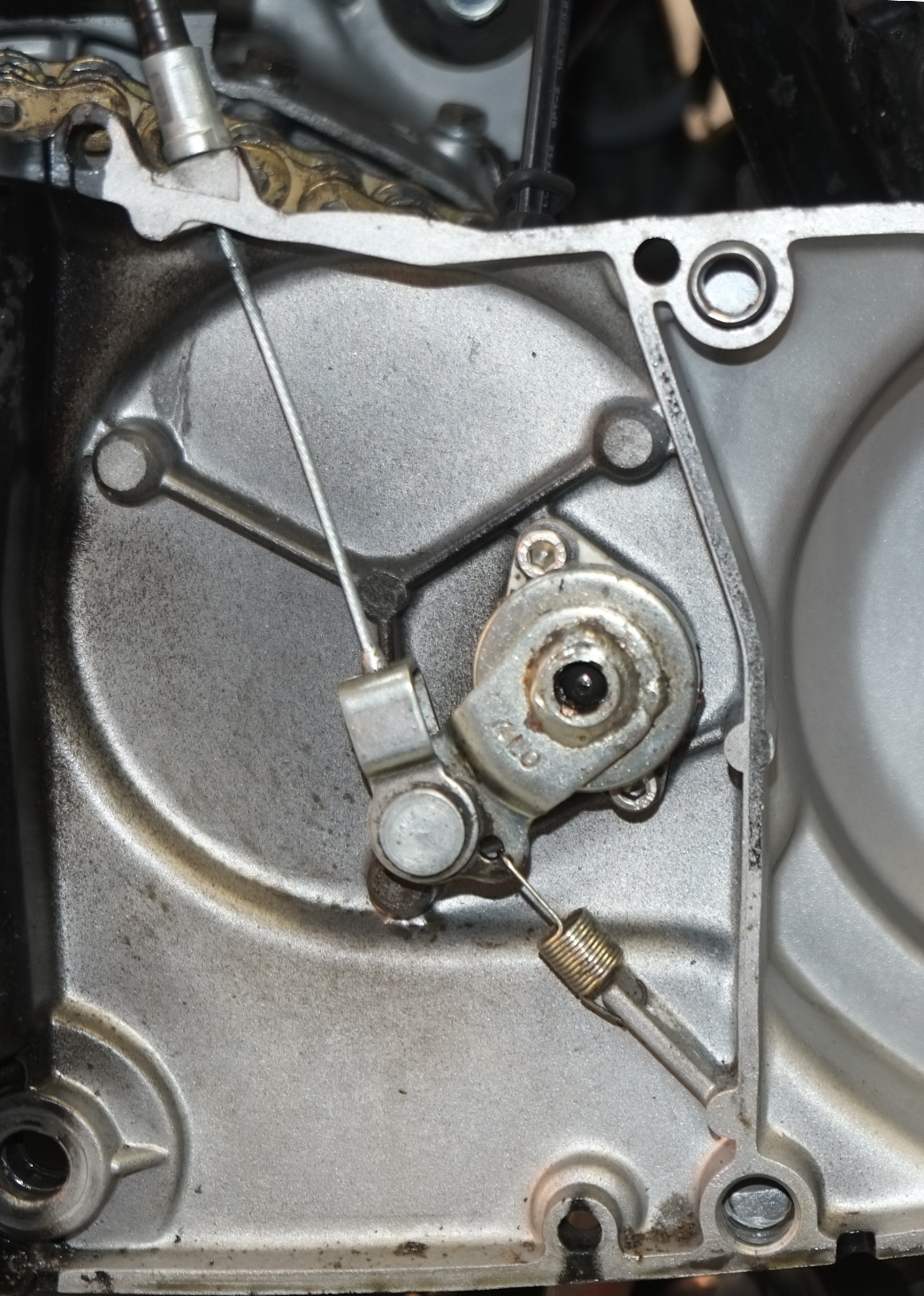

Make sure the cable is 90º to the operating lever on the crankcase.
There's virtually no scope for getting it wrong or (more accurately) not getting it the way Yamaha intended. The ferrule at the top of the crankcase cover directs the cable at its intended angle. The cable does describe an arc before it enters the crankcase cover, but it's a fairly gentle one.
When you look inside the crankcase cover and see the mechanism there's no scope for misalignment. And with the mechanism disconnected from the clutch pushrod, the cable action is so light that there is virtually no resistance when pulling on the clutch lever. All the clutch 'weight' resides in the clutch itself.
So my attention will be focussed primarily on the clutch itself. New clutch plates and springs would seem to be in order and if there is an additional plain plate it will be removed. But that can wait until weather stops play in November or December. For now it gets ridden.
