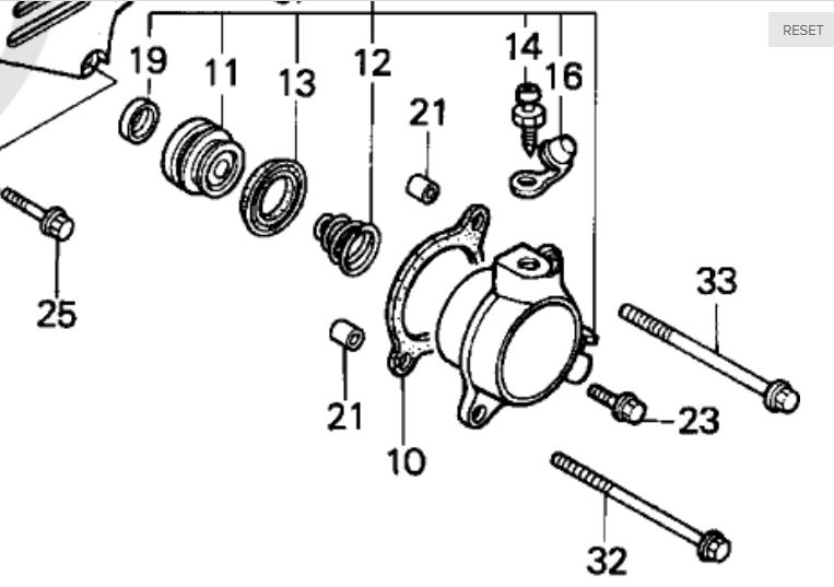

- mangocrazy
- Posts: 8855
- Has thanked: 2556 times
- Been thanked: 4167 times
I think it's just Honda - they do things their way. This is an exploded diagram of the slave cylinder. There is definitely an oil seal in the back of the slave cylinder piston. Oil seal is 19, piston is 11 and piston fluid seal is 13. Whether the oil seal is to keep engine oil in or clutch fluid in, I don't know. If I have a puddle of fluid under the bike when I check next, it's probably to keep engine oil in.KungFooBob wrote: Thu Aug 01, 2024 4:22 pm Does the clutch pushrod really seal into the slave?
In my limited experience of hydraulic clutches (Ducati and Suzuki) the slave had a piston, very much like a brake caliper, that pushed the pushrod into the clutch. The pushrods had seals to stop the engine oil getting out.l, but didn't have any slave side seal as it didn't come into contact with any fluid.
Seems an odd system on the Honda.
I have a spare motor back in Sheffield, so will be getting the slave cylinder off that and having a good look inside.
