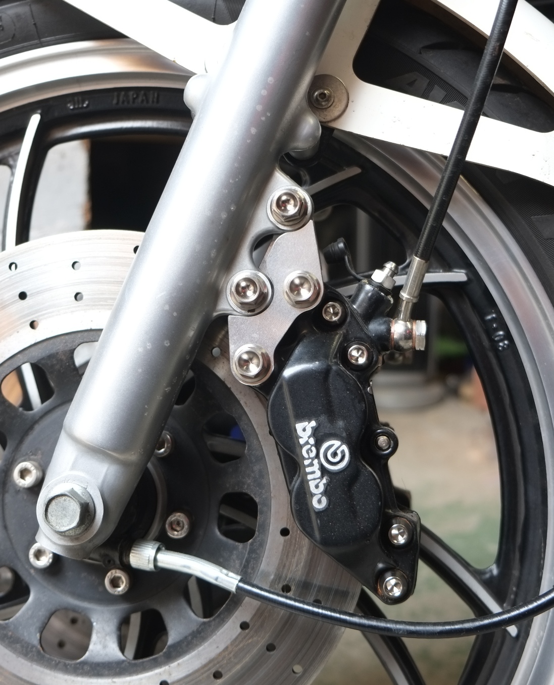

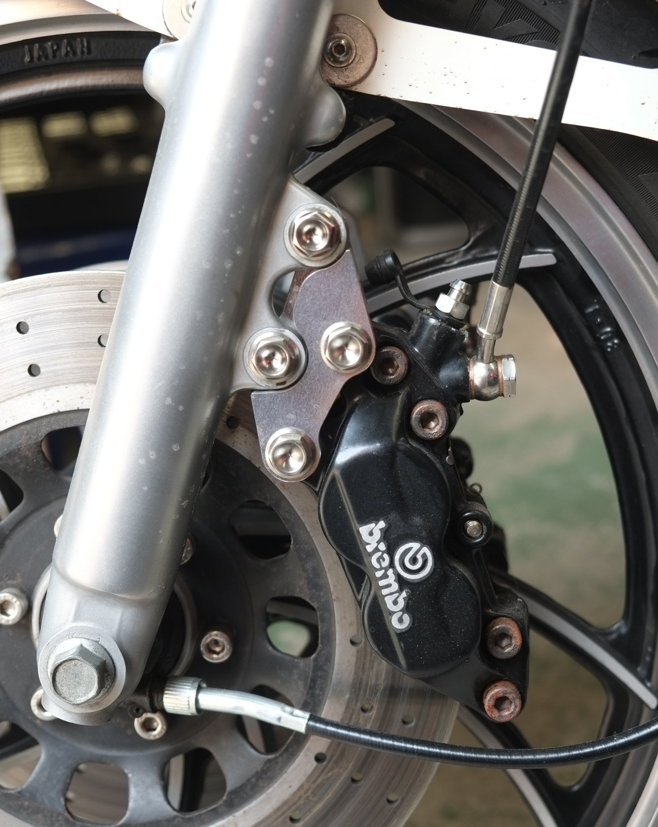

Anyway, the other day I was mooching around in the shed, getting the VFR rebuilt and ready for its MoT (next week) and I noticed with some annoyance that the black high tensile cap head bolts holding the Brembo caliper halves together on the LC were decidedly rusty. Having thought about it for a while I figured that the best way forward would be to replace the HT cap heads with Titanium ones, due to Ti's famed corrosion resistance. Nothing to do with bling, oh no sirree...
So a few days later a (surprisingly light) package dropped through the letterbox. With the package opened I was even further impressed with how light they were, measuring 8.5 grams per bolt on my scales. So today I decided it was time to fit them to the calipers. Armed with my trusty tube of Wurth CU800 (German Copaslip) I swapped all the rusty old bolts out and replaced them with the swanky Ti jobbies, applying copper anti-seize to the Ti bolts as I went (Titanium is notorious for galling and if there's one thing you don't want, it's a seized Ti bolt in a brake caliper). Here's a 'before' shot:
As I was removing the old HT steel ap heads, the difference in weight was very obvious. When I put them on the scales a steel bolt weighed 19.5 grams - a whole 11 grams more than the Ti bolts. I really wasn't expecting that level of difference. So overall weight saving was 88 grams, not that I will ever notice it while riding. Here's the obligatory 'after' shot:
Much better. Having said that, these photos illustrate that I need to wax and polish the bare aluminium fork legs, before those water marks turn into corrosion and pitting. Looking after an old bike is a constant process...
Posted: Sun Jun 16, 2024 4:57 pm
Either your fork legs are bent, or that pic was taken on a phone :D
Posted: Sun Jun 16, 2024 5:12 pm
by mangocrazy
Mr. Dazzle wrote: Sun Jun 16, 2024 4:57 pm Either your fork legs are bent, or that pic was taken on a phone :D
Neither... :) Taken on a Fuji XE-1 and fork legs are straight.
Posted: Sun Jun 16, 2024 5:19 pm
mangocrazy wrote: Sun Jun 16, 2024 5:12 pm Fuji XE-1.
Ooh fancy. We have Nikon mirrorless here :D
What lens then, cause the first and second photos seem to be quite different focal lengths...just looking at the fork leg, hence my comment :D
I assumed it was the classic phone wide angle look.
