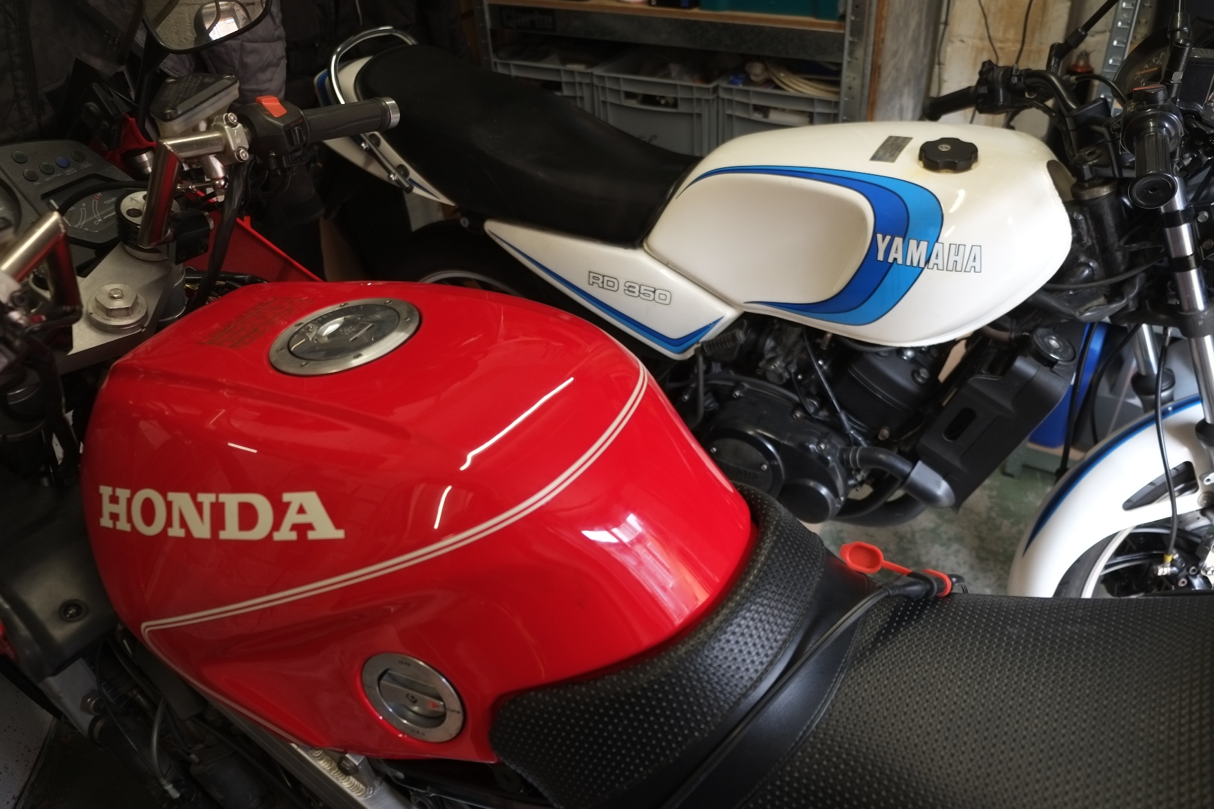

On the basis that the shed roof was frost-free for the first time in nearly a week when I looked out this morning I decided that some shed time was in order. Unfortunately my normal routine of wheeling the LC outside so I have more room to work on the VFR was stymied by it starting to rain the second I walked out of the house. So instead it was a case of trying to contort myself into shapes that really didn't befit an Old Git.
Bit of a re-cap; the reason I need to fit different exhausts is that the currently fitted exhaust collector box sticks out rearwards about 50mm more than it should, meaning it's impossible to remove the rear wheel without dismantling the rear suspension. This is clearly a nonsense; if I ever get a puncture while out and about I would be completely unable to fix it.
The reason why the collector box is misplaced is because I fitted a set of Motad stainless downpipes to replace the OE steel ones that were nearing the end of their life. Replacement OE systems have been NLA for 10-15 years, so when I bought the Motad downpipes I thought I was making a smart move. Unfortunately I didn't buy the matching Motad collector as I already had a couple of OE ones squirrelled away. But as I later discovered, the Motad downpipes do not play nice with the OE collector. By the time I'd discovered this Motad had very inconsiderately gone bust and ceased trading.
In the longer term (assuming I keep the bike) I will need to get a replacement collector box made up (preferably in stainless) that has an overall length reduced by 50mm from OE. But as this will take some time and I have a spare aftermarket exhaust cluttering up the shed, that's what will get fitted. But first I need to remove the current exhaust system back to and including the collector box. This is what the RH side of the exhaust system looks like:
And this is what things look like at collector box level:
And with the RH can removed from the collector box, here's a close-up of the ridiculously small current clearance between tyre and collector box - there can only be about 10-15mm tops.
Before I can get the collector box off I'll need to remove the swingarm to linkage bolt, so I can lift the rear wheel up and give enough rearward clearance between tyre and collector box. And for that I really will need to punt the LC outside and have room to swing a cat (or a skylift). Maybe tomorrow?
