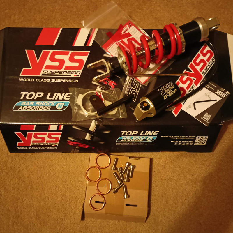

Just got home and postie has dropped off a couple of packages today- yum-yum and cheers @Couchy 8-)
I doubt the Bandit will get any attention for the next couple of days as tomorrow is a day of sawing/chopping and stacking logs followed by some essential maintenance on the orange bike ahead of a day out on the lanes of West Berks and Wilts on Friday, but the plan is that it'll be full steam ahead on the old girl this weekend :thumbup:

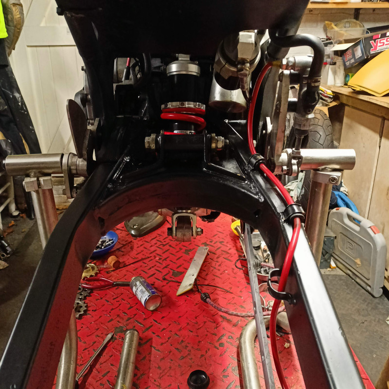

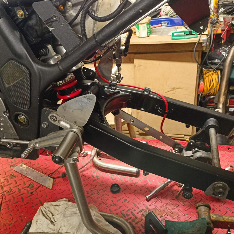

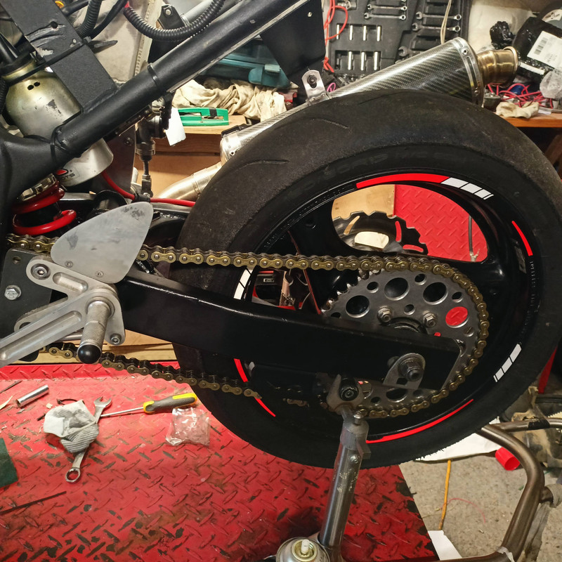

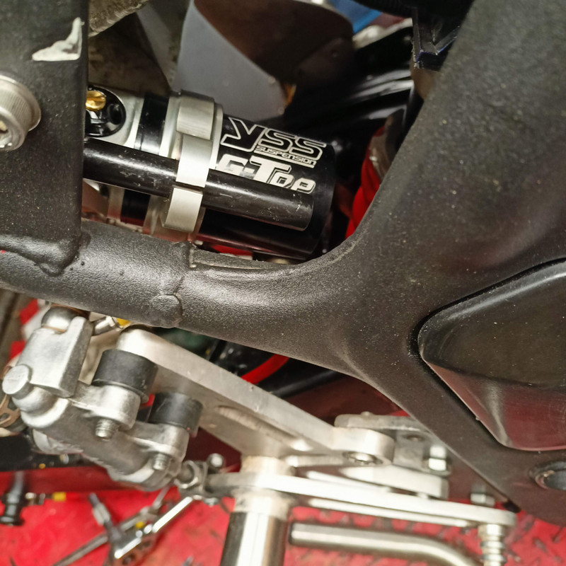

The swinging arm and nice spangly new shock are now back in, and a bracket mounted to secure the remote reservoir that still allows me to get to the damping adjuster easily.
Everything on this bike has been pretty grubby including the rear brake caliper, so that’s had a bit of a cleanup, and as soon as new pads arrive, the rear wheel will be going back in with a nice spangly gold race chain for good measure.
I’ve also re-fitted the exhaust system, and of course fired it up- unfortunately it still ran like a dog, taking far too long for revs to drop when you closed the throttle and not ticking over when it eventually did die down, so off came the carbs again.

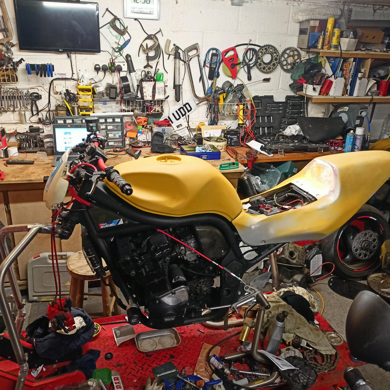

Quite a lot of activity on the old girl over the last week or two, and I’m 9/10 ( or probably more accurately, the bike is :D ) ready to race, yay!
So what have I done?

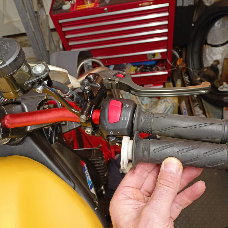

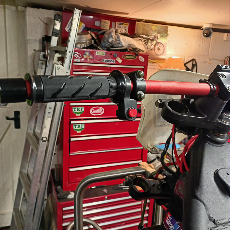

We have a quick-action throttle ! 8-)
In keeping with the budget/team thrifty nature of this project, rather than waste the cost of a tyre or more on a nice blingy one, I’ve replaced the OE Suzuki throttle tube it was wearing with one from a 2017 R1, which until a couple of months back I’d had on my ZX6.
It just needed a small amount of metal removing from the standard Bandit RH switchgear housing and the outer end of the “pull” cable as the part of the tube that the cables sit within is a larger diameter and snagged a bit, but Mr Dremel sorted that out in no time :)
It’s a nice easy and cheap upgrade that has reduced the amount of throttle travel from the best part of 180 deg to 90, which of course was the main objective, and has allowed me to keep the standard RH switchgear and use standard length cables.
The forks are also now back in ( albeit wearing the same slightly tatty paint they came to me with), and it’s sitting on it’s wheels for the first time since I bought it.

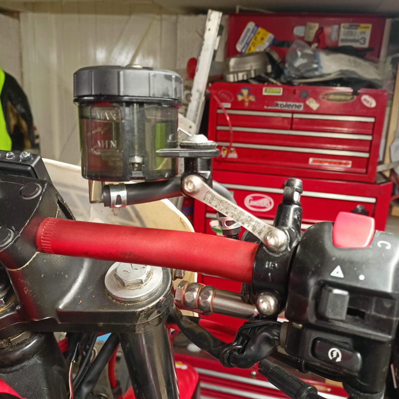

I’ve also fitted the M1000RR front brake master cylinder ( with one of WavyDave’s nice little stainless reservoir brackets) and bled the brakes up.
I was wondering if this MC may be slightly too large a bore with the relatively low fluid capacity two-piston standard front calipers, but lever feels nice which bodes well, but I’ll only really know once I get it on track and start using it- if it is a bridge too far, then the (far less blingy) ancient OE one will go back on
I’ve also replaced the monstrosity that was the previous shark fin with a much more aesthetically pleasing cast black one, and drilled and tapped the underside of the swingarm to properly secure it- a definite upgrade over the self-tappers that the old one was (barely) attached with
And how it looked before, just for comparison- lovely eh :sick:
It also now has a rain light, wired into a switched power source with an extra little switch on the seat unit so it will only go on when it rains
And the tank, front mudguard and seat have been rattle-canned by me, which I’m not happy with either in terms of the colour combinations I’ve used, or the quality of finish, but well, as my brother Mart said, there will definitely be worse-looking bikes on the grid and I suspect he’s right, so it’s now painted and will start the season how it is now.
And now that the tank and seat etc are painted and on there I was able to run it down to my local friendly dyno men this morning to see how it ran, or of course didn’t- It was a good day and spent a very pleasant couple of hours chewing the fat with Gav and Dan and the bike didn’t disgrace itself either 8-)
I won’t be posting the dyno graphs online (walls have ears and some people don’t need to know how much it is or isn’t making :silent: ;) ), but suffice to say I am very pleased with its performance- the motor picks up nicely, is fit and healthy and not using any oil, and nothing fell off or went bang either :thumbup:
We did a good few runs with the baffle / Db killer in and out, with only a 2hp difference at peak with the baffle in, which is great, and quite unexpected, but I guess it is a fair-sized can for a relatively weedy motor.
An interesting bit for me was that it was a little rich (A/F of 12.5-12.7) towards the top end so if I were inclined, there’s potentially a little more power to be had by going back down to standard-size main jets, but I’ll not be doing that as it’s making decent numbers and there is a lovely pretty much flat peak from 10 to 11.5k

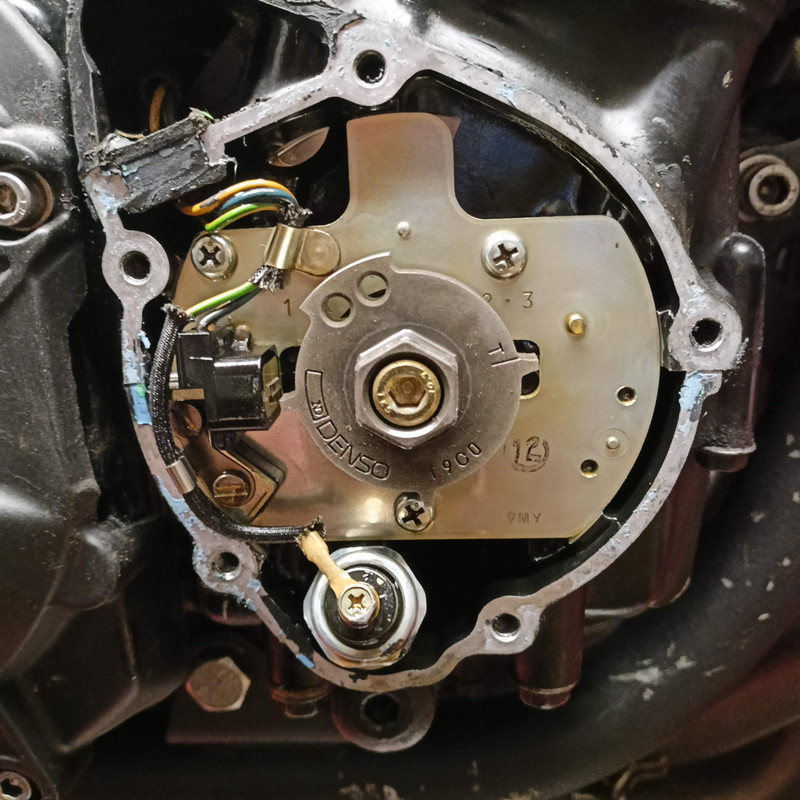

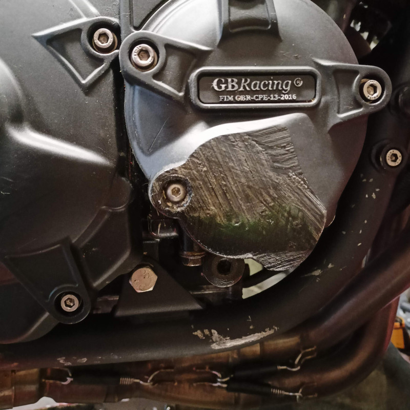

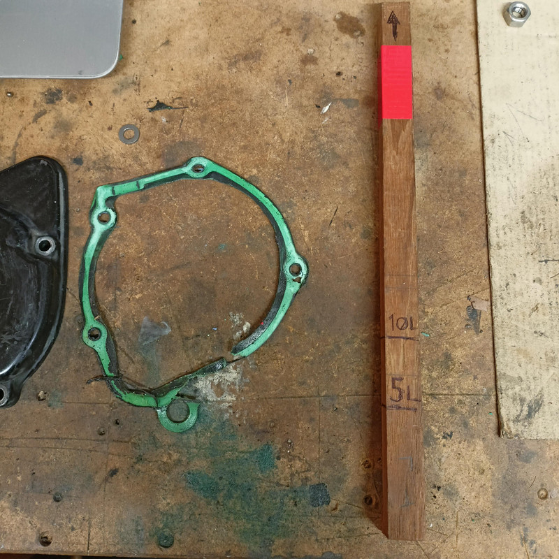

Sort a small oil leak from the ignition pick-up cover which we noticed at the end of the dyno sessions- at first I thought it may have been a cracked engine case as it is showing a bit of crash damage there
But on removing the cover, I can see there is no damage, and it is just a badly re-fitted gasket, it needs the gasket faces cleaning up and the (broken and bodged up with silicon) gasket replacing and the job’s a good ‘un.
One advantage of taking the cover off is that I was able to see that the motor is running the OE ignition rotor, which is good, as any non-standard ones ( the ones that advance ignition by 4 or 5 degrees apparently give really good gains on the 600s) are illegal, so is nice to know I’m legal

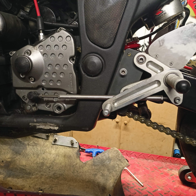

I also want to change it to race-shift pattern for which I need to either turn the existing lever over if it’s possible, or if not, obtain an angled linkage boss for the gear change shaft so it will clear the bottom frame tube

Can you just turn over the bit of the gear linkage that clamps to the gear change shaft (I'm not convinced that makes sense but I know what I mean)
Tricky
Posts: 1819
Location: Chilterns
Has thanked: 2564 times
Been thanked: 2680 times
Re: NBT- I'm going racing 😳
Post by Tricky »
Le_Fromage_Grande wrote: Tue Feb 06, 2024 9:34 pm Can you just turn over the bit of the gear linkage that clamps to the gear change shaft (I'm not convinced that makes sense but I know what I mean)
No, as I mentioned above, it would foul the lower frame tube so I ideally need to find a suitable linkage shaft clamp that has an outward offset to enable it to clear the frame tube, albeit no luck finding one so far.
Something like this would do it if it had a different spline pitch- Suzuki seem to use a coarser pitch than everyone else which is annoying as all the Suzuki versions of this I can find are straight down like my current version, i.e don't have the required offset
Anyway, we will overcome- probably with something like a lever from an old Suzuki shopping or trail bike with a bit of heating and bending, the toe part hacked off and a rose joint added- that would do it :)

One mod we used to do on the GSXR 600’s 750 and Thous etc of the k6 era was fit the R6 2c0 throttle tube as that reduced the throw from 90° to 60°, best mod for £20 or so, you have to dremel out some material from the switchgear housing the throttle cam to clear everything but that doesn’t take long.

wull wrote: Thu Feb 08, 2024 12:21 pm One mod we used to do on the GSXR 600’s 750 and Thous etc of the k6 era was fit the R6 2c0 throttle tube as that reduced the throw from 90° to 60°, best mod for £20 or so, you have to dremel out some material from the switchgear housing the throttle cam to clear everything but that doesn’t take long.
Yup, sounds the same as what I've done, massive difference to the throw :thumbup:
Dunno how the previous guy raced it with that throttle :think: - standard Bandit ones twist a looong way !

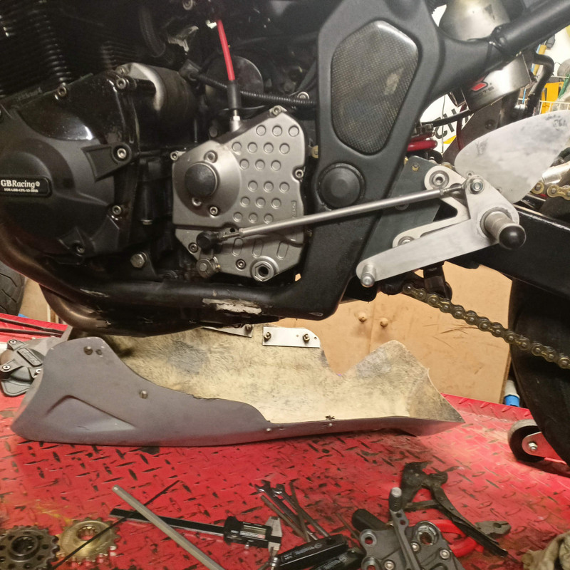

A little bit of an update on this in case anyone is interested – race shift is now sorted :thumbup:
It all ended up being straightforward as the boss on the lever pressed out easily and there was still clearance for the rose joint inside when I turned the lever upside down, so although we don't have the (pretty?) milled front face of the lever showing now, we are all sorted
Before (road shift)
And now- (race shift)
When that was done, I set about trying to sort some proper mounts for the belly pan- as I previously mentioned, it’s been secured with cable ties only to date, which I guess is fine if you use enough cable ties ( and have a good stock to replace them for when you remove and refit it), but it’s less than ideal IMO as it means the fibreglass of the belly pan itself it pulled hard against the frame tubes/engine cases, with the obvious resultant chaffing/wea, and well, it’s also just a bit shit too IMO.
The ideal solution would be to weld a few brackets to the bottom frame tubes and river Dzus sockets into them, but mainly as I don’t have a MIG welder I took the quicker/easier (for me) route and have fixed it by nuts and bolts.
Basically, to do that I’ve replaced two of the front engine mounting bolts with studs to provide the front two mounts and used some stainless steel and rubber P-clips at the rear- it meant that I had to make a couple of little ally brackets and it is a little Heath-Robinson, but the important things (to me) are that the belly pan is now completely secure and not in contact with the frame tubes, engine, or exhaust downpipes, and is easily removable in a couple of minutes by undoing a few nuts :thumbup:
Tomorrow or Saturday the belly pan will get paint to match the rest of the bike, and I think we should then be just about ready to roll - a track day is booked for next weekend for the shakedown/set-up ( in addition to the bike, and I’ll be also shaking down new leathers and lid etc) , so will report back after then- wish me luck for decent weather eh 🤞🏻 :1
