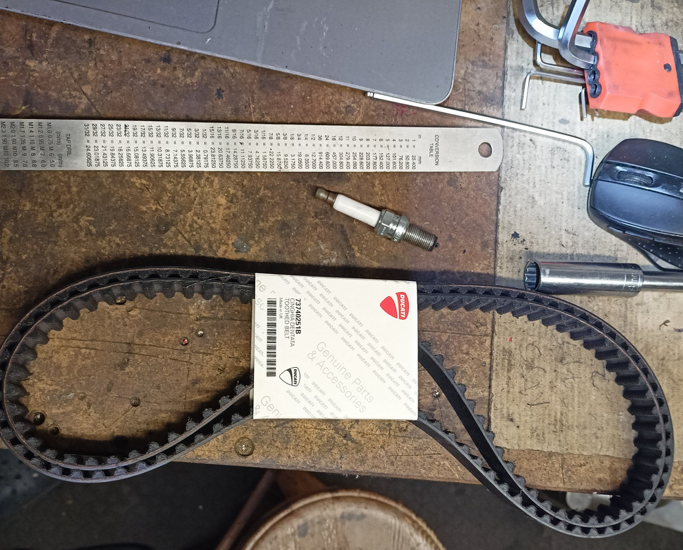

So I ordered a pair of genuine Ducati belts and the few other service bits needed, and started to have a little read of the manual, as although I’ve changed countless car cambelts in my time, I’m a Ducati virgin in this respect.
First thing that I noticed when the belts arrived (apart from the extortionate price compared to your average run-of-the-mill car
), was that they are made in the UK!

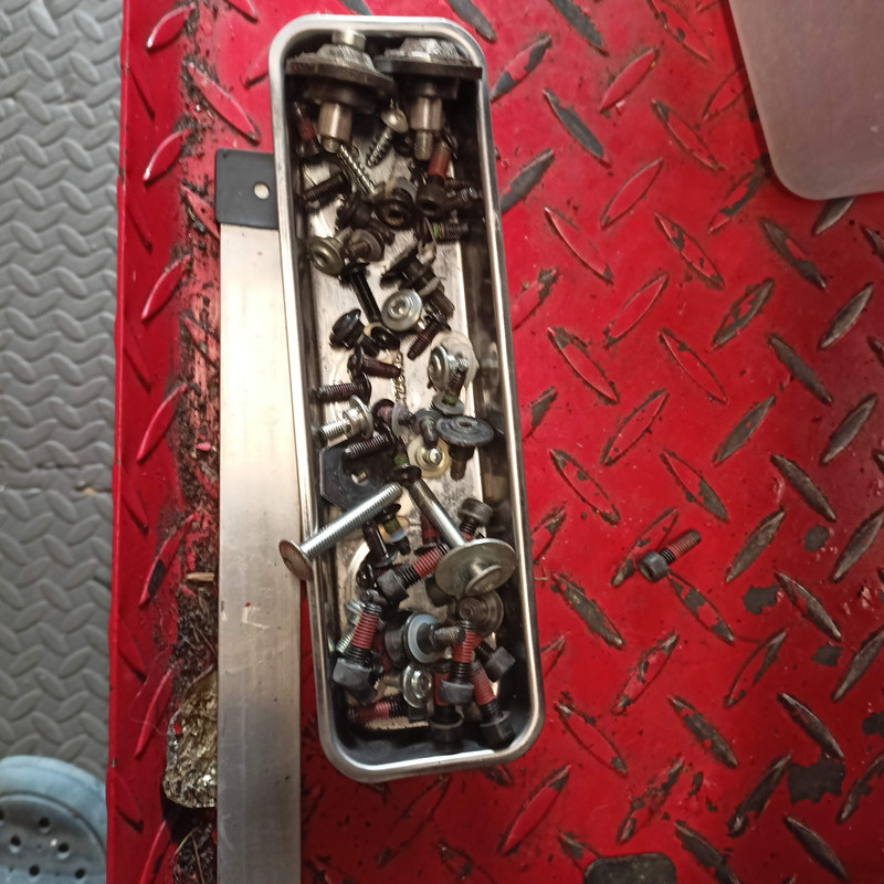

As I know at least a few of you on here will know from experience, changing the belts is very simple and straightforward, but, I guess perhaps daunting to some due to the consequences if you get it wrong.
The key things to concentrate on are (of course) ensuring that you get the cam timing and tension of the new belts right, but before we get to that point, on a Multi, to get to the rear spark plug and rear belt cover you need to remove pretty much all the body work and tank, and what a fecking faff that is
Although it’s only effectively half-faired, that is made up of a large amount of panels, and an even larger amount of screws and bolts- all these!
Without doubt, it will get easier after you’ve done it once or twice, but removing everything I needed to for access and putting it all back together afterwards was, I reckon, at least 80% of the time it took me to complete the whole job, and I imagine also the reason that belt changes / desmo services on these are so expensive.

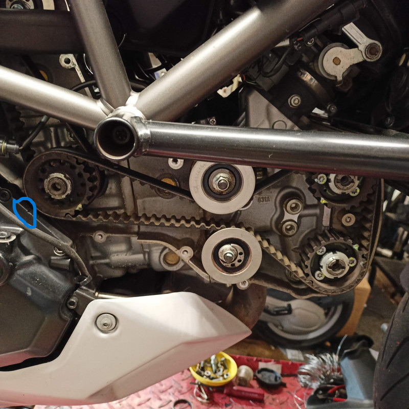

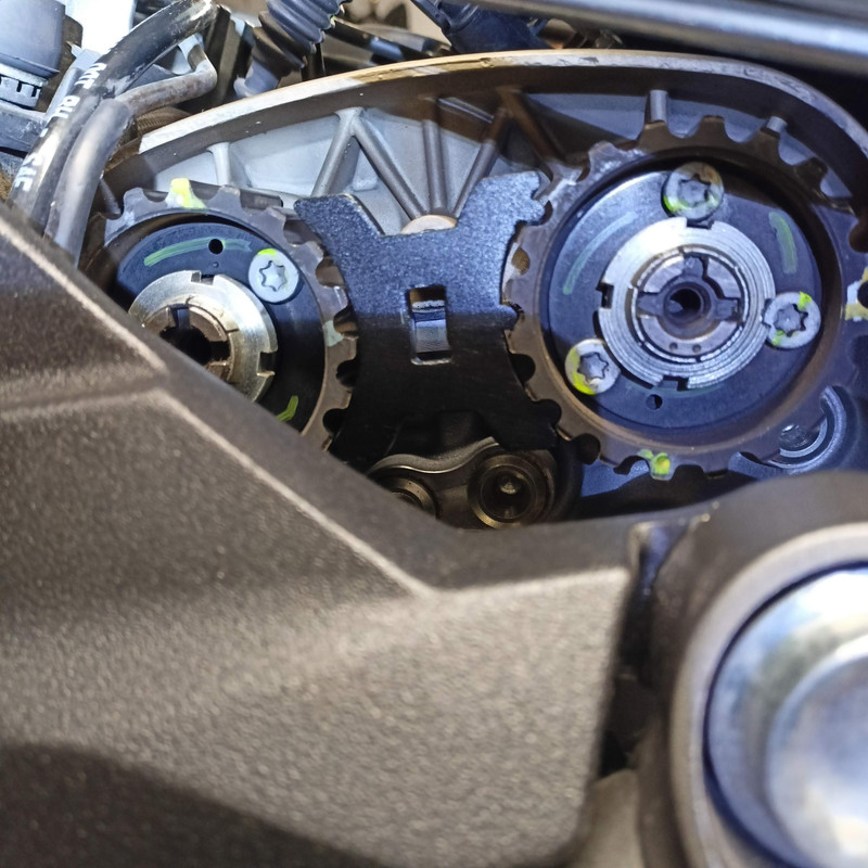

Anyway, once all the panels and belt covers were removed, I removed the plugs and rotated the motor to TDC on the compression stroke on the horizontal cylinder - there is a mark on the crank pulley and a (very small ) indent on the case- it’s not at TDC in this pic but the mark is inside the blue squiggle.
As there are none of the usual valve springs in this, and almost all other V-twin Ducatis, the cams are easy to rotate with the belts off and it’s not essential to lock them in place before removing the old belts, but I did invest in a cheap 3D printed device to lock the position of the inlet cam on the vertical cylinder, as that’s the only one that springs back a few degrees when the belt is removed.
Once I had it all lined up, as an extra little “ make sure I get the cam timing right” check, I marked up the outer edge of the old belts and cam and crank sprockets with a paint pen before releasing the tensioners and removing the belts.

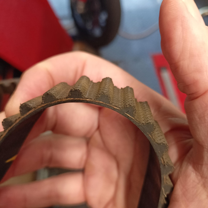

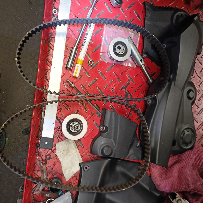

As far as I could see, the belts looked absolutely fine, with no real visible signs of wear or degradation, which makes me question Ducati’s change interval, but well, £130 for a pair of belts is a lot less than a complete replacement motor eh!
And when the belts were off, I marked up the new belts exactly as the old ones, like so.
I then put the new ones on, of course taking care to make sure that all my paint marks lined up everywhere, and fitted the tensioners, making sure that they were the correct way up- it is possible to put them on the other way up, which still allows you to tension the belts fine, but I’m guessing isn’t a good idea as the action of the belt pushing on the tensioner when its running would be acting anti-clockwise on it, i.e. trying to loosen the locknut rather than tighten it.

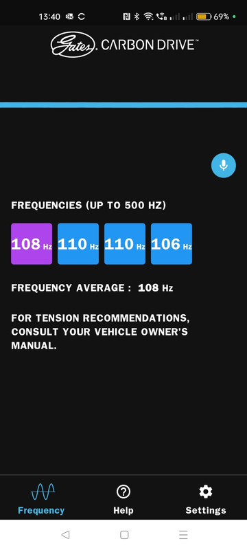

After turning it over for a few revolutions, I then set about accurately tensioning the belts, which is, I think, the area that scares lots of people, and having done it now, I can understand why, to some extent at least.
It’s because you tension it to twang at a particular frequency, rather than to have a specific mm of deflection possible. There is an official Ducati tool / dB meter for the purpose, but I just downloaded the Gates Carbon Belt App onto my phone and used that.
Now I what I found was that the frequency reported, was greatly dependant upon how I twanged it, and it took a fair bit of practice ( and a sore finger) to get the reading consistently repeatable- whether it would be any different with the official Ducati dB meter, I can’t say, but I seriously doubt it, as the variable is definitely the twanger, as it were
Anyway, we got to a point that I was happy with (spec is 110Db +/– 5 or so), which is approx 5-10mm deflection possible, and based on my previous experiences with car cambelts, it felt OK to me, so I left it at that

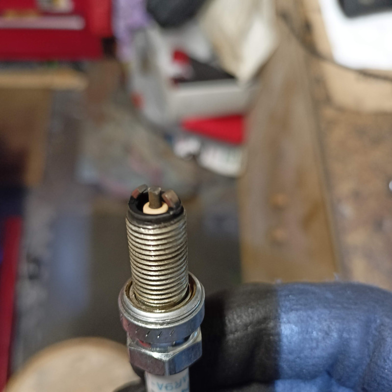

I then had a good look at the plugs- I hadn’t bought new ones as the bike has still done under 12k miles from new and was running fine, plugs looked fine to me so they went back in.

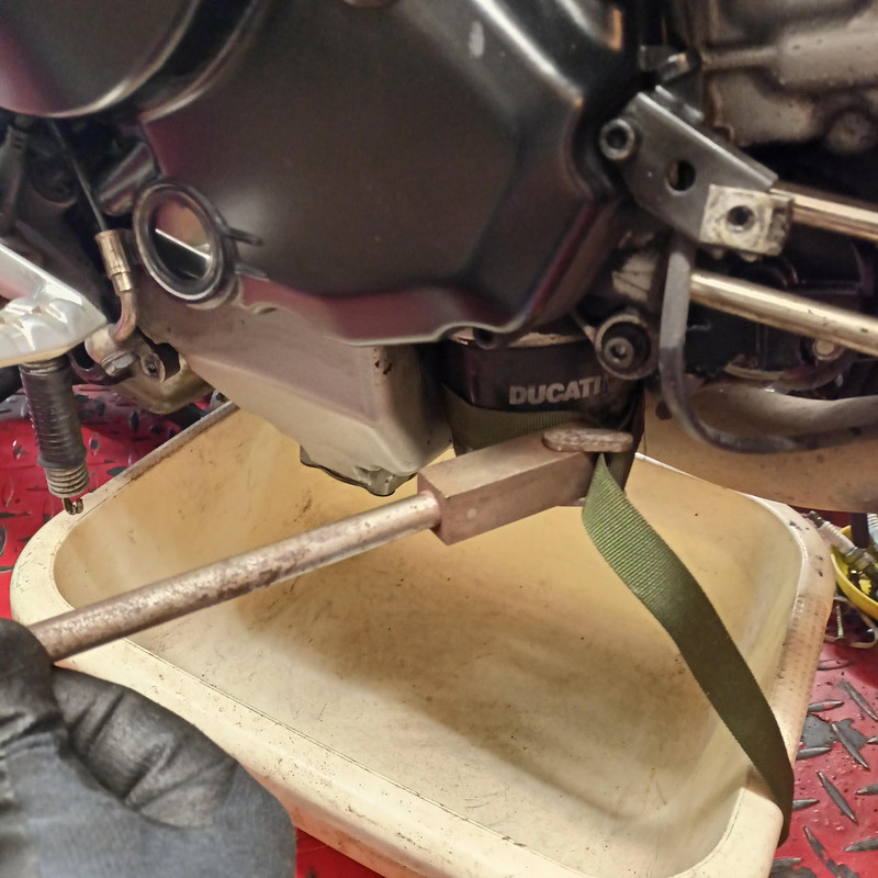

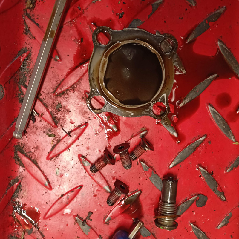

One thing that’s slightly annoying on these is that to change the filter, you have to remove the belly pan, for which you have to remove the centre-stand first. Not the end of the world, especially if you have a rear-wheel paddock stand, and it all comes off and goes back nice and easily.
Oh, and whenever I’ve changed the oil filter on this bike it always makes me smile a bit, as neither of my ½” filter sockets fit it, so I use a strap wrench- not just any old strap wrench, but this one, that Fin, my youngest boy made as part of his basic mechanical apprenticeship training at Lyneham when he was in the Army [proud Dad]
Evrything was all good, with no visible debris on the sump plug or screen, so I nailed it back together with a new sump washer and filled it up with Shell fully synth, secured the tank, and over a period of a further couple of hours, got all the fairing etc back together.
Before putting the belt covers back on, I then popped the tank back on and ran it up to temperature and re-checked belt tension, before changing the oil and filter, and this time also removing the screen in the sump to check and clean it.
I then took it out for a road test to check all was good and there were no leaks, which of course there weren’t, and we were all set for our next little adventure across the channel
