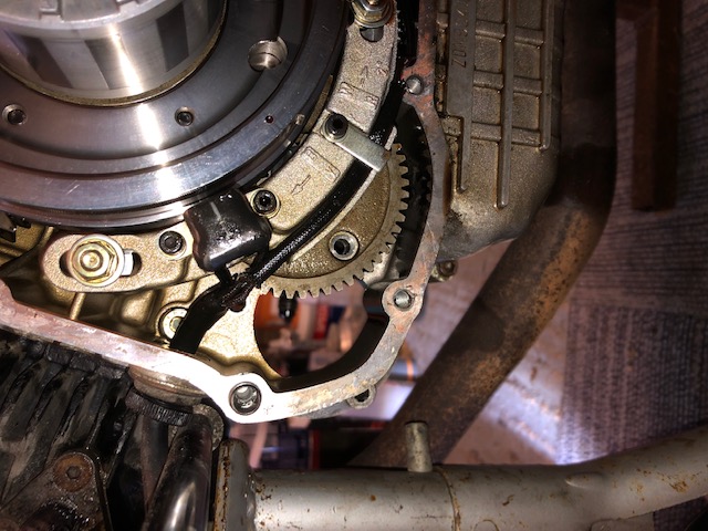

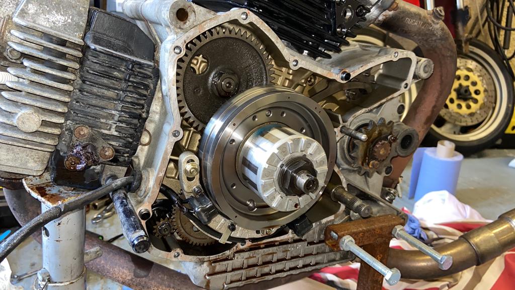

First minor delay of the project today, but it's been pretty plain sailing to date so not unexpected. The wire attached to the starter motor terminal refused to come off. No matter what. I guess an exposed position at the front of the engine & 25 years of road crud can do that.
Off with the starter motor then but this involves removing the left side crankcase cover in order to get access to two of the mounting bolts
900ss alternator casing close up.jpg (105.5 KiB) Viewed 976 times
900ss side view.JPG (125.69 KiB) Viewed 976 times

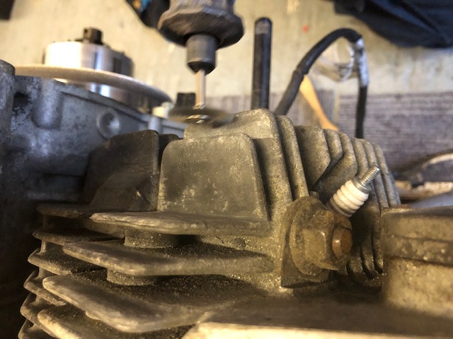

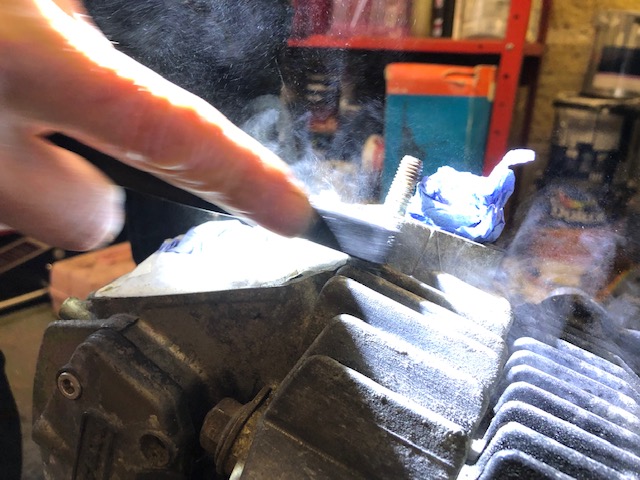

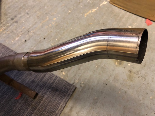

Starter motor off & in pieces we couldn't ignore the worn bushes & general age related wear to everything so it was decision time - a repair kit for £70 or a Ducati supplied replacement OEM starter for £415 were the two obvious options. I wasn't convinced about the repair kit & I certainly wasn't prepared to spunk all those beer tokens on an OEM unit so a new pattern starter motor with a 12 month warranty on the Electrex World website at £120 delivered seemed to a good compromise. It’s on its way.

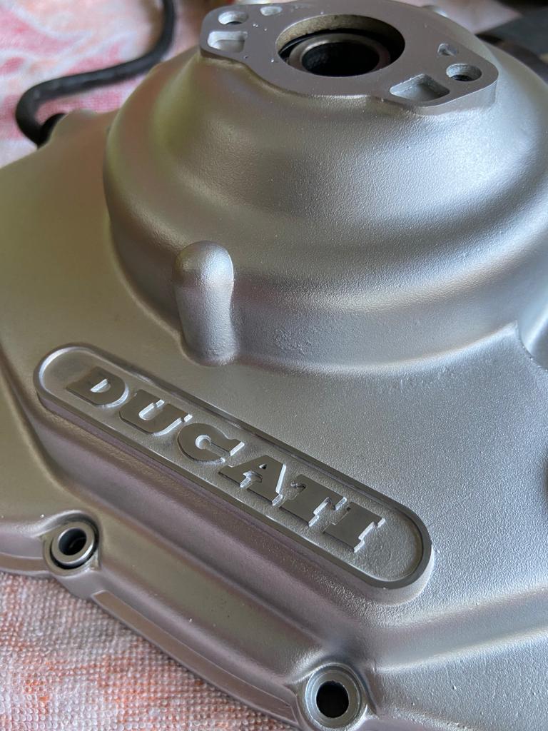

Apart from this minor hiccup the week has been mostly more turd polishing
900ss polished exhaust.jpg (73.67 KiB) Viewed 973 times
900ss dremel.jpg (86.41 KiB) Viewed 973 times
900ss wire brush.jpg (101.96 KiB) Viewed 973 times
Posts: 26930
Re: Ducati 900ss Light Resto/Fix Up
Media blasting easier?

weeksy wrote: Sun Feb 20, 2022 9:54 pm Media blasting easier?
Possibly. I've got a blast cabinet but it's not large enough the for the engine to fit in & this is just a light resto so I don't want to remove the barrels split the cases .
I could send it away for blasting but where's the fun, sorry pain, in that?

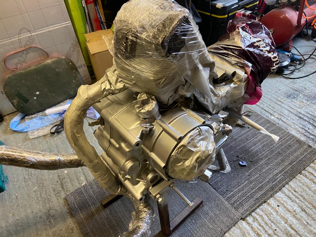

The turd is now polished & rolled in rattle can glitter. All being well it will be back in the frame this weekend
900ss rolled in glitter 3.JPG (165.6 KiB) Viewed 870 times
900ss rolled in glitter.JPG (111.62 KiB) Viewed 870 times
900ss rolled in glitter 4.JPG (113.6 KiB) Viewed 870 times

Potter wrote: Fri Feb 25, 2022 12:26 pm What do you reckon on the life expectancy of the engine paint?
It can't be worse than the OEM stuff but how long do you reckon for basic rattle can stuff?
ime, about a month, (maybe less)

In explanation - I'm a lazy bugger who very likely didn't clean off ALL the old oil and grease from the engine when I painted it..... (you need to really clean it off properly, with very nasty chemicals). :D

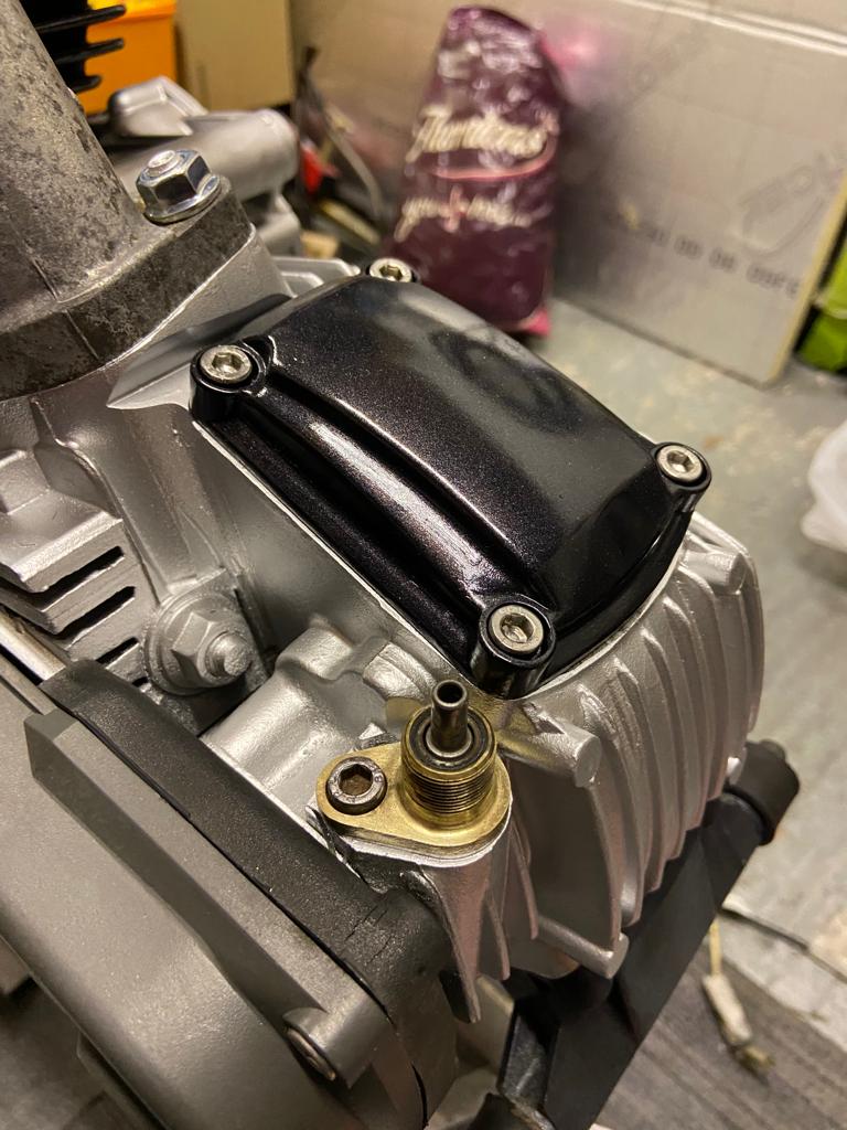

Post by IanB »

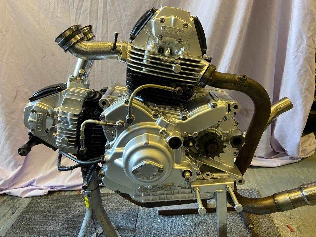

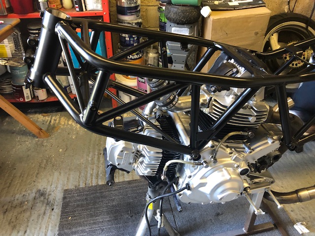

Manged to grab few hours in the garage this morning, to fit the new starter motor (after swapping over the dog gear as the new one was the wrong ratio) & also clean & prep the oil cooler ready for a coat of paint.
The crankcase cover was then refitted & whilst it's not yet time to start reassembling the bike, the frame went onto the engine for a few minutes just to have a little look.
900ss engine finished.JPG (133.09 KiB) Viewed 774 times
900ss frame back on.jpg (136.85 KiB) Viewed 774 times

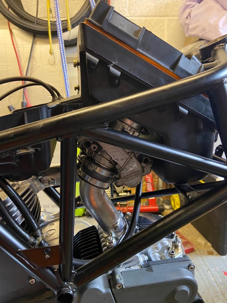

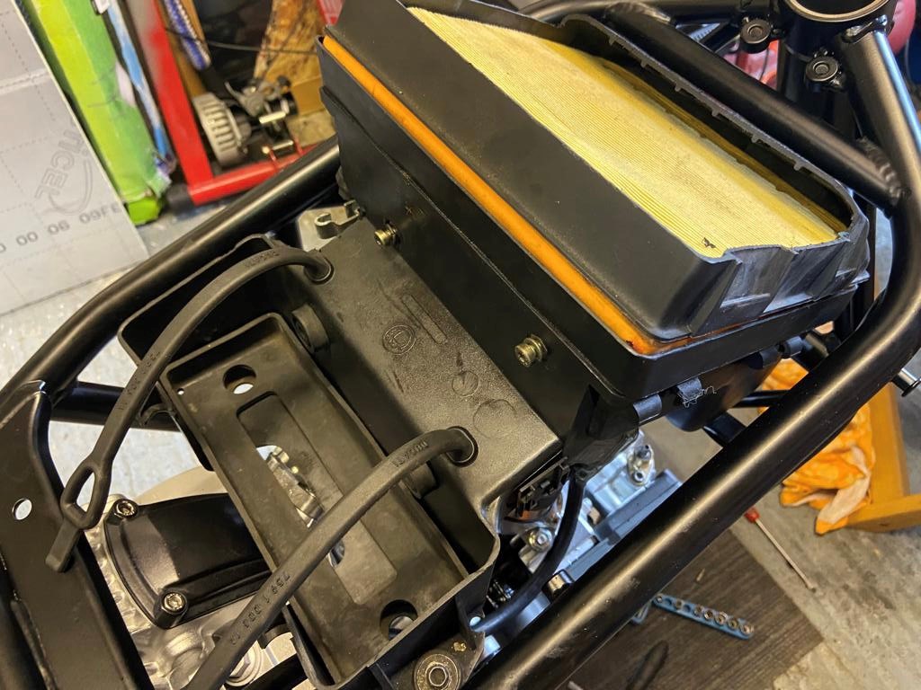

This week we had to face the first unknown on this project - would the airbox still fit in the frame now I've filled some of the free space with the new strengthening bar? If it didn't fit it it would be a back to the drawing board ball-ache involving fitting pod filters & possibly even splitting the carbs.
Sometimes however fortune favours the clueless optimist & this was one such occasion, loosening up the carb trumpets gave enough wriggling room & it went in. Job done. Huge relief.
900ss airbox in 2.jpg (185.09 KiB) Viewed 736 times
900ss airbox in.jpg (164.77 KiB) Viewed 736 times

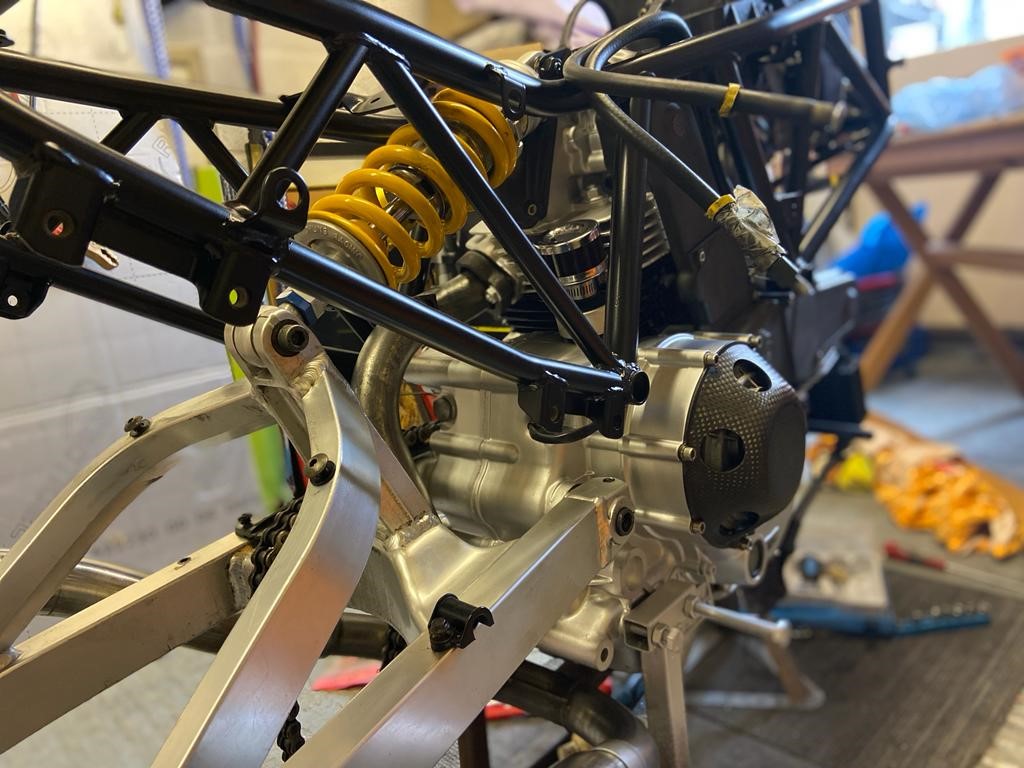

The engine was then treated to a hi flow oil filter & fresh Shell Advance fully synthetic.
Swing arm & shock were then refitted & it's now starting to look like a motorcycle again. Hopefully by the end of the weekend the front & rear ends will be back on then its onto the wiring.
900ss putting it back together.jpg (157.55 KiB) Viewed 734 times
Posts: 17500
I see someone has already 'customised' the airbox lid :)

Post by IanB »
KungFooBob wrote: Fri Mar 04, 2022 6:07 pm I see someone has already 'customised' the airbox lid :)
Yep, one of the 27 previous owners was obviously a hacksaw tuner. 🙄
