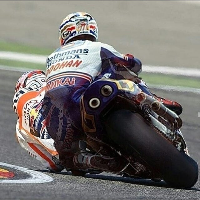

Just posted this in the 'cool race pics' thread.The Spin Doctor wrote: Thu Feb 04, 2021 2:50 pm
The important point is that the 'lean angle' is not the lean angle of the BIKE but it's the lean angle of BIKE PLUS RIDER COMBINED. That's because the momentum is operating through the combined Centre of Mass. The friction of your tyres are constraining the cCoM and keeping the bike and rider turning.
But... and this is the key bit of understanding... the cCoM stays in ROUGHLY THE SAME PLACE (it moves down a little if you lean in, and up a little if you lean out, and this is the source of the belief that by leaning the body into a turn you get more grip, but the effect is so tiny as only to be of interest to racers operating on the edge of adhesion).
Because the cCoM is (almost) in the same place so the forces the tyres are balancing remain (almost) the same. So as I said in the earlier post, you're just riding on a different bit of the contact patch! Sitting up to the bike leans in does not 'reduce friction' and and pushing the bike upright does NOT materially add to tyre trip.
Here seemed appropriate too

Good mash up
I remember pointing out years ago that Doohan had a weird asymmetric riding style, different on left and right handers, Still worked, though.

Someone pointed out years ago that as a practical scientist he used a centrifuge on a daily basis.*That's right, centrifugal force. It really does exist, it's just a question of what you choose as your reference system![]()
Re: The Steering Thread
There's nothing you can do in the sense that turning left generates a reaction force* to the right. That's just plain old physics. If you're 250kg then you'll always generate the same forces if you're cornering at the same speed. That's a fundamental fixed point if you will.
Anything to do with hanging off, tyre shapes etc. is kinda next level down effect. You can't make it so you need any less force to get around the corner any more than you can pick yourself up by your own shirt collar!
I don't know enough about the relative differences between race and road tyres to know the tradeoffs of lean vs grip TBH and I can well believe that a road tyre might actually be sticker on the edges. Thats before you even throw in such complexities as suspension geometry/kinematics being different when you're leant over or springs and dampers being different etc.
*just to keep the pedants happy, turning left doesn't actually generate a reaction force to the right on you. You feel a force pushing left on you, the road feels a reaction force to the right on it. However from your POV there's a 'fictitious force' throwing you off to the right due to your own inertia. If that is confusing don't worry, these inertial forces are what first got Einstein thinking about relativity
Racers do it best. Rolling on power as the bike sits up. Less chance of wheel sliding out. I don't know but would imagine, not many riders slip off when bike is balanced in the apex. No brake, no power.
If your speed is very low then the force which tries to make the bike roll outwards is very small - and you can counter it by shifting body mass the other way. It's really only of academic interest but it does mean that direct steering works at slow walking pace.Mr. Dazzle wrote: Wed Feb 10, 2021 10:54 pm There's nothing you can do in the sense that turning left generates a reaction force* to the right. That's just plain old physics. If you're 250kg then you'll always generate the same forces if you're cornering at the same speed. That's a fundamental fixed point if you will.
Dual compound road tyres are DEFINITELY grippier on the shoulder - that's why they are dual compound!Anything to do with hanging off, tyre shapes etc. is kinda next level down effect. You can't make it so you need any less force to get around the corner any more than you can pick yourself up by your own shirt collar!
Racers use multi compound tyres too though and have for a long time, yet they still go to great lengths to make the bike stand up again....
