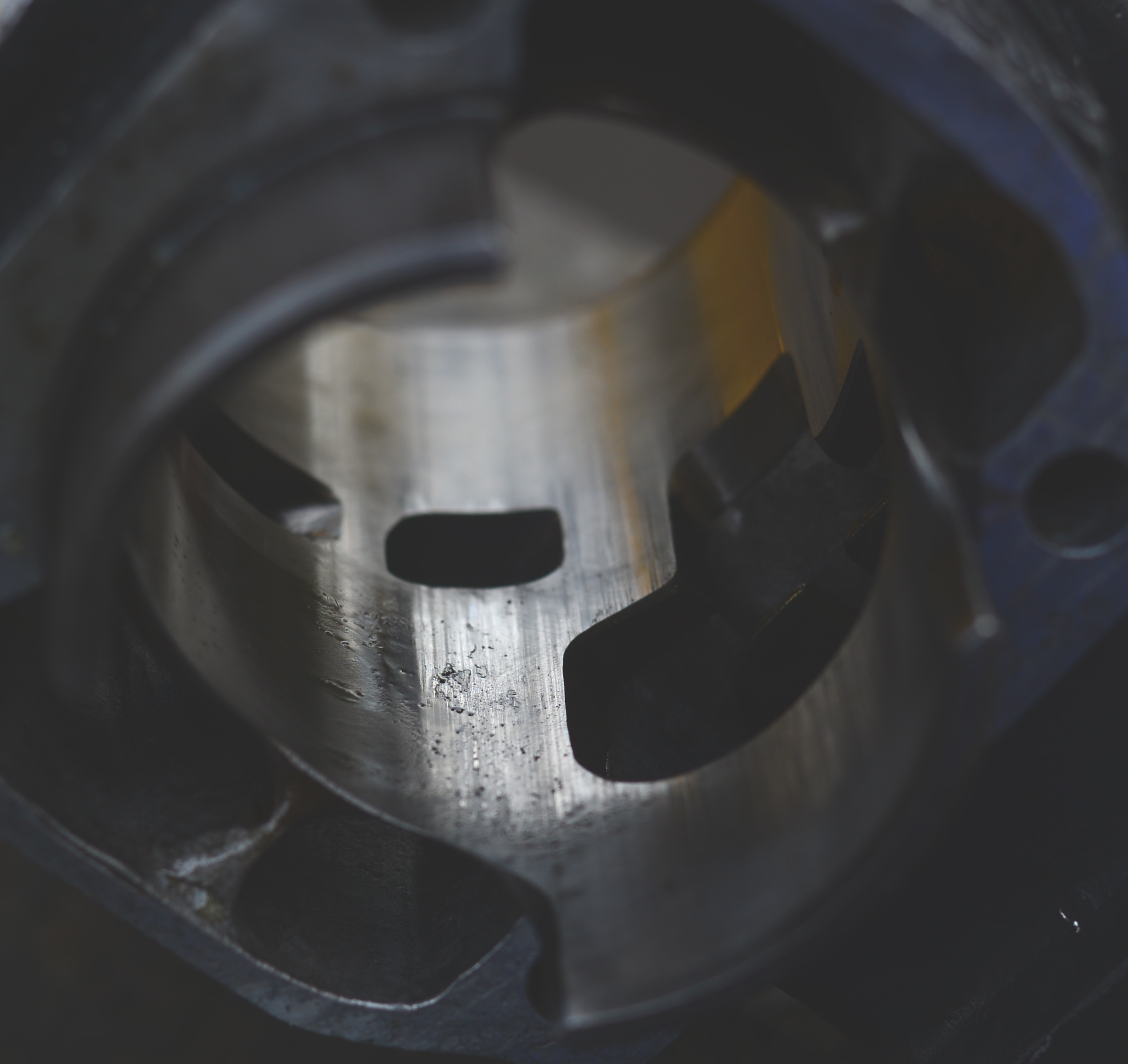

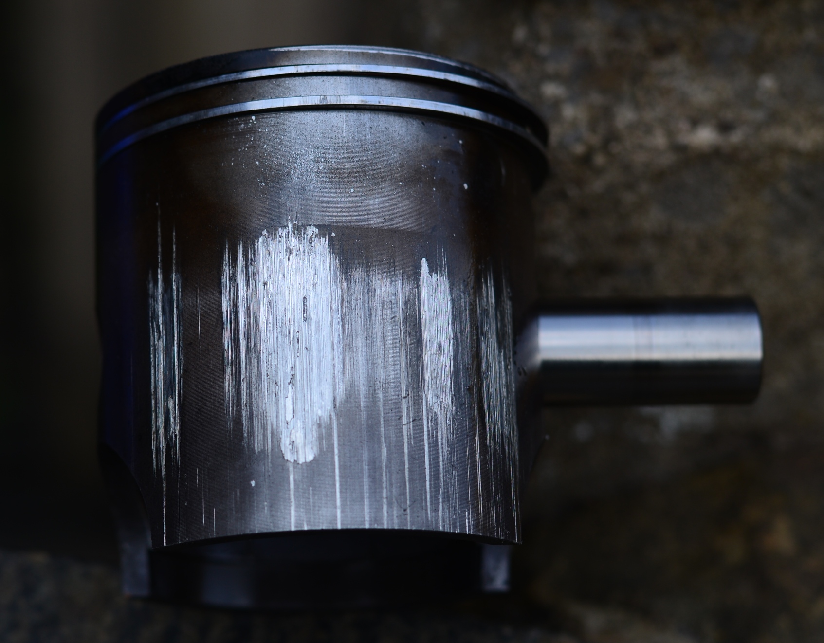

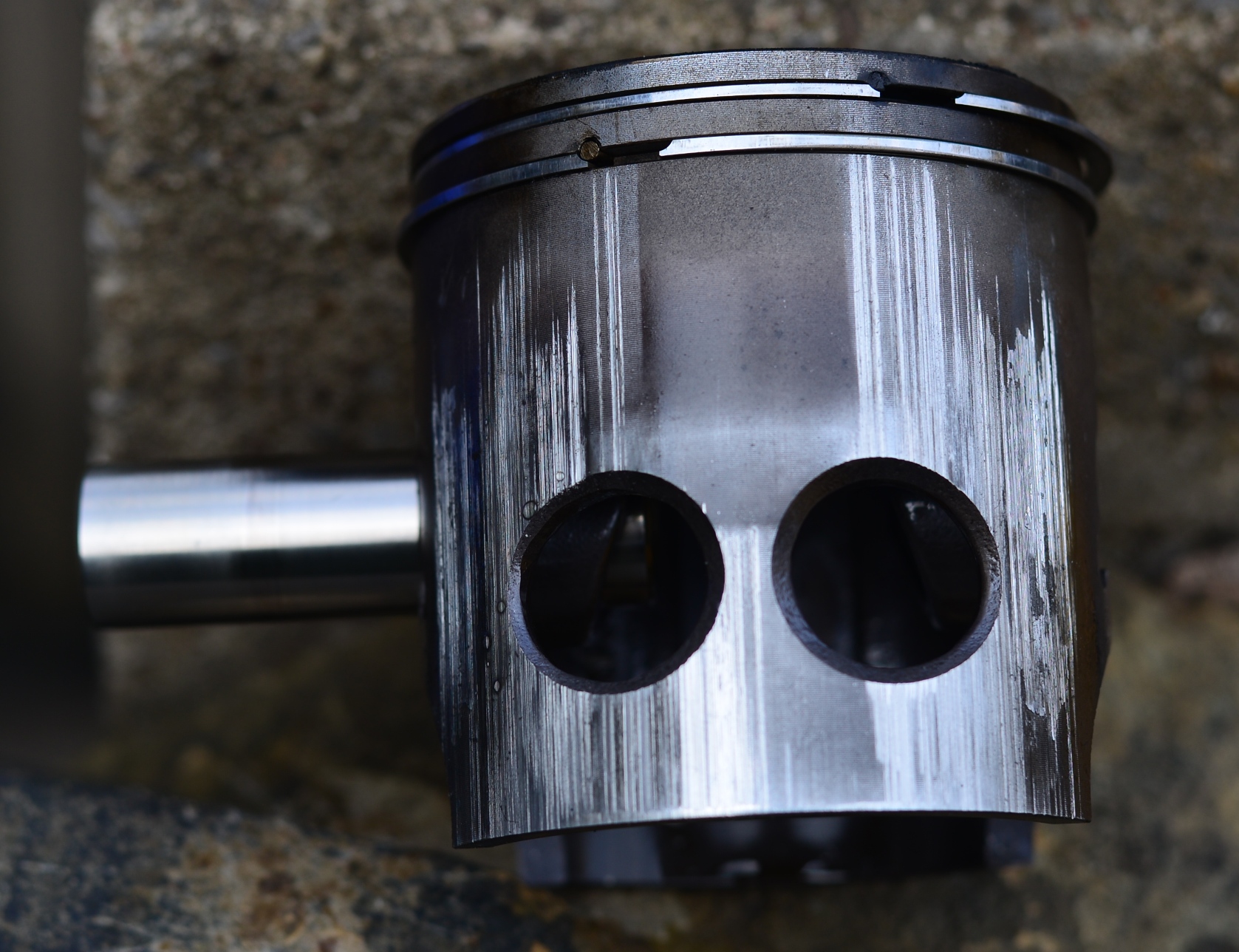

Both barrels are off and there are some pretty nasty marks on the LH barrel. The LH piston is toast. I'm going to take it for a second and third opinion to a couple of guys I know; one has probably worked on as many LCs as I've had hot dinners, and the other one runs a bike shop not too far from me and is proper 'old skool' . He doesn't sell bikes, he just fixes them and sells spares. Here are some pictures that may make for unpleasant viewing...

And a couple more...

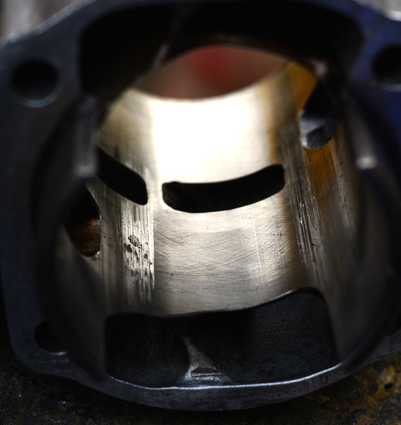

I think your going to have to have a rebore, it's hard to see whether the barrel is scored or there's melted piston smeared up it

Yeah, I reckon it will need a rebore. A seizure from lack of oil has to cause a bad outcome. Looking at the state of the piston, how can that not have caused damage to the bore? It's a pisser but doing half a job would just be storing up problems for later.

That looks like someone has been at it with a die grinder and carbide burr...
