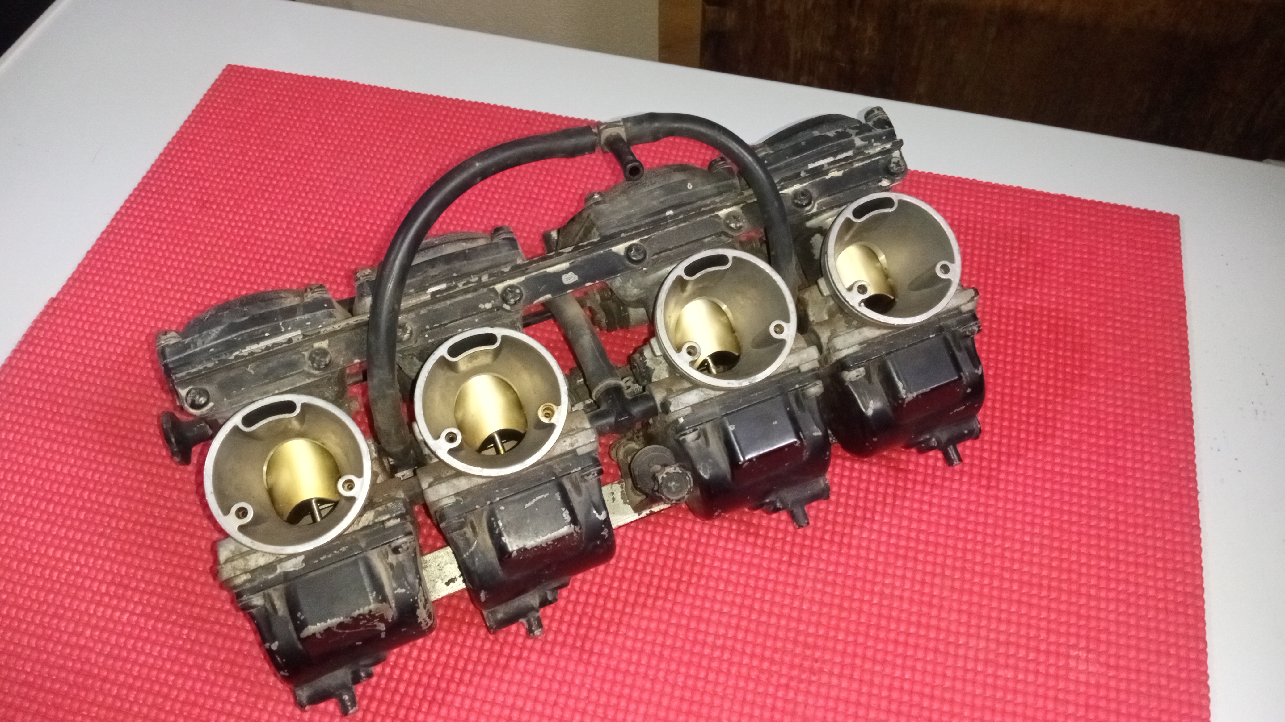

Scored another set of carbs for parts from a mate for $20 + shipping, same guy who sold me the clocks for $25.

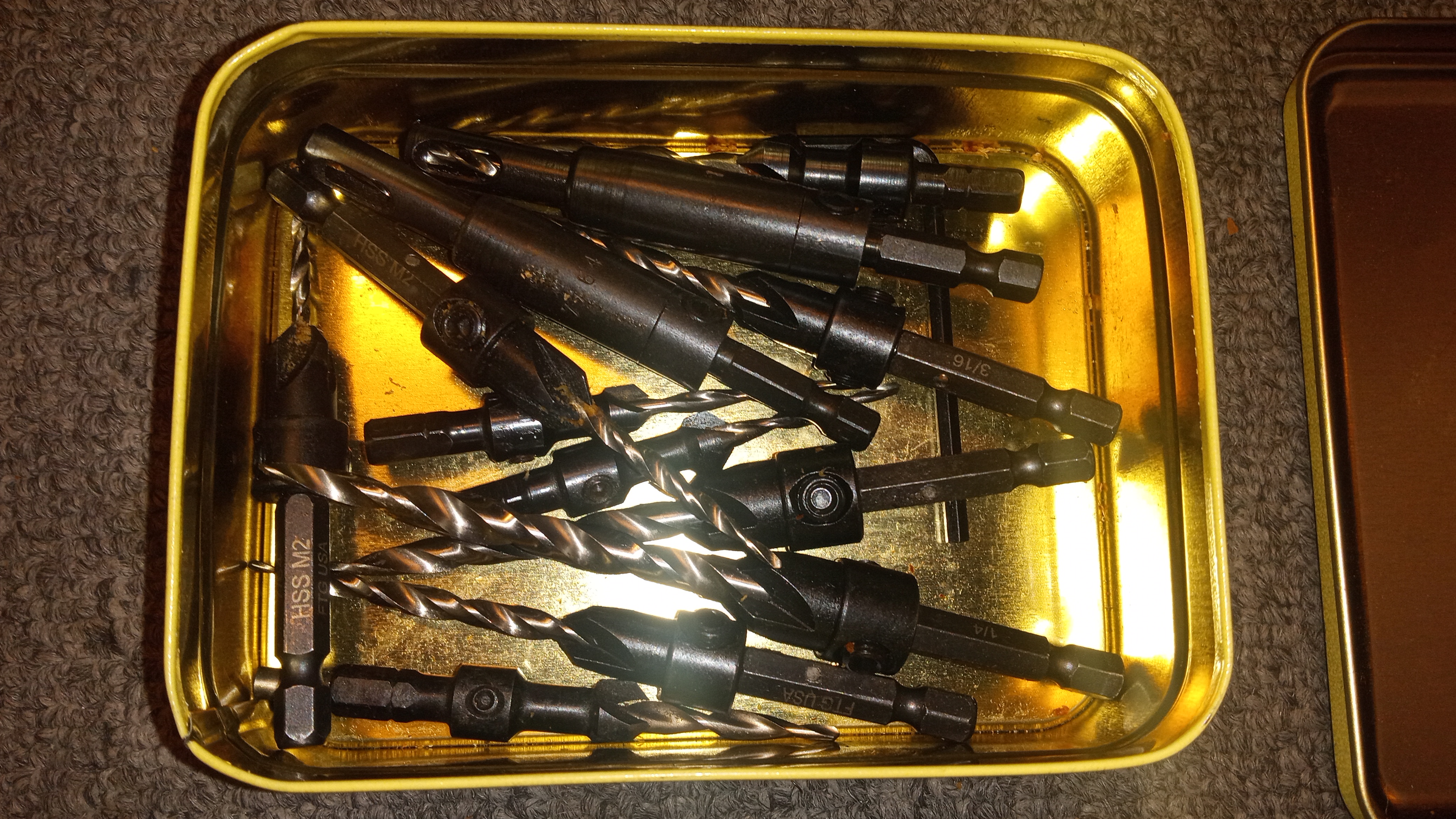

Dumped a shit-ton of screws from the carbs in the tumbler this afternoon.
Also dug out my tin of weird drill bits... it has tapered bits for wood screws....
and also these three bits which have a spring-loaded doodad that centers the bit when drilling pilot holes for door hinge screws...
The smaller one is the perfect size & depth for drilling into that buggered air screw on the #1 carb, & I deployed the screw extractors for use after I put a hole right in the middle of the air screw.

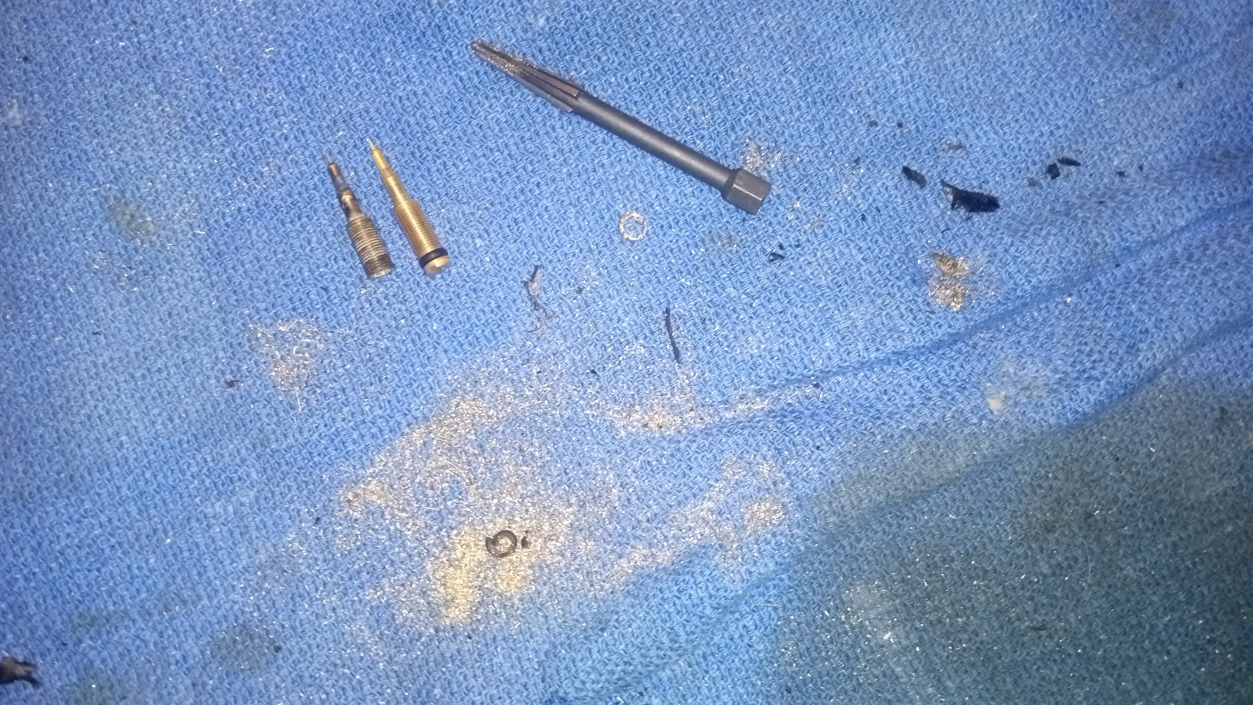

All set to drill out that buggered air screw now. Got the drill bit shown in the previous post & three different types* of extractor... NONE of which are those fucking E-Z Out mongfoolery. :)
*including a German #1 Rennsteig extractor.

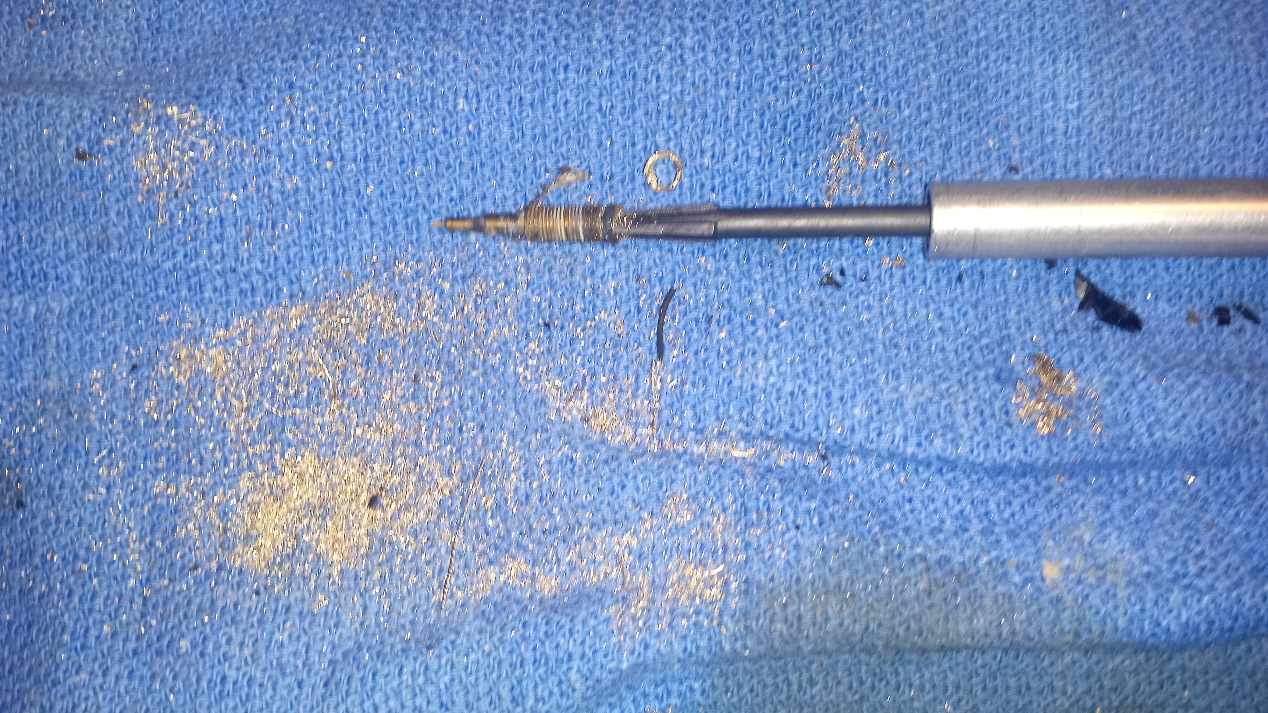

YES!!! Behold the extracting GOD you lowly peasants!! :obscene-birdiedoublered: :obscene-birdiedoublered:
Rennsteig for the win!! :banana-dance:
Started with the self-centering hinge drill doodad to get the hole started, went up to a slightly larger bit & went to town (notice the brass swarf), Then put the Rennsteig in the hole, seated it with a couple of light hammer taps & then just unscrewed the jet. 8-) 8-)
The Amazon reviews of the German doodad had several people saying "Bought this to successfully remove a stuck jet in a Mikuni".. which I will be adding too.

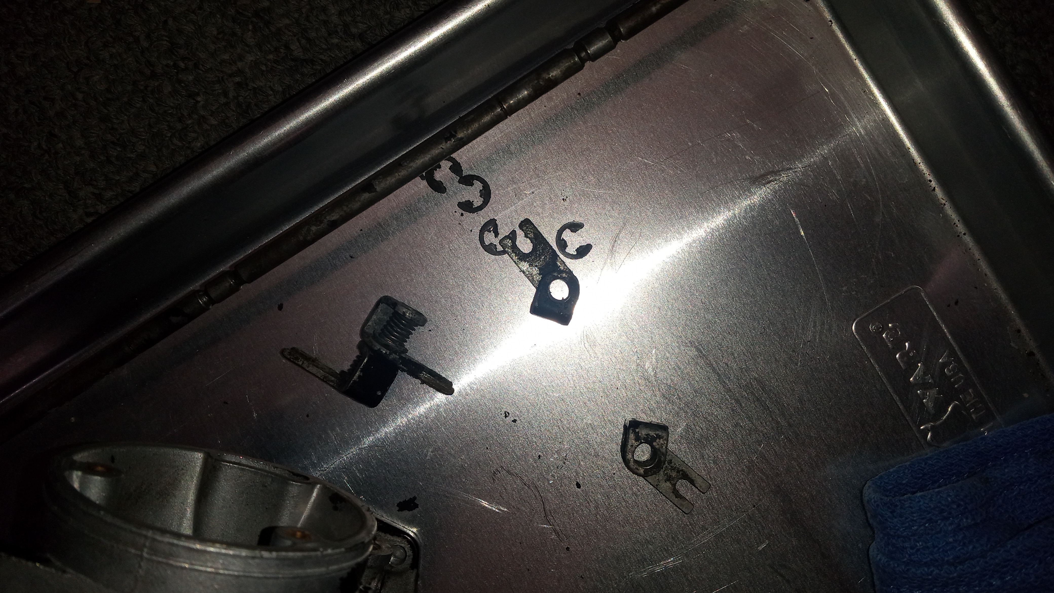

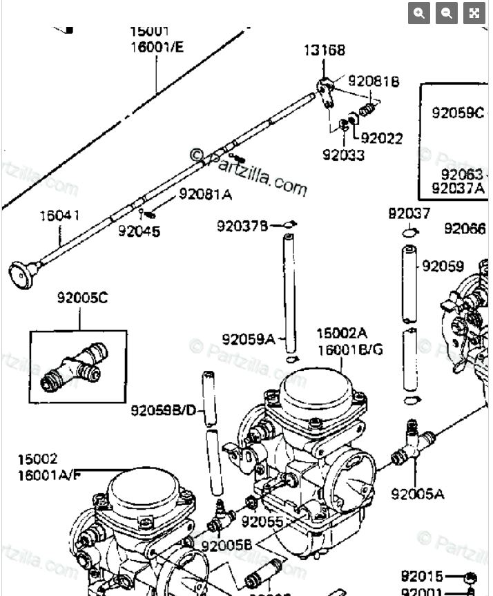

FINALLY got the carbs separated. Issue was the choke rod which most online posts state "remove the screws & slide the rod out"... :eh:
Problem:
It doesn't have any fucking screws :angry-cussingblack:
Solution:
Found a post on KZRider from over a decade ago that mentioned Ping!FuckIts! & even listed the part # (92033-1066) Looked up the parts diagram & found the buggers. :thumbup:
Choke Rod.JPG (115 KiB) Viewed 1929 times
& once I popped those buggers off I could separate the carbs.
Tomorrow I might even pull the choke plunger assemblies. :think:

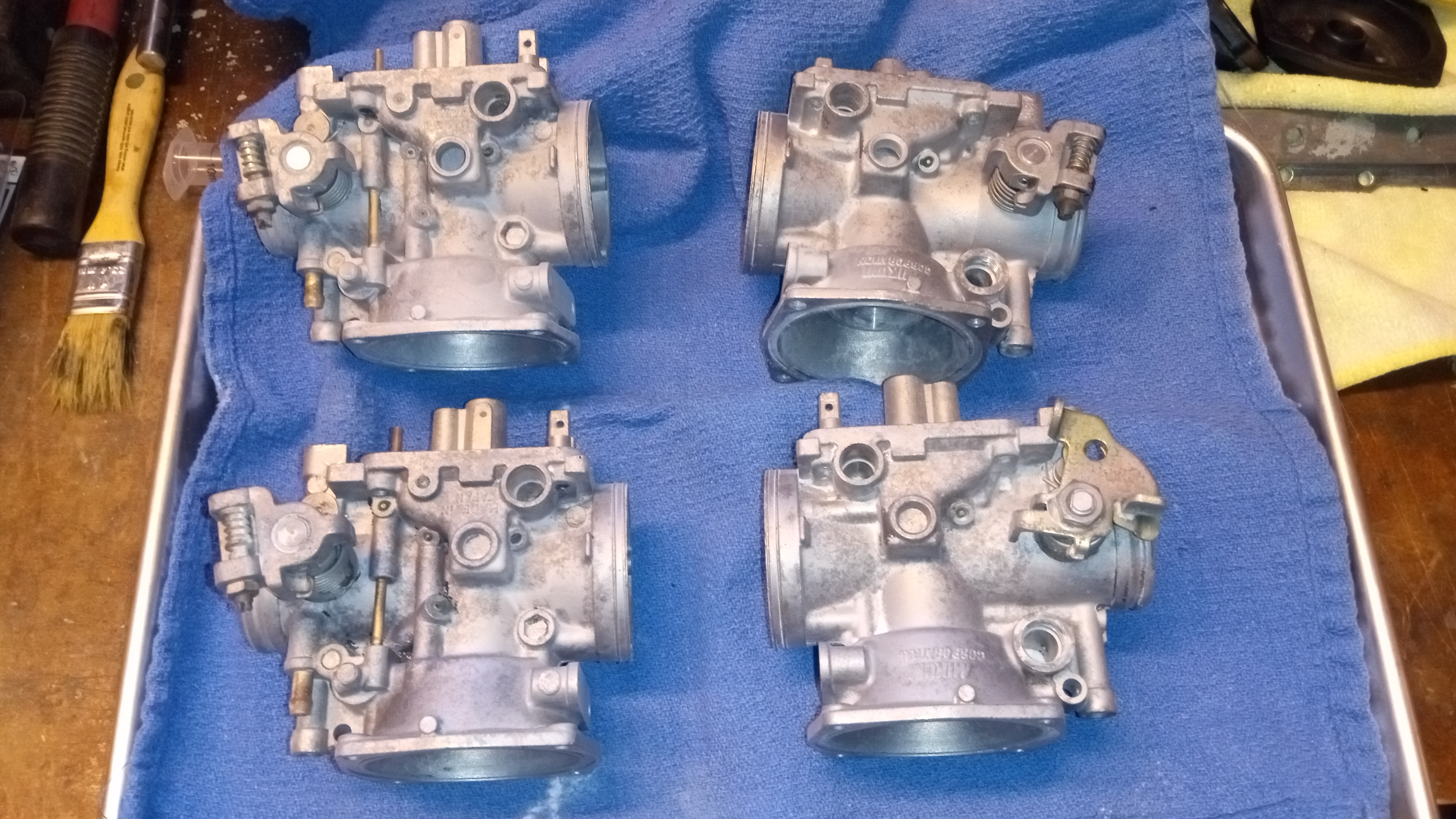

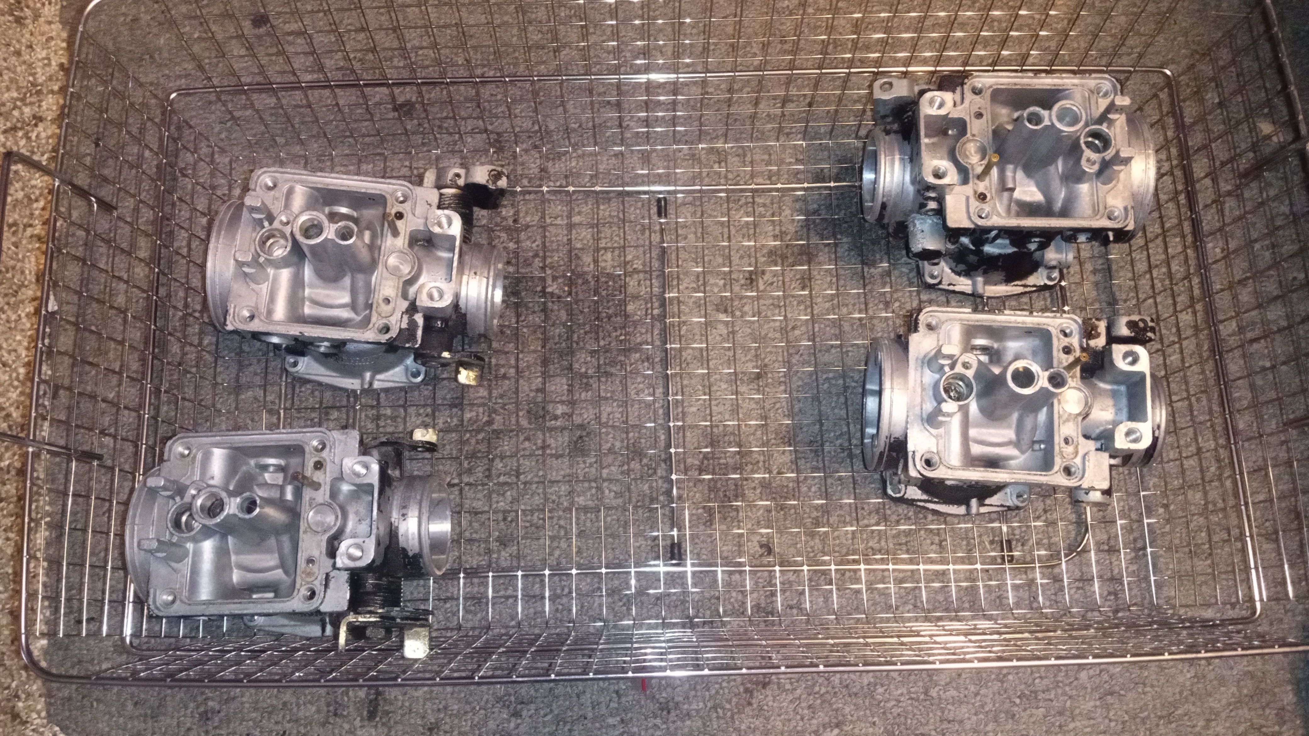

Choke plungers removed, carb bodies back in the ultrasonic.
Posts: 9063
Has thanked: 2296 times
Been thanked: 2686 times
Re: '83 GPz750-A1 malarkey.
...and back out again after an hour. Even managed to get the balls (# 92045)& springs (#22081-A) out of the two carbs that position the choke rod. Balls came out in the tank, springs removed after with a sharp pointy thing (scribe, for you technical types).

I got it from Amazon, just punch "Rennsteig extractor" in the search bar. For carbs you want the #1 size. It's a Knipex company. If you don't tap it hard enough to seat it in the hole it will act like a tapered reamer, at which point another clout or two will have it seated enough to grip the brass carb doodad.
I started with a small drill bit, then went to 1/8in. Drilled in about 1/4in.

Then ran another old screw in to check the threads were ok, they are.

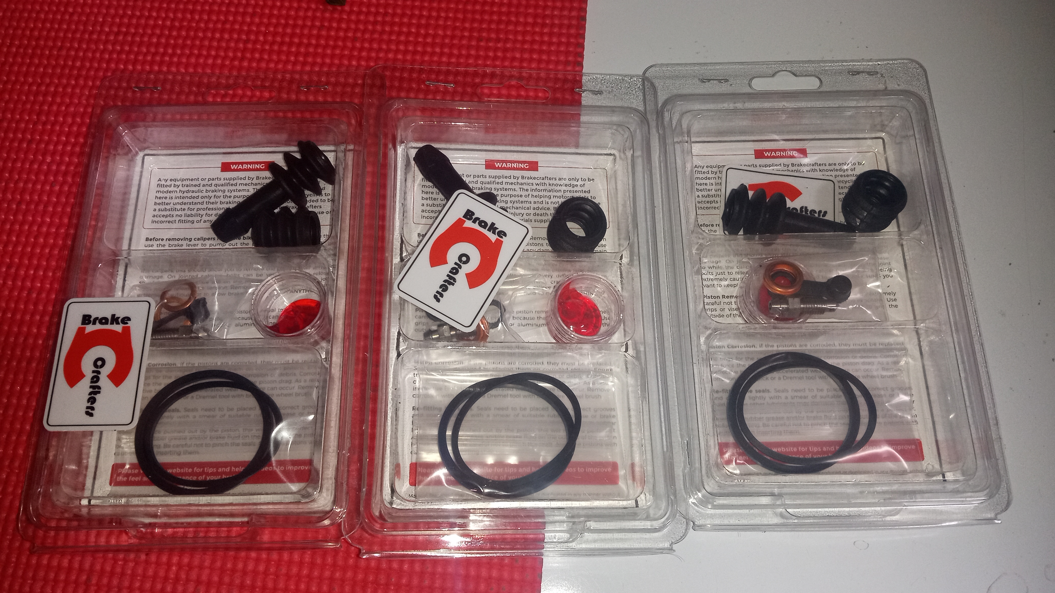

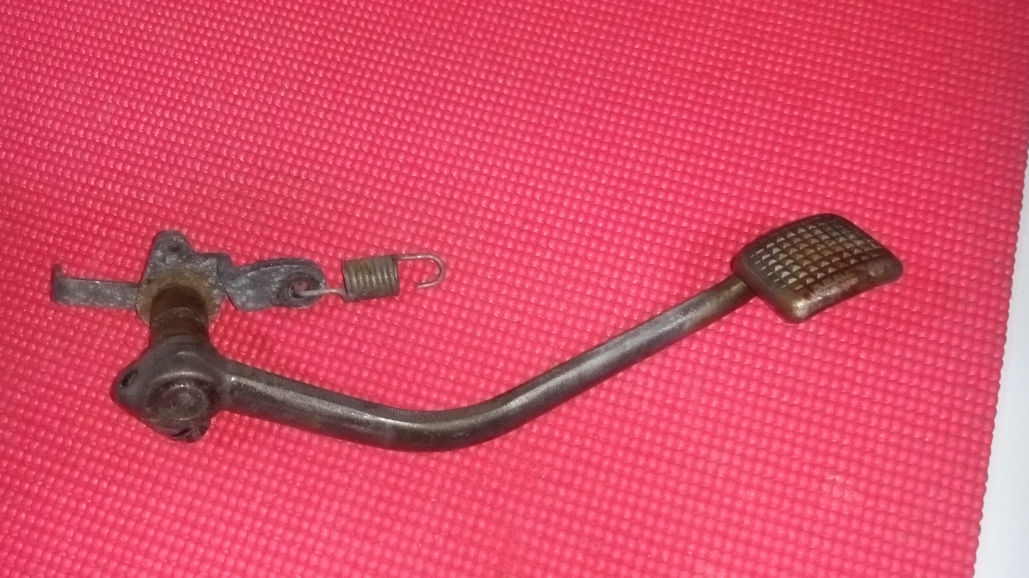

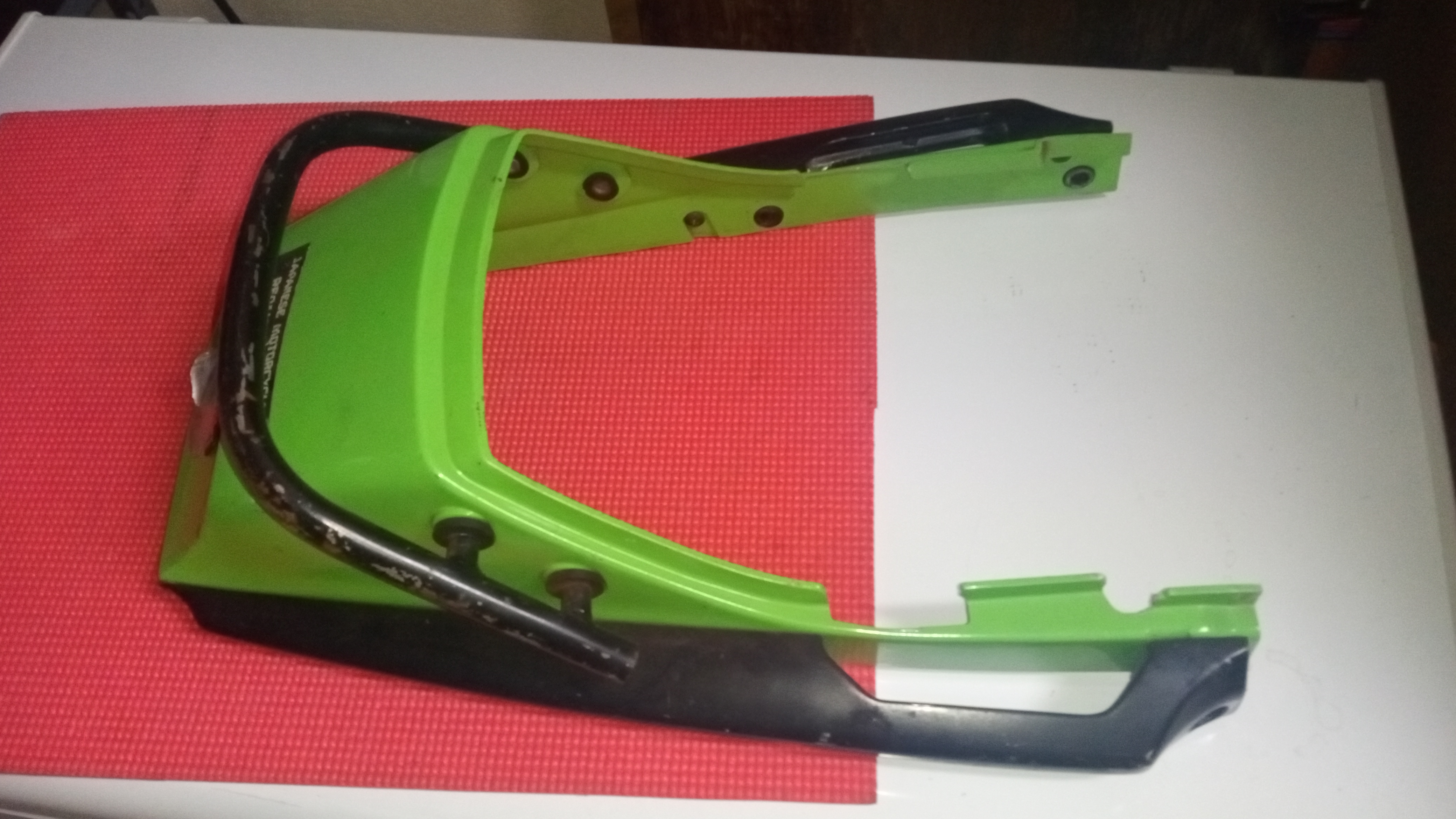

Santa dropped by again.... Ya win some, ya lose some...
Brake kits: Win! :thumbup:
Another tail: Win! (it has some parts attached that I want/need) :thumbup:
Kickstand: Lose. Ad showed parts that I need attached to it. Fucker didn't send those, didn't need the actual stand. :angry-cussingblack:

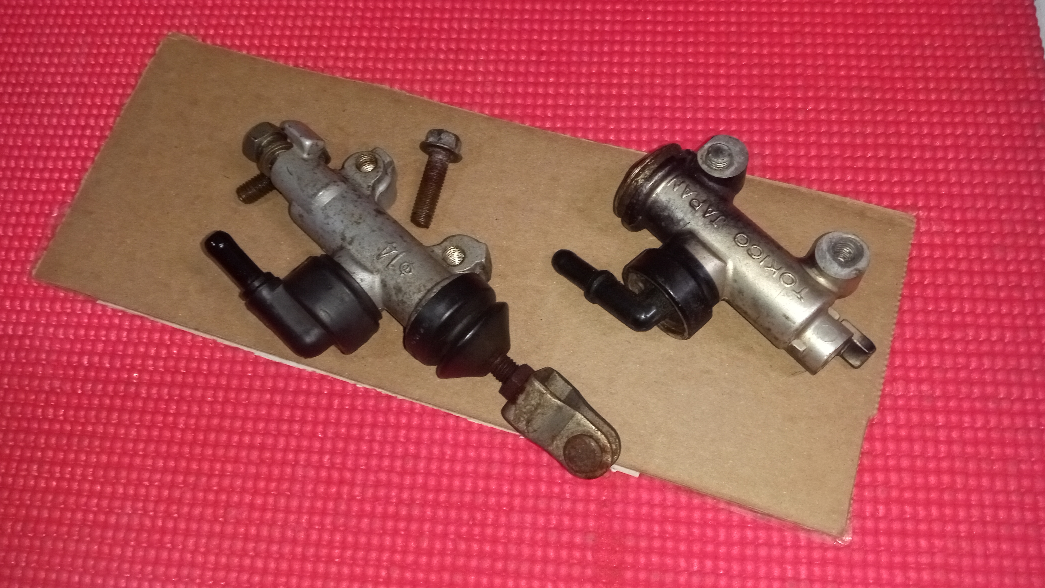

Another rear m/c showed up. Original (right) has a bolt sheared off in it, may attempt to remove broken bolt at some point...

Got done with that & put everything away, hosed off the driveway etc.. & just when I finished the other set of carbs showed up from Texas. :roll: I thought I was getting a partially stripped set, but they're complete :banana-dance:
So the Saturday plan is original carb bodies back in the ultrasonic & pull a couple of parts off the spare set.
