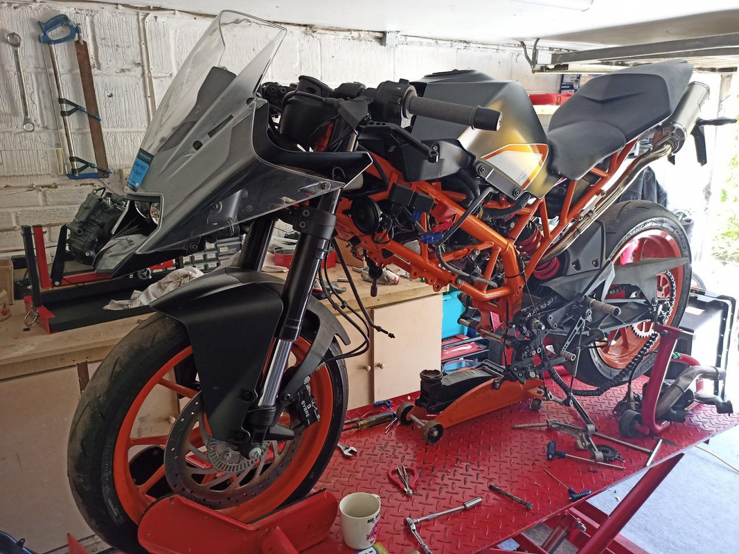

Had a couple of spare hours this morning, and as a result, this is how the 390 currently looks - I am off doing other stuff now but the plan is that I'll be inside the motor either later today if I can, or tomorrow for the big reveal.
From this morning's work and a little bit of googling it's become clear that isn't going to be the first time this motor has been apart, and the previous owner was, let's say, not entirely honest with me about its history in his possession when I bought it, but that's another story...
Anyway, stay tuned and watch this space to find out what the inside of a KTM 390 motor looks like, and to discover the cause of this one's appetite for oil

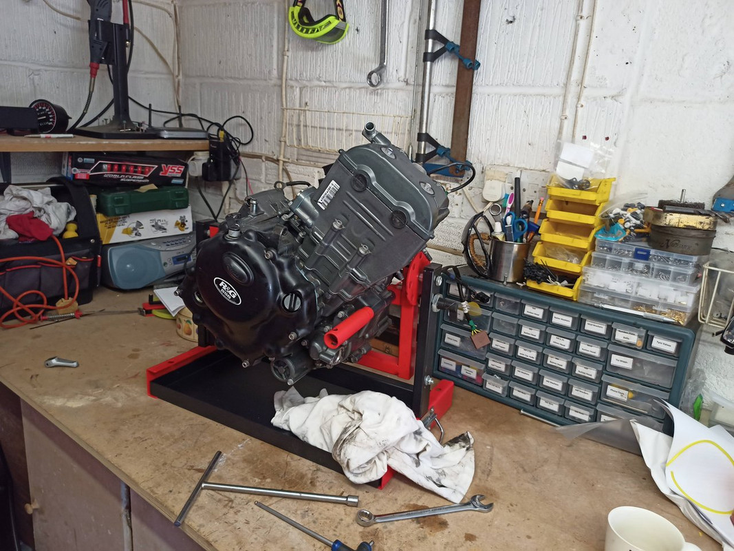

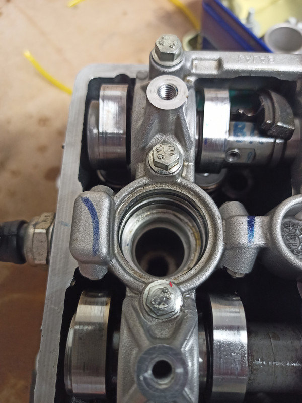

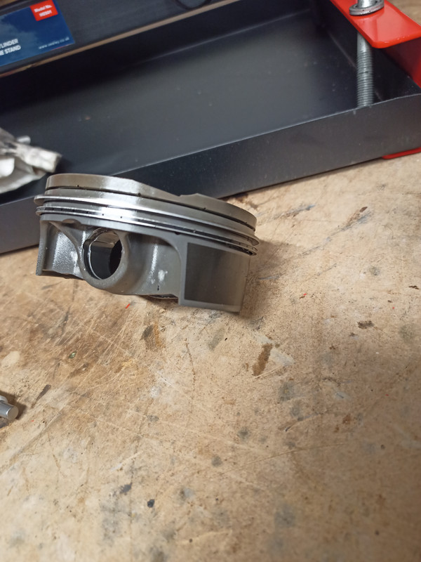

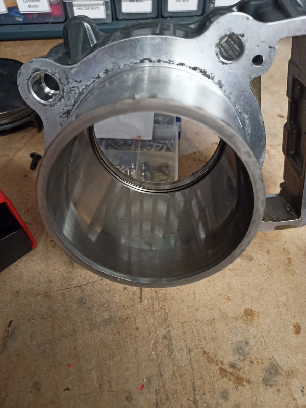

Well, the motor is now in bits, a very straightforward and nice engine to work on once it's out of the frame, but FMOB, those head bolts were tight!
In terms of what I've found, the only area of concern really is just a very baggy oil control ring- I was expecting more but that's it, which is good news.
Bore is immaculate as is the piston ( aside from a bit of inconsequential gouging around the gudgeon pin circlips where the previous matey has obviously struggled a bit getting the clip in, but it's not significant.
End gaps on the rings are all well within tolerance, but the oil ring practically fell off the piston- I know that it is typically not as strongly sprung as the compression ring(s), but never seen one like this before- there's no physical damage to it, I'll be interested to see how it compares to a brand new one.

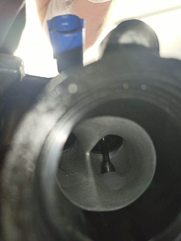

The valve stems and ports look clean, and the valves are all sealing perfectly so I'm as certain as I can be that the ring is the problem rather than valve guides.
There is some visible marking on a couple of the cam lobes, which does slightly concern me, but the rockers look good and I can't feel any of the marks with my fingernails so they'll all go back as they are. The exhaust cam has some blue felt pen writing on it which is a bit strange, just letters and numbers, not sure of the significance currently
Three of the valve clearances were just (.05 mm bigger ) outside the upper band of tolerance, so need a few shims too- sod's law I forgot to include them on the order I've just done.

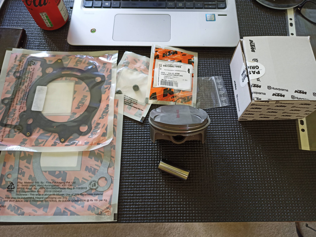

At long (long long) last, DPD man arrived today with these goodies, so as soon as I can get back in the garage (likely this weekend) I'll get the motor back together and back in the bike- interestingly, everything has " made in India" on it with the exception of the piston and rings, which is made in Austria, and has that printed on the top of the piston itself in addition to the packaging.
The good news is that the difference between the new and old oil control ring is absolutely night and day, feck knows why the old one is so flaccid and un-springy but that's the issue.

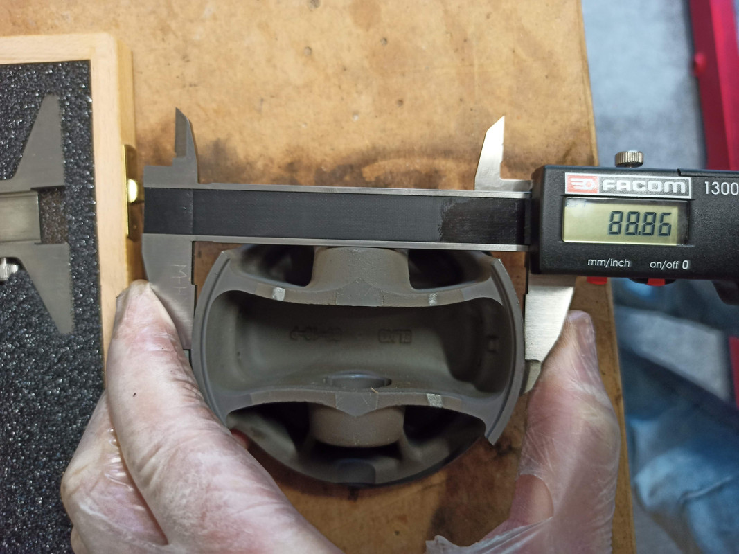

I got a few hours in the garage this week-end so made some progress

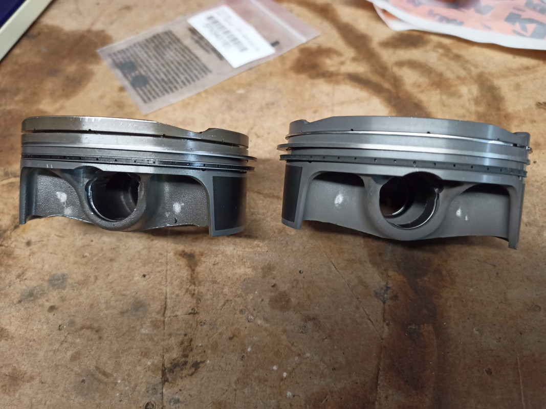

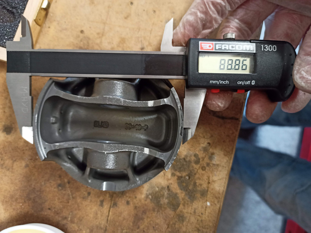

Before I re-assembled the motor, thought I'd do a bit more comparison of the old and new pistons;- as expected from the visual condition of the old one, there was no discernable size difference between the two
Old...
And new
It turns out a couple of (inconsequential) marks on the old piston that I thought must have been created by the previous owner weren't as the new piston has exactly the same maks, so I assume its from the jig/chuck or tool that it's held in at the factory for finishing

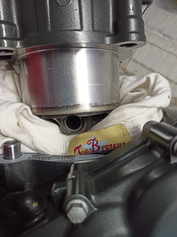

I used a ring compressor to fit the piston to the bore before attaching it to the conrod, and I must admit, although this is the KTM recommended way, what a pain it then is to get the second circlip in- there is so little room relatively speaking and after a few minutes I was considering pulling the barrel and doing it the more traditional (for me anyway) way and fitting the piston to the conrod first, but we got there in the end
Old...
And new
