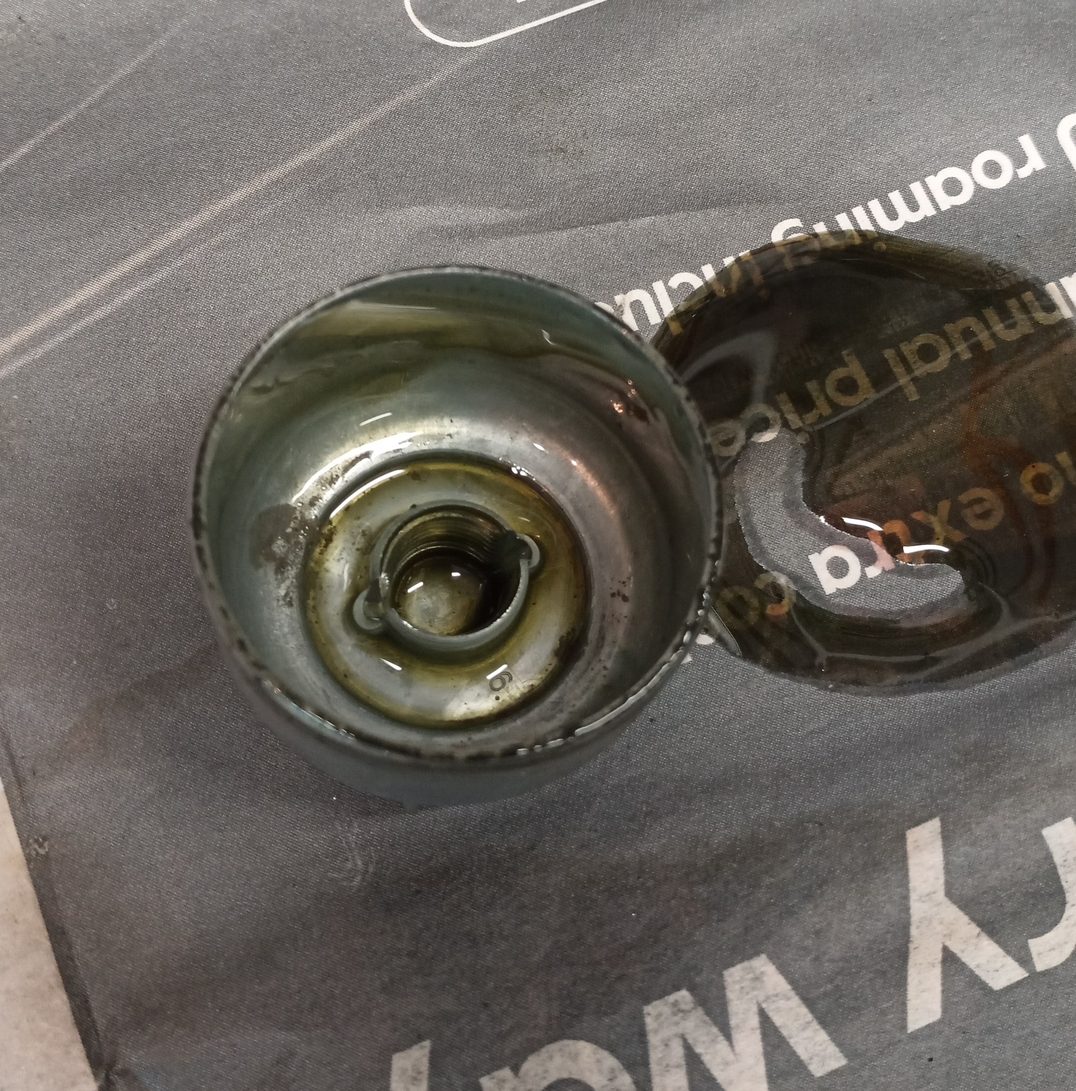

So, stripping the carb again in preparation for an ultrasonic bath (a friend has one), and the sodding curse of fibre washers strikes again...

Yay! Carb cleaner and a bit of hot air.... (And some careful scraping with the old dental picks...)
Also stripped the Puch carb down, it still had clean oil in the bowl!

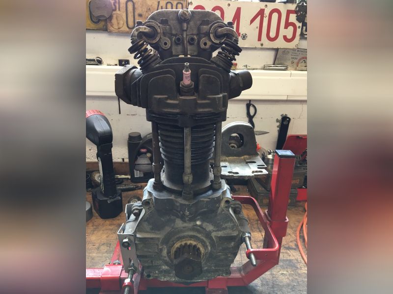

I was wiping some oil off the top of the crankcase when I discovered something that terrifies me...
That bolt, the one between the push-rod tubes, is loose, and it won't go tight. :wtf:
It just revolves.
Now - I may be wrong.... but, to me, that indicates that there's a friggin NUT on the other side of the case, that is loose, and is hanging on the threads of the bolt.
:wtf: :wtf: :wtf: :wtf: :wtf:
I may be wrong, and the loose bolt is caused by the threads on either the bolt or the casing being thoroughly knackered.
But - either way, the mininum work needed before I can do anything with the bike is to strip the entire right side of the engine away to check what's going on in the timing box. :roll:
I can't take a chance on the probability of a nut dropping into the timing box.
So - The JAPton is unlikely to see tarmac again this side of Easter, simply because I know that I've never done any of this stuff before and I'll be taking things very slow and thoroughly checking it all, and researching how it all works. Oddly, for all the tinkering I've done over the years, this is the first time I've ever had to actually do the timing on anything.
I also seem to have been thrown off / barred from the JAP Engine Facebook group I was on - so also need to find a J.A.P. specialist source of further information.
Dagnabbit.
* I must get a copy of that leaflet blown up and laminated. I did the same with the exploded diagram for the carb and it's an invaluable reference sheet).

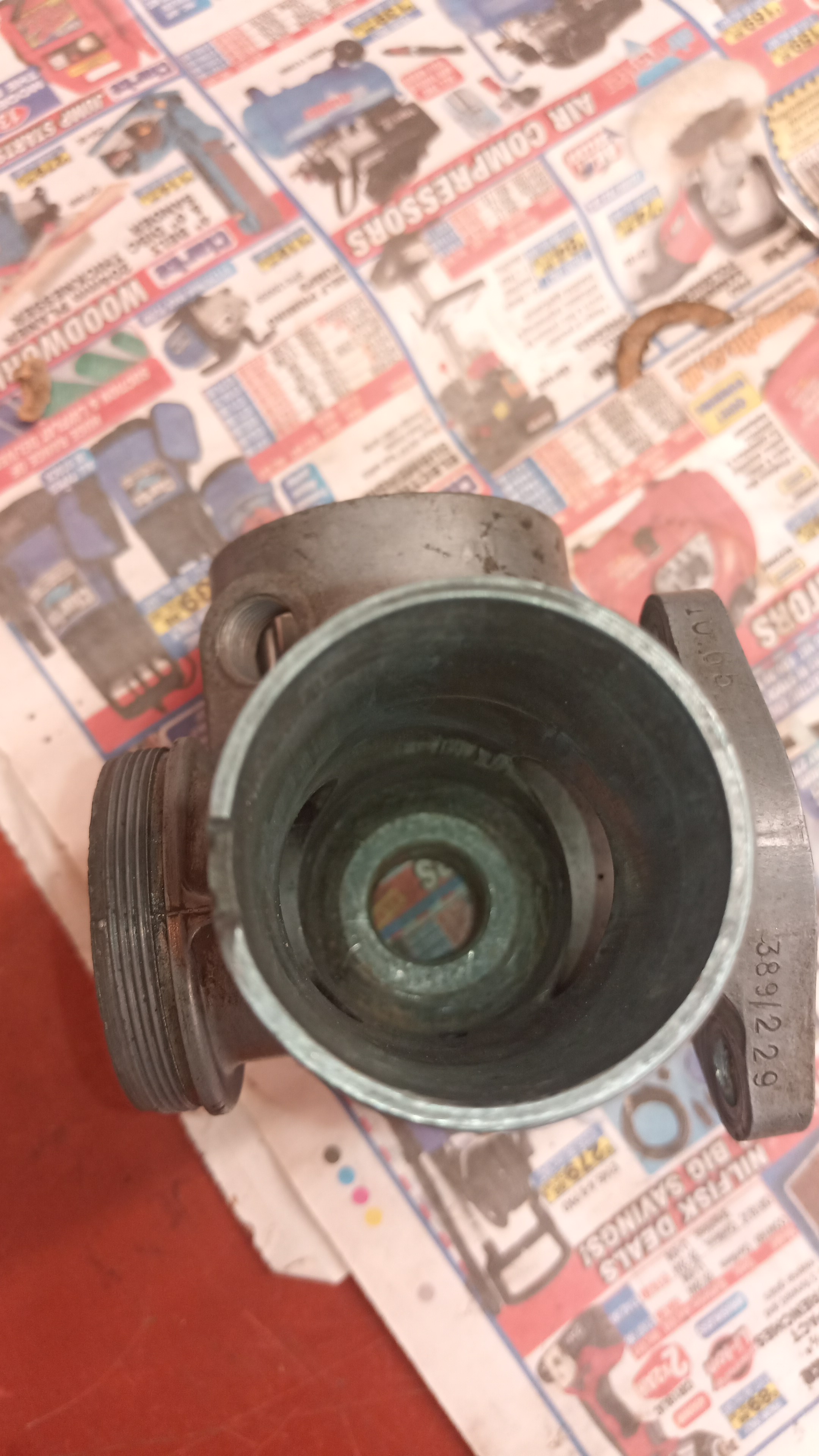

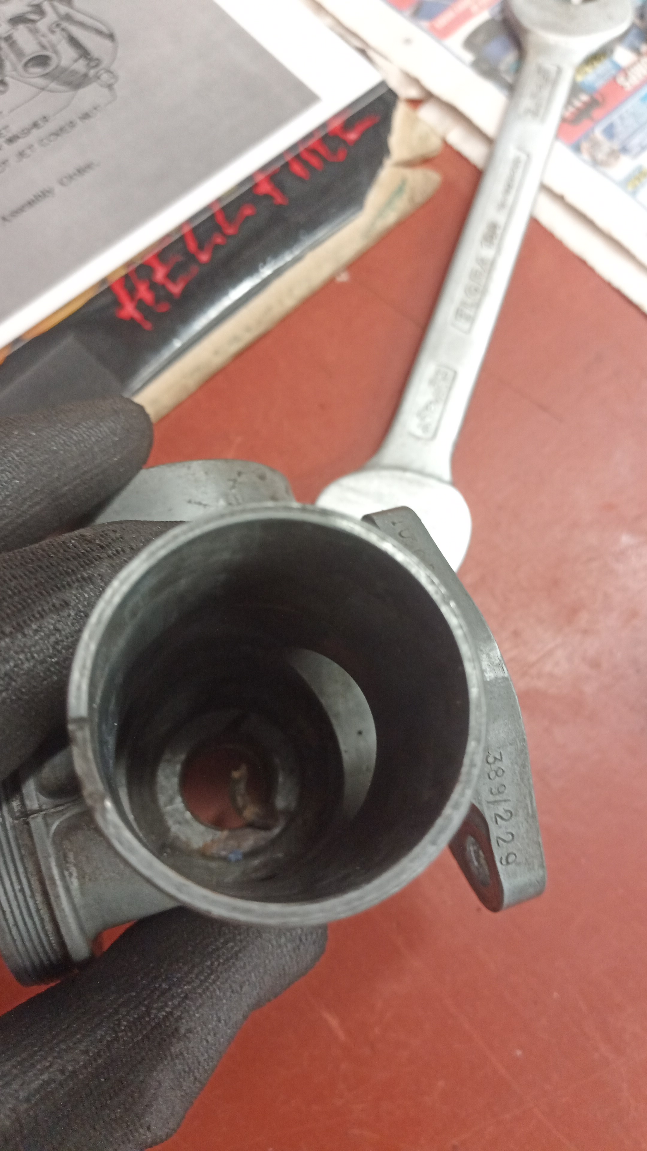

oh yeah - there's one other weird thing happening in the JAPton:
On the Monobloc carb, although I've cleaned it all up, when I use the tickler to push the float down, it "works" - but the fuel doesn't overflow through the ticker - it eventually overflows out of the bellmouth! (or possibly a tiny hole in the inlet manifold).
The tickler is simply a metal tube, closed at the top end, but with a small hole on the side about a mm down from the top. The bottom of the tube is squared off, but not closed up, and it's completely clean - it's not blocked in anyway.
The top of the float - which the tickler pushes down on, is rounded, so there's no "flat plane" on which the end of the tickler could possibly "seal".
So I'm highly confused as to why the fuel isn't exiting out of the tickler!

Posted: Tue Aug 08, 2023 12:54 pm
If its the same as the one below, then it looks like the tickler pushes the float down but the fuel would likely flow out of number 24 as its lower and that would be where you're thinking its coming from? Possibly indicating the needle valve (seal) is worn?
Re: New Project(s)
Posted: Tue Aug 08, 2023 1:00 pm
by Rockburner
Taipan wrote: Tue Aug 08, 2023 12:54 pm If its the same as the one below, then it looks like the tickler pushes the float down but the fuel would likely flow out of number 24 as its lower and that would be where you're thinking its coming from? Possibly indicating the needle valve (seal) is worn?
24 is the feed IN..... :D :D :D
Oh - and the float, float- needle and pretty much everything else replaceable is new.
but - I am now wondering if an internal seal is not in place correctly...
