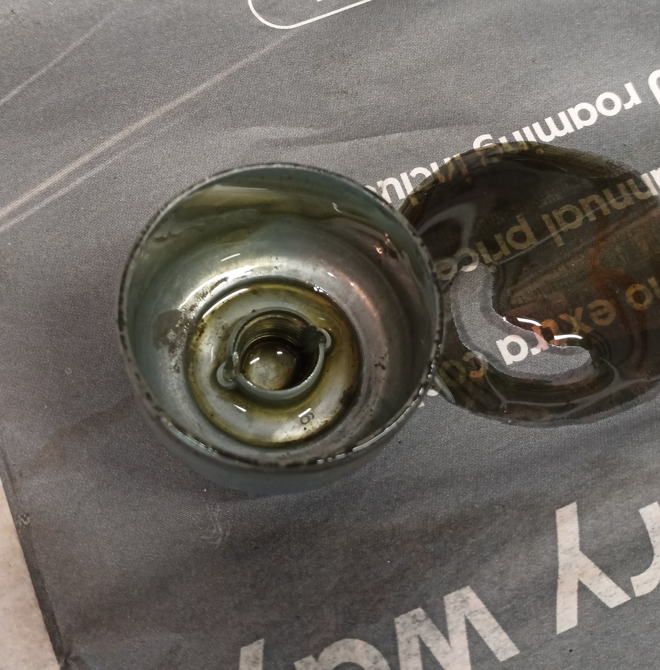

Yay! Carb cleaner and a bit of hot air.... (And some careful scraping with the old dental picks...)
Also stripped the Puch carb down, it still had clean oil in the bowl!

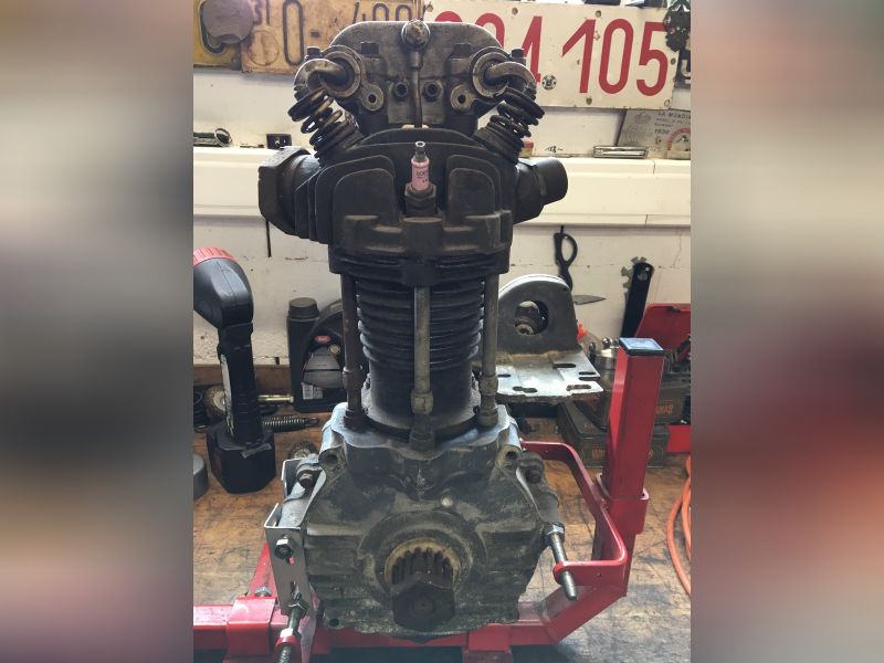

I was wiping some oil off the top of the crankcase when I discovered something that terrifies me...
That bolt, the one between the push-rod tubes, is loose, and it won't go tight.
It just revolves.
Now - I may be wrong.... but, to me, that indicates that there's a friggin NUT on the other side of the case, that is loose, and is hanging on the threads of the bolt.
I may be wrong, and the loose bolt is caused by the threads on either the bolt or the casing being thoroughly knackered.
But - either way, the mininum work needed before I can do anything with the bike is to strip the entire right side of the engine away to check what's going on in the timing box.
I can't take a chance on the probability of a nut dropping into the timing box.
So - The JAPton is unlikely to see tarmac again this side of Easter, simply because I know that I've never done any of this stuff before and I'll be taking things very slow and thoroughly checking it all, and researching how it all works. Oddly, for all the tinkering I've done over the years, this is the first time I've ever had to actually do the timing on anything.

Just a quick look at some photos online... and I can't figure out what the hole itself is for... it's NOT the location of the 5th stud on a 5-stud engine (J.A.P. engines came in 4 and 5-stud, and most of the components are interchangable). The 5th stud on the 5-stud engine on the plug side : Here's a photo showing an engine with the 5th stud on the same side as the plug - all the timing gear is on the other side.

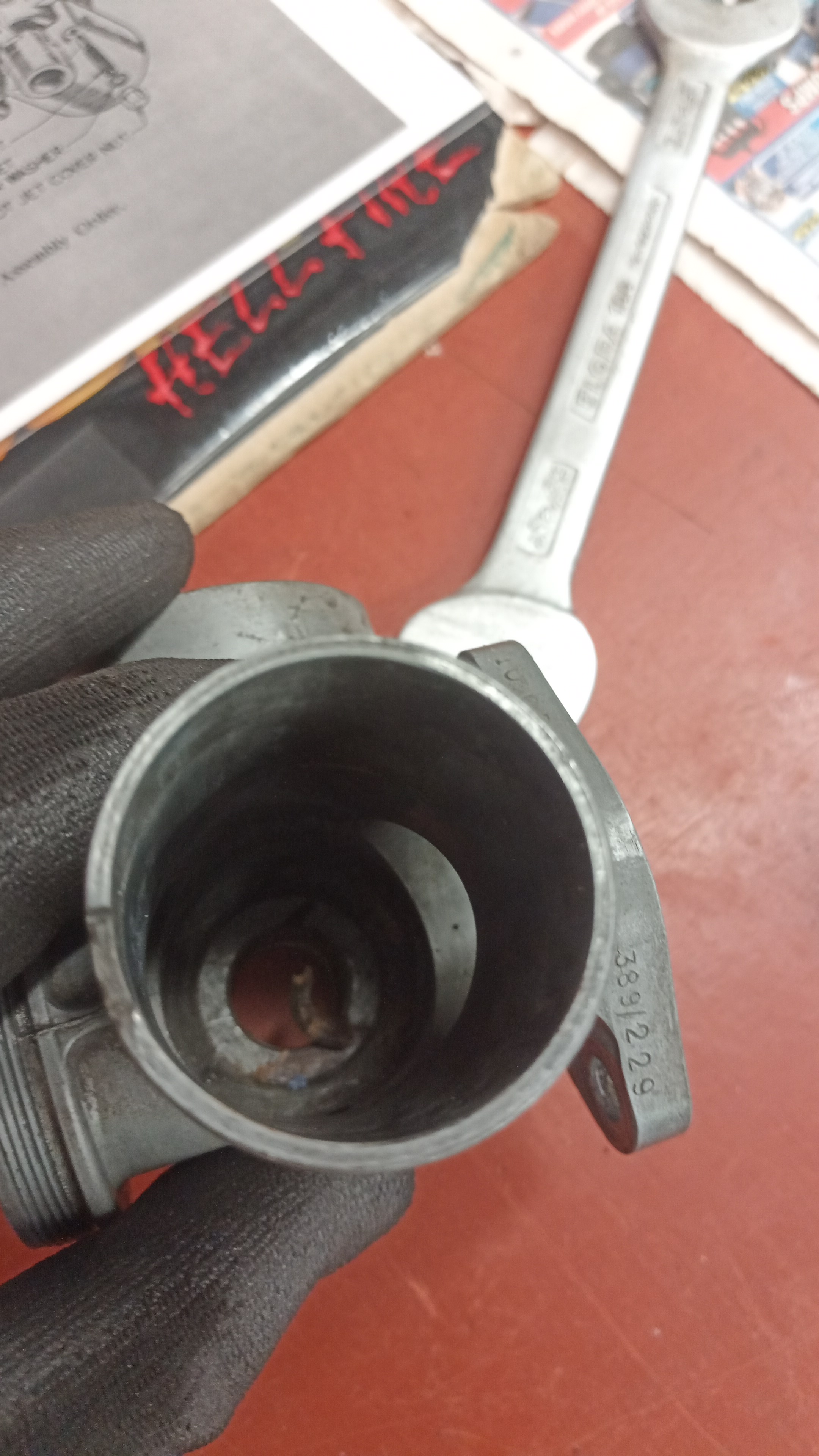

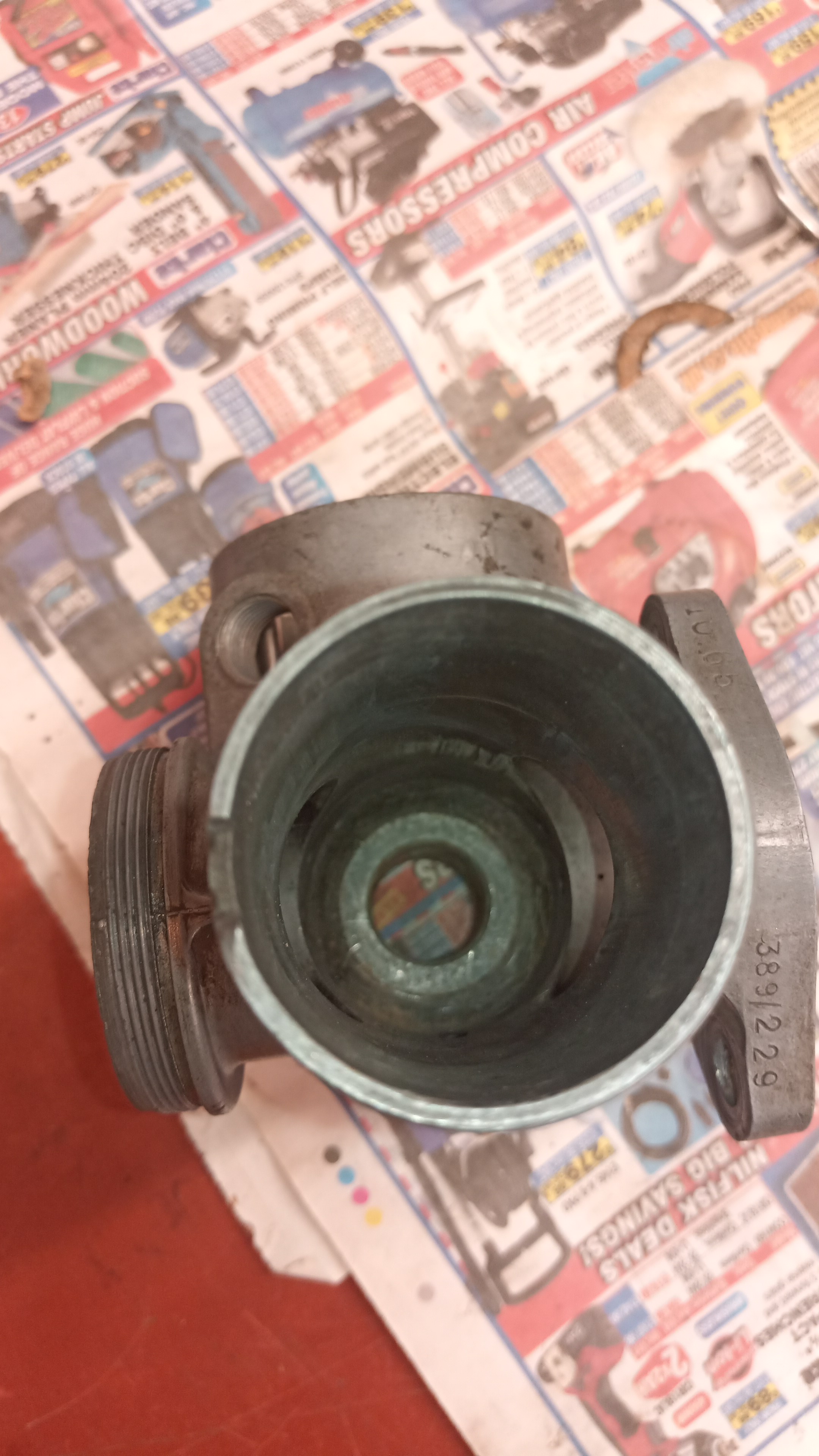

oh yeah - there's one other weird thing happening in the JAPton:
On the Monobloc carb, although I've cleaned it all up, when I use the tickler to push the float down, it "works" - but the fuel doesn't overflow through the ticker - it eventually overflows out of the bellmouth! (or possibly a tiny hole in the inlet manifold).
The tickler is simply a metal tube, closed at the top end, but with a small hole on the side about a mm down from the top. The bottom of the tube is squared off, but not closed up, and it's completely clean - it's not blocked in anyway.
The top of the float - which the tickler pushes down on, is rounded, so there's no "flat plane" on which the end of the tickler could possibly "seal".
So I'm highly confused as to why the fuel isn't exiting out of the tickler!

If its the same as the one below, then it looks like the tickler pushes the float down but the fuel would likely flow out of number 24 as its lower and that would be where you're thinking its coming from? Possibly indicating the needle valve (seal) is worn?
- Rockburner
- Posts: 6033
- Has thanked: 10963 times
- Been thanked: 3995 times
Re: New Project(s)
24 is the feed IN.....Taipan wrote: Tue Aug 08, 2023 12:54 pm If its the same as the one below, then it looks like the tickler pushes the float down but the fuel would likely flow out of number 24 as its lower and that would be where you're thinking its coming from? Possibly indicating the needle valve (seal) is worn?
Oh - and the float, float- needle and pretty much everything else replaceable is new.
but - I am now wondering if an internal seal is not in place correctly...

I'm not familiar with these carbs, but do have memories of stinking fingers from petrol coming out of ticklers. So it seems odd that its leaking out somewhere before that happens, but as you've just replaced something lower down than the tickler, I guess the golden rule of going back to where you last worked applies then....Rockburner wrote: Tue Aug 08, 2023 1:00 pm24 is the feed IN.....Taipan wrote: Tue Aug 08, 2023 12:54 pm If its the same as the one below, then it looks like the tickler pushes the float down but the fuel would likely flow out of number 24 as its lower and that would be where you're thinking its coming from? Possibly indicating the needle valve (seal) is worn?
