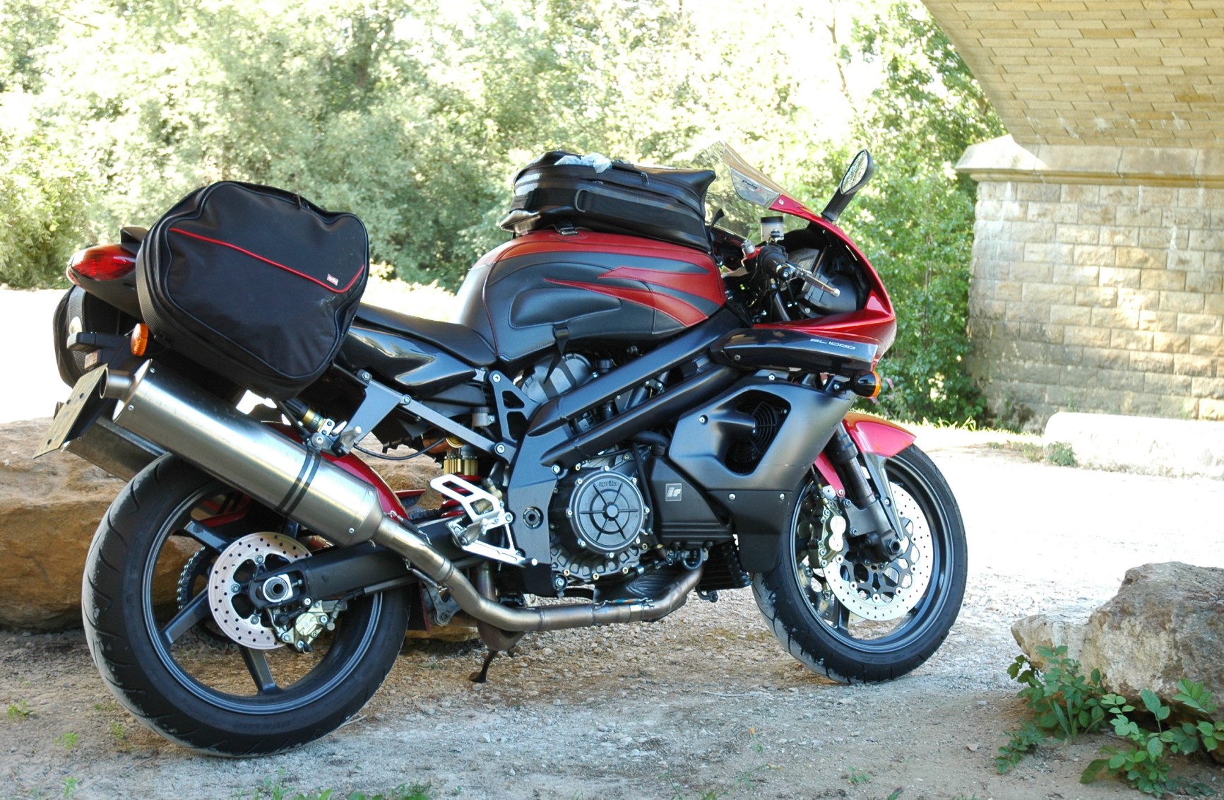

And just to give an idea of the bar position as the Falco left the factory, this pic from the same French trip:

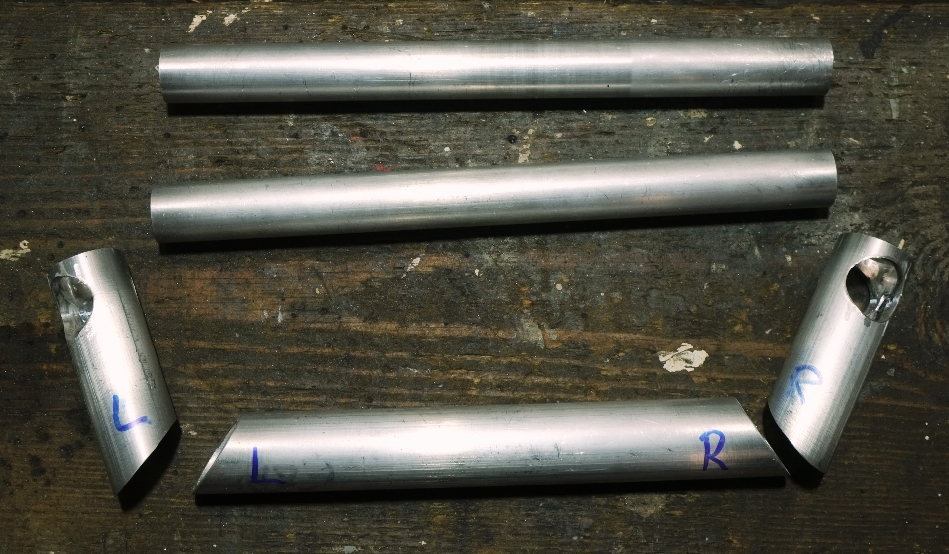

When we came back from France I brought with me the steel 'ace' bars, so I could try and make them work with the OE Falco anti-vibration system. Last week I dug out one of the OE bars as a reference and took that, the 'ace' bars, an M18 x 1.5 tap and one of the complete OE anti-vibe inserts and headed down to my local engineering emporium. One of the guys there jokingly suggested I ought to have a clock card with my name on it, I visit that often...
Paul, the head honcho, had a good look at all the parts, did some measuring up and pronounced that they should be able to make up suitable inserts, get them welded in and then tapped to the correct thread (M18 x 1.5, unsurprisingly) to accept the hollow mounting bolts. So that's a good piece of news to start the week off with.
But as I always like to have a Plan B, I'm also going to order in some aluminium tube in 7/8" and 1 1/8" x 10swg (3.2mm) wall thickness and make up a duplicate set of bars in aluminium. That way I can do an A/B comparison of steel vs. aluminium bars and decide which material suppresses vibration the best. Or not.

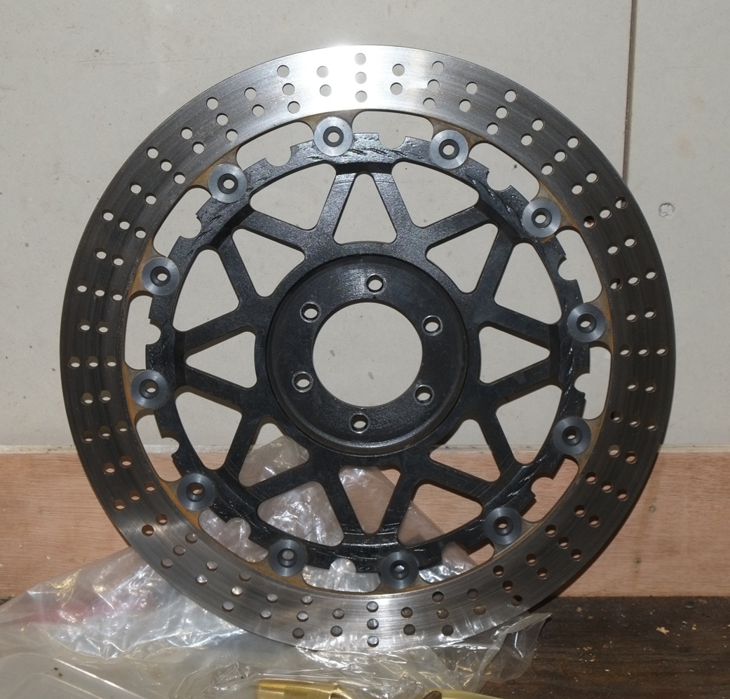

With the Falco bars handed over to a third party, it was now time to give the old VFR a good coat of looking at. So up on the Skylift it went and out came the front wheel and the forks. As soon as the front wheel touched the floor, it became very apparent where the clonking noise was coming from - the discs were making a right old racket. On closer inspection there was very very slight sideways movement between disc and bobbins, but plenty of radial movement ; i.e the bobbins were allowing the disc to float excessively. This is the disc in question:
It's not yer ornery 320mm disc, in fact I've never seen another one like it. It's very definitely a Honda disc, the six M6 mounting points tell you that, but it's ventilated axially and radially and the original carriers were magnesium. It has all the hallmarks of being a kit or racing part; I wouldn't be suprised if it wasn't a RC30 kit part, as it slots into an RC30 front end perfectly. OE Honda RC30 discs were 310mm diameter, but kit parts were 320mm. The carriers you see now are 7075 aluminium replacements/copies as the magnesium items suffered an untimely demise. I'd always assumed they were aluminium, and sent them off to be plated thinking as such. It was only when I received an irate phone call from the production manager of the plating plant telling me my f***ing parts had contaminated a brand new batch of chemicals that the penny dropped. Apparently magnesium reacts quite violently to the plating chemicals they use. Here's a rim shot for all you perverts out there...

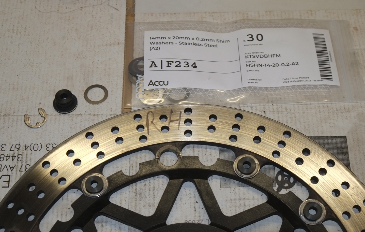

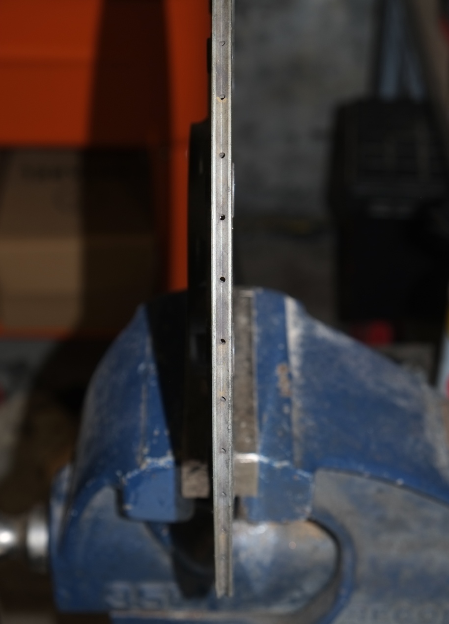

To confirm my suspicions about radial play, I dug out the feeler gauges and started measuring clearance under the bobbin heads. Minimum clearance was more than 0.2mm and maximum not far off 0.3mm. This was in addition to the existing 0.5mm shims/washers that were fitted under the circlips. So I hit google searching for 14mm x 20mm x 0.2mm stainless shim washers and bugger me if I didn't come up with a perfect match on the accu.co.uk website. A few minutes later and 30 (2 x 12 plus a few spares) of the little buggers were winging their way to me.
The Plan is to fit the new 0.2mm shims underneath the existing 0.5mm items, so they face directly to the disc/carrier. I'll also be putting a wipe of silicone sealant on each bobbin to further reduce any extra play. I'll effectively be converting fully floating discs to non-floating discs. Not very rock'n'roll, but if its stops that bloody clonking it will all be worth it. This is scheduled for tomorrow. What is it they say about tomorrow?

Well, tomorrow actually arrived and the two discs have had their end float reduced by means of the 0.2mm shims and their rights to free movement curtailed by application of RTV silicone. There was an early panic when I re-used a tube of silicone that had previously been capped off using cling film, and when I applied force in the shape of a mastic gun it steadfastly refused to budge. I then foolishly poked a screwdriver into the plugged end and released a torrent of silicone everywhere. Cue frantic clean up operations and black silicone all over bench, vice, hands and God knows what else. That stuff really does stick like sh1t to a blanket...
Anyway all 24 bobbins have been done and the two discs (and more importantly the silicone) are currently sat on a living room radiator and quietly curing away. Prior to this work the discs rattled like a bag of spanners when shaken. Now they're as quiet as a church mouse...

There's still some end float, just not the excessive amount there was previously. If there are any problems they should become immediately apparent on the first test ride.
