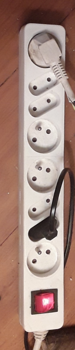

You are pushing your luck wiring a 2 wire socket anyway. Even in France they have 3 wire sockers, live, neutral and earth. In old money red should be live, black should be neutral, and the earth is green or bare. New work ɓrown is live, blue is neutral and earth is yellow/green striped.
Are you sure the the old 'blue' really is blue? If it is, get thee to a sparky before you do anything else.

Cousin Jack wrote: Sat Jun 17, 2023 2:26 pm You are pushing your luck wiring a 2 wire socket anyway. Even in France they have 3 wire sockers, live, neutral and earth. In old money red should be live, black should be neutral, and the earth is green or bare. New work ɓrown is live, blue is neutral and earth is yellow/green striped.

Pirahna wrote: Sat Jun 17, 2023 4:14 pm It's all different in foreign parts. I have to get an electrician to do my stuff, all the wires are the same colour.
I never trust colours anyway, most sparkies on building sites are cowboys. After the 3rd switched neutral I found (the hard way!) I test all of them with a meter.
Even with old wiring, blue was/is neutral
Probably old one is red +, black/ earth
New one will be brown +, blue neutral and green/ yellow earth.
You should have rcd in the fuse box, so if you wire it wrong it'll go pop anyhoo!

It also sounds like you have bought a lighting extension rather than a proper 3 wire socket extension.

Demannu wrote: Sat Jun 17, 2023 9:01 pm It also sounds like you have bought a lighting extension rather than a proper 3 wire socket extension.
The socket is a proper three wire jobbie. But it seems I bought lighting wire to connect the two sockets, so need to rectify that before I ask the sparky to come and look!! :angelic-green: :angelic-green: :angelic-green:
