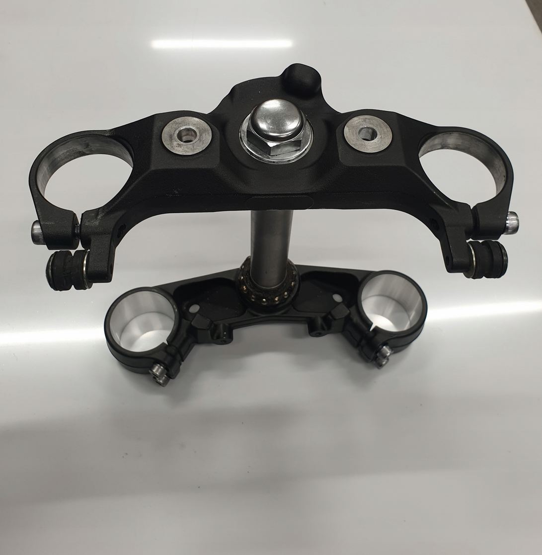

Courtesy of Polish ebay, an MT09 top and bottom yoke, no risers.
MT-09 SP top bottom yoke no risers.JPG (82.35 KiB) Viewed 577 times
What the above discussion has made me think of, is that I would do well to clean up the underside of the yoke where milling has taken place and smoothly radius all sharp edges and stress risers (as Screwd pointed out earlier).

mangocrazy wrote: Sun Apr 09, 2023 11:24 am Courtesy of Polish ebay, an MT09 top and bottom yoke, no risers.
The left hole on that seems to show a sleeve pressed in. Or idk, but seems like there's a raised lip there.
Hard to tell, but I suspect it's due to the way the risers have been machined. The base of the riser has a narrow ring machined around where the stud enters that's about 2mm deep and wide, which would correspond to the ring you see on the LH hole. I don't believe there is any steel insert in that yoke.

I'm pretty sure there is no steel insert in the MT09 yoke, but I agree the idea has merit, for all the reasons you give. I'll ask my local machine shop if they can do that. What part of the Aprilia top yoke would you fill in with weld? And wouldn't there be a real danger of heat distortion through the welding process? There could also be problems with welding to cast ali - the welders I know can stick pretty much anything to anything else, but they do grumble when faced with cast ali...

Demannu wrote: Sun Apr 09, 2023 8:47 am The Yamaha yoke has turrets where the risers bolt through, yours is flat-ish.
All I know is with risers half that length, several people had some serious squeaky bum moments.
But the depth of the area where the risers clamp is the same - the length of the riser stud guarantees that.
Do you have a link to the top yoke that failed with lower risers? Was it an FZ or an R1 yoke? Be very interested to see any pics of it.
