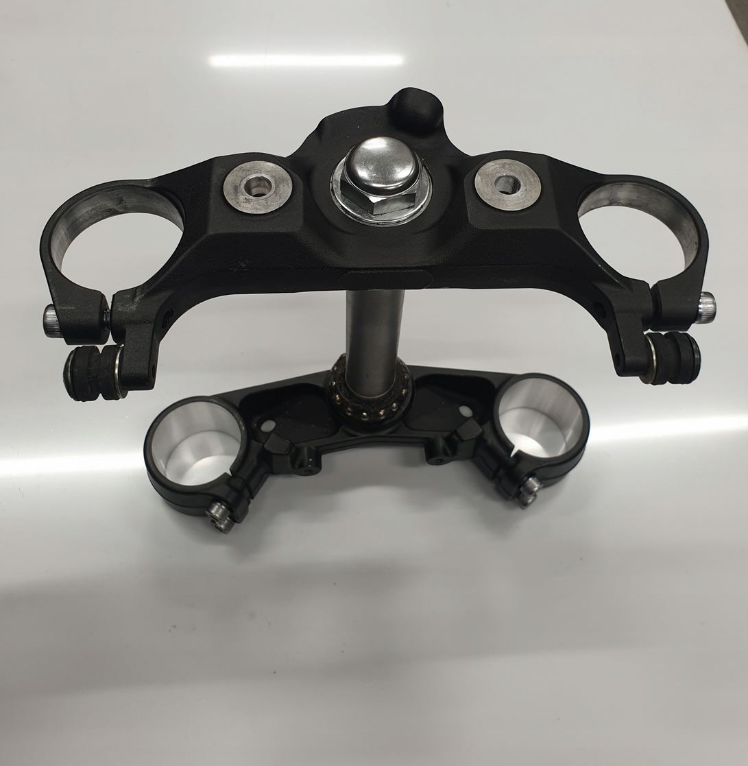

Couldn't find a picture of the MT09 top yoke, here's an MT07 for reference.
The steel sleeve and rubber insert move any stress away from the point of maximum leverage, to the edge of a wide washer which bears on the outer ring of the mounting. The design is effectively flanged out to a much wider area.

This is the top yoke off an MT-09 SP, underside view and top view. No steel sleeve or rubber mounting. That was probably done on the MT07 to damp out vibration through the bars.
MT-09 SP top yoke top front.JPG (197.41 KiB) Viewed 314 times
MT-09 SP top yoke underside.JPG (218.02 KiB) Viewed 314 times
For comparison, this is the underside of my top yoke:

I have seen those and I can't tell what's under that nut.

Courtesy of Polish ebay, an MT09 top and bottom yoke, no risers.
MT-09 SP top bottom yoke no risers.JPG (82.35 KiB) Viewed 301 times
What the above discussion has made me think of, is that I would do well to clean up the underside of the yoke where milling has taken place and smoothly radius all sharp edges and stress risers (as Screwd pointed out earlier).

mangocrazy wrote: Sun Apr 09, 2023 11:24 am Courtesy of Polish ebay, an MT09 top and bottom yoke, no risers.
The left hole on that seems to show a sleeve pressed in. Or idk, but seems like there's a raised lip there.

A_morti wrote: Sun Apr 09, 2023 11:54 am
Hard to tell, but I suspect it's due to the way the risers have been machined. The base of the riser has a narrow ring machined around where the stud enters that's about 2mm deep and wide, which would correspond to the ring you see on the LH hole. I don't believe there is any steel insert in that yoke.

Looks like a steel insert.
:o
Might not be a bad idea to at least fit something like that into your existing solution. Interference fit, press in a steel insert, moves the hardened steel bolt aways from the soft alloy, connects the two "halves", forces are spread over a larger (cylindrical) area.
Given the shape of the yoke though, I'd still be tempted to have that levelling piece built up from weld.

I'm pretty sure there is no steel insert in the MT09 yoke, but I agree the idea has merit, for all the reasons you give. I'll ask my local machine shop if they can do that. What part of the Aprilia top yoke would you fill in with weld? And wouldn't there be a real danger of heat distortion through the welding process? There could also be problems with welding to cast ali - the welders I know can stick pretty much anything to anything else, but they do grumble when faced with cast ali...
