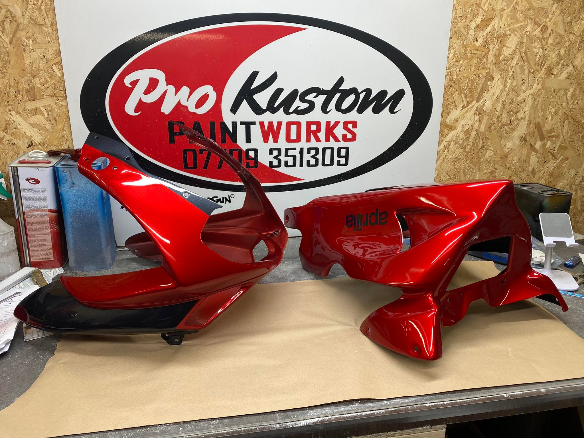

Well, glory be, Hallelujah and pass the Courvoisier...
My Falco top fairing and bellypan are ready for collection.
It's only been 11 months and 14 days since I dropped them off...
The look good. Right colour,yes?

I'll know that in an hour or so. Just going to collect them now...
- mangocrazy
- Posts: 8855
- Has thanked: 2556 times
- Been thanked: 4167 times
Colour looks good, but as with all paints of this type changes massively according to light source. According to Arnie the base coat is pink and the paint is more like ink, and you build the layers up until the colour matches. Sounds like a f'n nightmare...

Indeed you could if it had. But the finish is genuinely mirror-like.

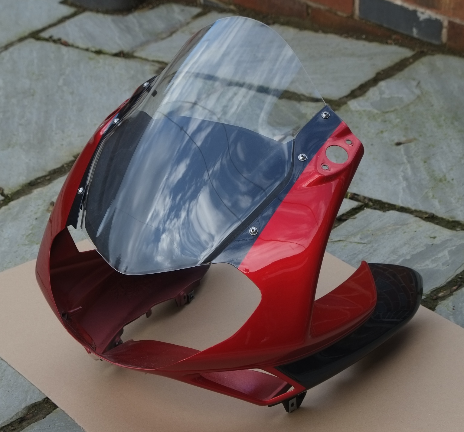

Short progress report, pics to follow. The 'new' top fairing has been fitted to the bike or, more accurately, has heen force-fitted to the bike. Nothing lined up properly and not a single fastener went in without a fight. I can only conclude that the top fairing had suffered earlier crash damage (i.e. earlier than the damage shown in earlier pics) and was badly repaired. When re-fitting the top fairing the two air inlet 'snorkels' have to be fitted to the frame spars before the top fairing can be fitted. Then you have to fasten the snorkels and the fairing to brackets off the main frame as well as to each other. And get the mirror mounts to line up with the main fairing support bracket. You really need a minimum of three hands to do the job and preferably more. Not a single screw went in without pulling, pushing and mauling the various parts. It got so bad that on the last screw I had to enlist Mrs Mango's assistance to fit the screw while I forced all the other bits to line up.
Then when it came to the side fairings, the process was repeated - once again nothing lined up and everything had to be forced into position. It was around this time that I noticed that the fairing around the RH mirror mount had cracked and delaminated, doubtless where an earlier repair had been made. So my bargain crash-damaged fairing wasn't quite the bargain it appeared to be. And lastly, when it came to fit my fancy new belly pan, it quickly became apparent that it would never fit properly due to all the bits it mated to also being out of position. Which was a shame, as for a couple of minutes it was starting to look a bit tasty. So off it came, and back on went the little black plastic oil cooler surround. And as with every other piece, not a single screw went in without a fight.
But at least everything is buttoned up now. How long it stays that way is anybody's guess.

You've got my sympathy,fitting slightly skewed bodywork can test anyones patience.
Here's hoping that after a few thousand miles you don't get to many stress cracks around the mounting points

Yeah, that's my concern. I'm definitely on the lookout for a decent top fairing, unfortunately they're like rocking horse sh1t.Bustaspoke wrote: Sun Feb 26, 2023 7:34 pm You've got my sympathy,fitting slightly skewed bodywork can test anyones patience.

The reason I mentioned the stress cracks is because it happened to me on my old FZ750,I got the fairing to mount to the ever so slightly tweaked upper fairing mounting bracket with a little bit of persuasion & thought I'd got away with it.A few thousand miles later & stress cracks appeared in the paint around the mounting pointsmangocrazy wrote: Sun Feb 26, 2023 7:41 pmYeah, that's my concern. I'm definitely on the lookout for a decent top fairing, unfortunately they're like rocking horse sh1t.Bustaspoke wrote: Sun Feb 26, 2023 7:34 pm You've got my sympathy,fitting slightly skewed bodywork can test anyones patience.

Yes, fully understand. That's already happened on mine...Bustaspoke wrote: Sun Feb 26, 2023 8:13 pmThe reason I mentioned the stress cracks is because it happened to me on my old FZ750,I got the fairing to mount to the ever so slightly tweaked upper fairing mounting bracket with a little bit of persuasion & thought I'd got away with it.A few thousand miles later & stress cracks appeared in the paint around the mounting pointsmangocrazy wrote: Sun Feb 26, 2023 7:41 pmYeah, that's my concern. I'm definitely on the lookout for a decent top fairing, unfortunately they're like rocking horse sh1t.Bustaspoke wrote: Sun Feb 26, 2023 7:34 pm You've got my sympathy,fitting slightly skewed bodywork can test anyones patience.

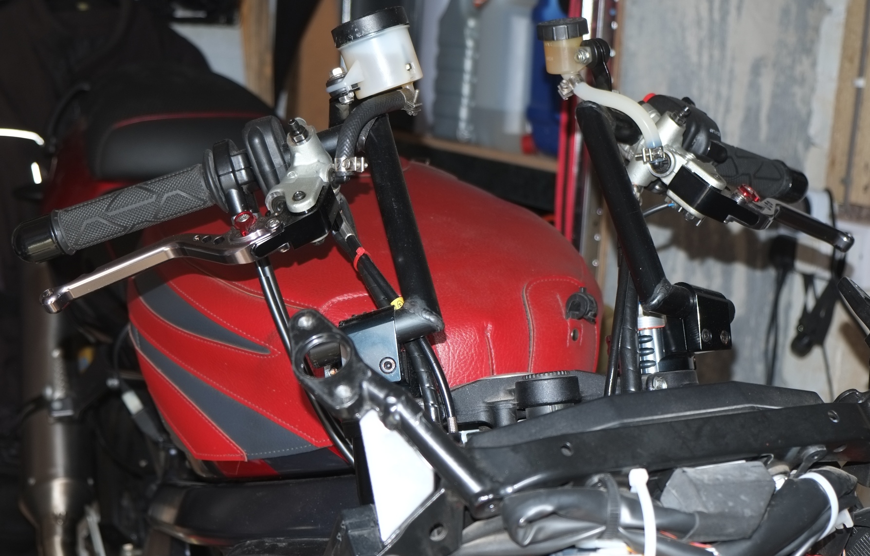

In the last 2-3 weeks I've managed to acquire a straight but garishly painted top fairing. This is good as I don't feel so bad about hacking rare plastics about - someones already made it look shite. No photos of that as it's already gone off to a paint man (a different one...) to make it look pretty. I've also been having some serious thoughts about those bars I had fabricated. Photo of unloved and unlovely bars below:
I'm pretty sure that those bars will do what I want, riding position-wise, but I'm not sure I could live with them on an aesthetic basis. So I've been investigating a Plan B. This was triggered when I dropped into CMC in Clay Cross to have a quick butchers at (and a sit down on) an MT-09 SP. The answer was right in front of me - a pair of much more aesthetically pleasing bar risers. So by the power of eBay I now have a spare Falco top yoke and a pair of MT-09 SP bar risers:
I will need to get a pair of aluminium wedges machined to fix to the top yoke so the risers have a flat base to sit on, but I have a local machine shop for that. And in case anyone is interested, this is the cut down top fairing and screen that took nearly a year to paint (and fits about as well as David Byrne's Big Suit.) Paintwork is lovely, shame it doesn't fit correctly.

Yeah, I know what you mean about those bars. I'm a fan of function over form but...
Look forward to the next iteration.
