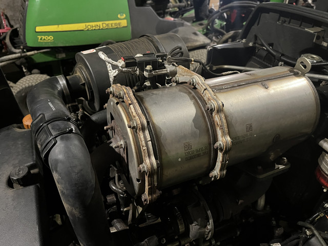

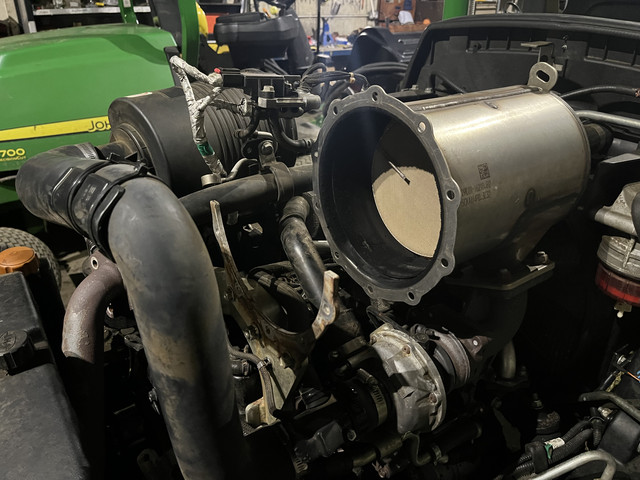

This one is what fucks me off with regards to the manufacturers and dealers, especially John Deere. I’m also a little annoyed at the customer for leaving it so long but it is what it is I suppose, I shouldn’t get too emotionally involved.
Their rough mower which is a John Deere 9009a was asking for forced regens to be performed more frequently until the point where it wouldn’t allow a forced regen, it would ask but not let them perform it. They then called me and sure enough the ECM has locked them out from performing one. I whipped the DPF off just to see if it was in fact excessively blocked and it was, all sensors etc came back as being good and the code it was throwing was pointing towards the dealer only option which is a real pisser.
So going forward, regardless of whether the DPF is now clean or whether it not it was a sensor needing replaced, it will not work until John Deere has came out, plugged in their computer and used the software to sort it and charged them an astronomical price.
The mower itself is being replaced, the decks have far too much required to make them good again, rough cost on parts just for the units is £5,000 and it’s been a money pit for years.

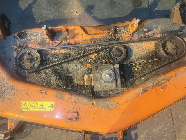

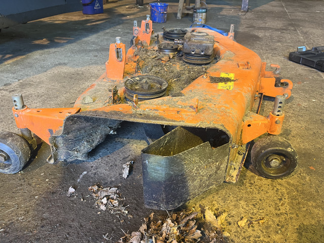

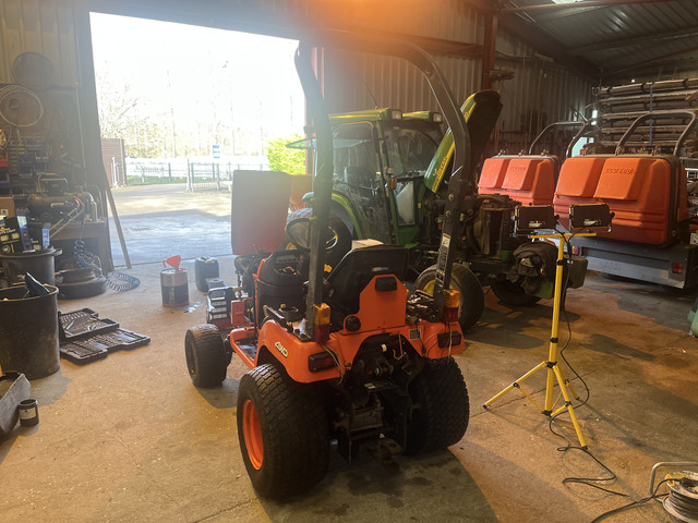

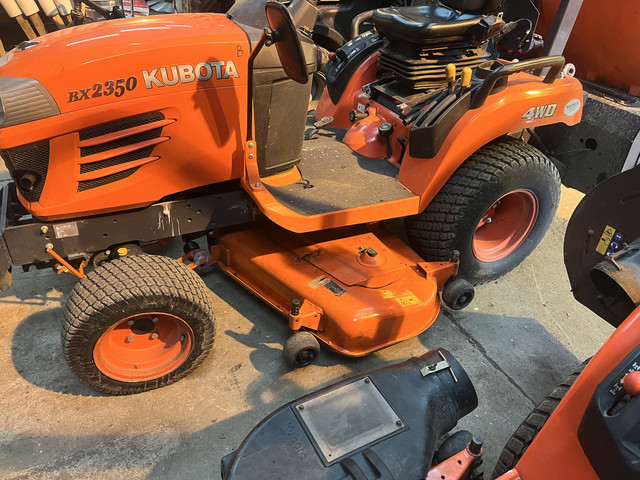

At the start of the year it was time to start servicing the machines. I started with the two lawn tractors that they have, well they have three in total but there is two which are used for cutting the smaller areas.
Two Kubota BX2350’s fitted with RCK54 cutting decks. I gave the mowers themselves a full service, then set about servicing the decks which were a little neglected, one deck would not lower fully to the ground because the mid PTO shaft was seized solid so that was a bit of a chore to remove but I got there in the end up. Once both decks were removed I cleaned them up fully, both belts were extremely worn, cracked and had bits almost worn all the way through, how it hadn’t failed is beyond me, they would have failed soon that’s for sure.
After washing them, I applied rust converter and then sprayed some touch up paint getting the back to how they were originally. New belts fitted, greased, gearbox oil refreshed, mid PTO shaft sorted, back on and ready to go for the upcoming cutting season.
I believe they would not have been able to achieve the correct cutting height on the one with the seized shaft and they did say to me that one was cutting at a different height so I’m certain that will be the reason for it.

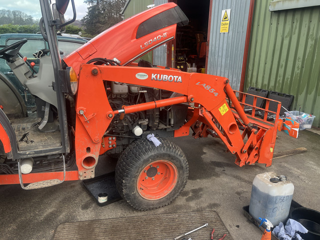

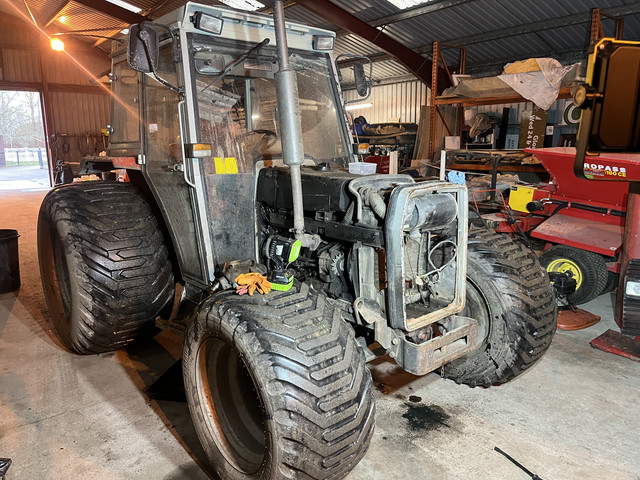

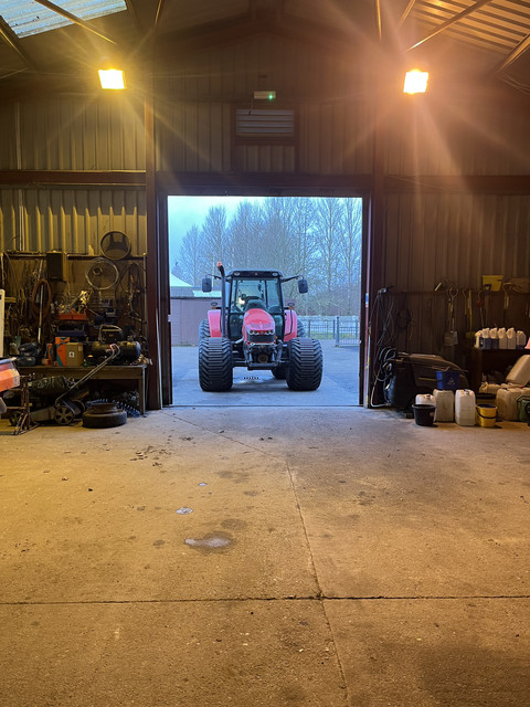

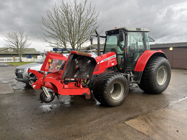

Next up for a full service was the Massey Ferguson 5420, it’s a fair old size which is handy for getting in and around what you need especially the hydraulic filters which are well hidden.
The Jacobsen HR600 was an absolute pain in the arse to service, everything is crammed into such a small space, access is very limited. Full service including blades removed, sharpened and balanced.
Last up was the Kubota 5040, full service on that one, pretty simple job on the Kubota.

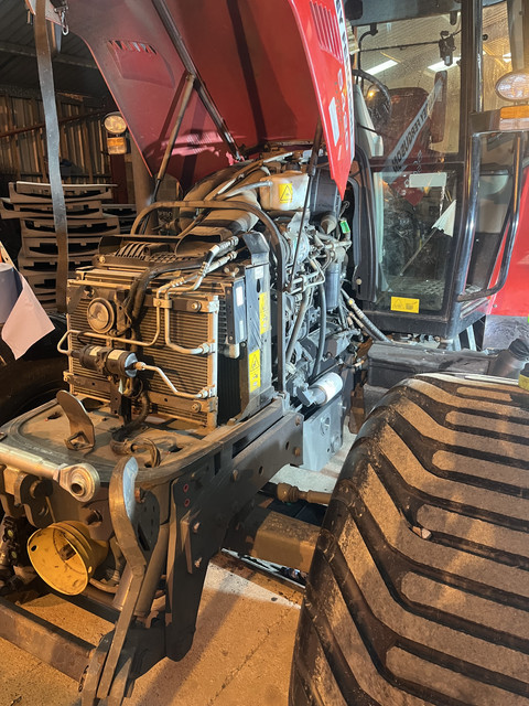

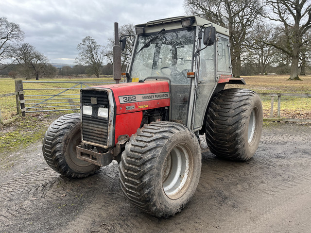

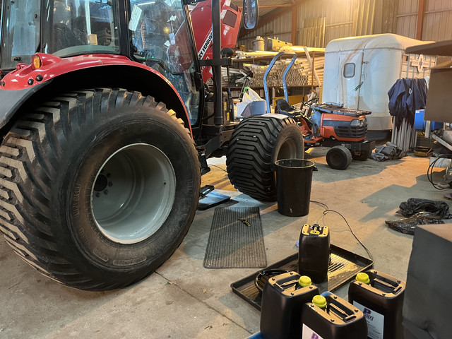

Up next was a full service on this Massey Ferguson 362N, these are the tractors I’m more used to as growing up on the farm this is what we had. This is by far my favourite machine on site.

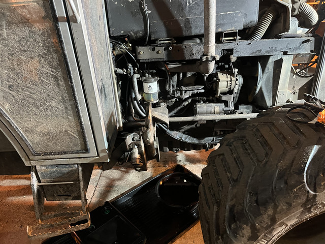

It’s had a radiator leak for a very long time so now that I’m on site they decided to replace it, so I fitted a new radiator along with the service and made a note of a few other issues, these issues we will address this winter coming as we can survive just now with them.

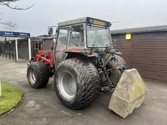

I removed the front loader because I was going to replace the radiator, if I wasn’t doing that I could have left it in place for doing the service as I’d still have been able to access everything albeit it does make a difference but for the radiator it had to come off.

I love the wheels & tyres on the tractors you've been posting recently - they remind me of RC cars I had when I was a kid!

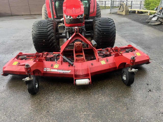

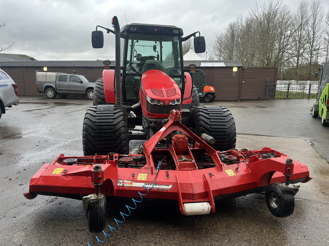

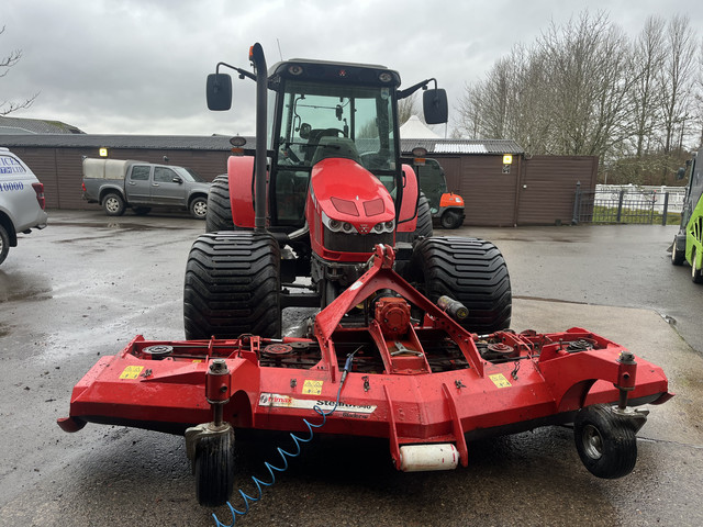

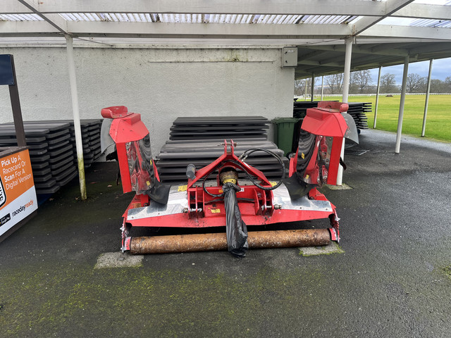

The TriMax Stealth 340 was up next for checking over, this is an out front mower that is used for cutting the course when it’s a little soft.
I removed all blades for sharpening, checked all belts, gearbox oil etc. Everything was spot on, I did tension two of the belts, they didn’t require much, greased everything up. There is one grease line missing, on these you have grease zerks on the outside which then feeds the grease through a grease line to the cutting spindle, and one of them was gone, so when they’ve been greasing it the grease has been just building up on the backside of the zerk doing nothing, hidden by the cover. I have that part delivered now but need to still fit it.
I also stripped the PTO shaft down and greased that up. These get left outside uncovered which I’m not overly pleased about, things like the couplers on the PTO shaft can be a pain in the ass because of this so going forward I’ll keep on top of it.

I’m not entirely sure on the exact numbers but you can adjust it via the tractor itself, front 3 point linkage allowing you to adjust float, the benefit of this is being able to use it on the 5420 with the very wide turf tyres so when the ground is softer this works better versus the Jacobsen HR600.
- Posts: 15906
- Has thanked: 8036 times
- Been thanked: 5694 times
Re: What I do now………
I suspect Dazzle was thinking F1 front wing style downforcewull wrote: Sun Mar 16, 2025 9:09 amI’m not entirely sure on the exact numbers but you can adjust it via the tractor itself, front 3 point linkage allowing you to adjust float, the benefit of this is being able to use it on the 5420 with the very wide turf tyres so when the ground is softer this works better versus the Jacobsen HR600.
- wull
- Posts: 3297
- Location: Alloa
- Has thanked: 979 times
- Been thanked: 1858 times
Count Steer wrote: Sun Mar 16, 2025 9:40 amI suspect Dazzle was thinking F1 front wing style downforcewull wrote: Sun Mar 16, 2025 9:09 amI’m not entirely sure on the exact numbers but you can adjust it via the tractor itself, front 3 point linkage allowing you to adjust float, the benefit of this is being able to use it on the 5420 with the very wide turf tyres so when the ground is softer this works better versus the Jacobsen HR600.![]()
